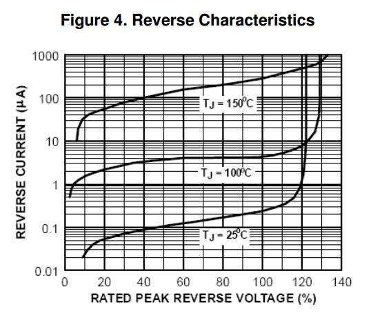

Another possibility which occurred to me was a diode with a PIV between 250V and 500V (i.e. behaving as a very high voltage zener when reverse-biased from a 500V source). The test current might not have been enough to permanently damage the diode when tested at 500V (i.e. it really would just behave as a zener), hence making the phenomenon reversible (and 400V PIV diodes are widely used).

Well, as I've been discussing, if we're talking diodes, that will only work if the test voltage (when applied with the polarity that reverse-biases the diode) does not exceed the reverse breakdown voltage of the diode. With cost-pinching manufacturers probably often using 400V PIV diodes, that may not always been the case (but see ** below).
** However, even with a 400V PIV diode, you might just about get away with 500V testing - I did! With a reverse-biased 1N4004 (400V PIV) (and a series resistor!) it was obviously non-conductive at a 250V test voltage. However, somewhat to my surprise it was still non-conductive with 500V across it. Only if I increased the test voltage to 1000V did it behave 'as expected' - the diode starts conducting, with roughly the 'zener' voltage across it, and the meter indicates a lowish IR. However, looking at the data sheet for the IN4004, the 'typical' reverse breakdown ('zener') voltage is shown as something over 480V (120% x PIV) at room temp - so maybe I had a 'good one', whose reverse breakdown voltage was >500V ...
However, it looks as if one could not be certain that the breakdown voltage was going to be much over 480V, so you could be unlucky!

Of course, although the series resistor will protect any rectifier diodes from permanent damage if they are reverse-biased beyond their breakdown voltage, none of this guarantees that other components (e.g. capacitors) in an 'electronics module' won't be killed by 500V IR testing!
