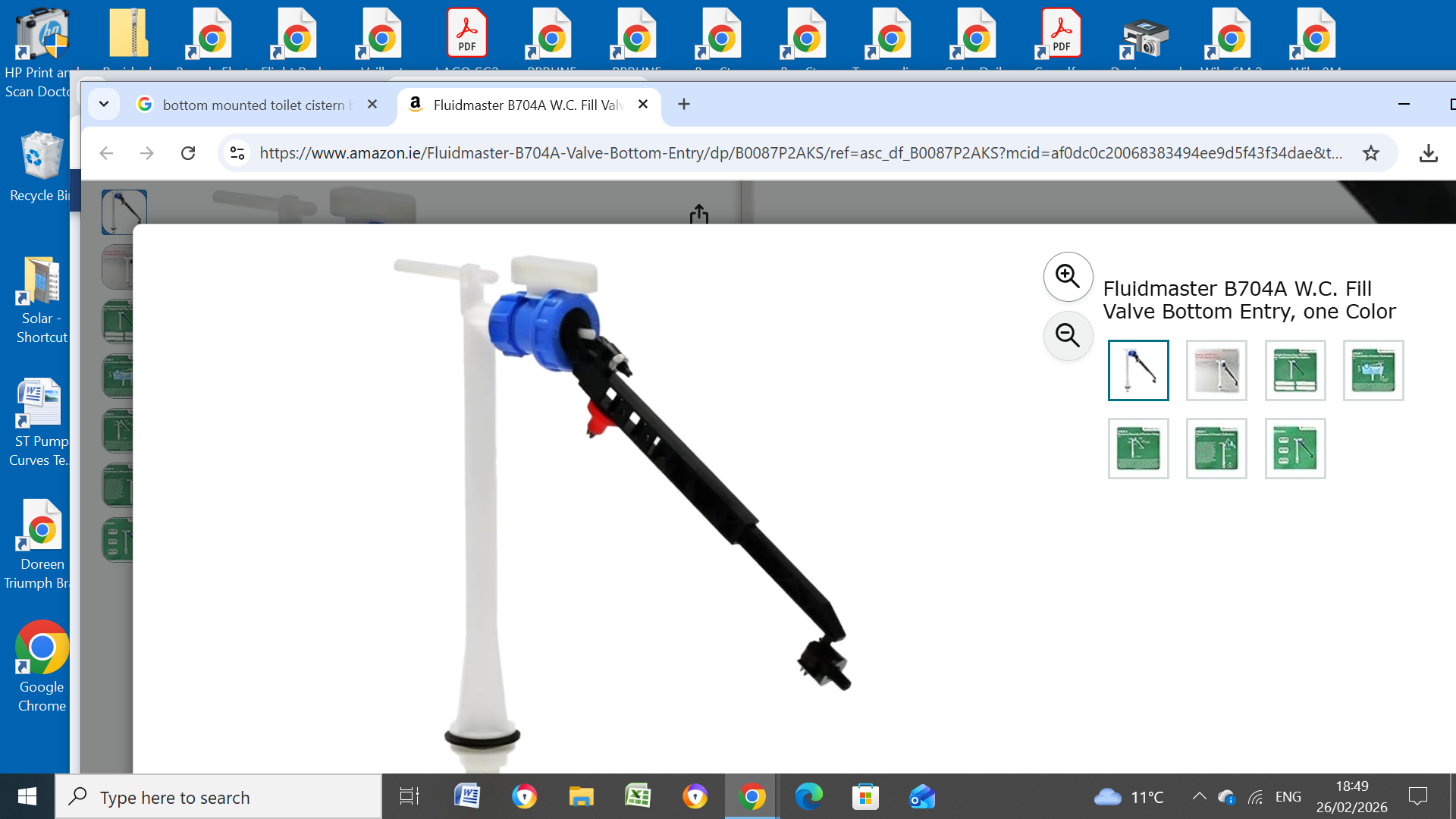

What type of filling, is it the traditional ball cock type or something like this Flomasta type, the latter fill at full throttle and then shut off pretty abruptly which may cause water hammer.
That's a good point, and I'm surprised neither of the plumbers considered it. I think its the latter, will check when I get home.
If it is the Flomasta type, what would be the solution?
Maybe replace it (yourself) with something like this, shouldn't get any water hammer (ballcock type) as it gradually reduces the flowrate as the cistern fills.
Interesting...
The downstairs toilet is a ballcock, no water hammer. So you may have hit the nail on the head there.

I'm thinking change the upstairs toilet to ball and cock as suggested by Johntheo5, realtively cheap to do. See if that solves it.
Its this this type of flush system/toilet...
Would the Fluidmaster be suitable?
Just lift the top off and you should see something like mine, downstairs as well with the Flomasta type filler, if the filling part is offset like mine then should be OK to install the ballcock type, take a snapshot of the inside of the cistern and show it to the plumpers supplier. I installed a 15mm, 1/4 turn ball valve on the supply to mine as its nearest to the water main so the filling is throttled well down.
