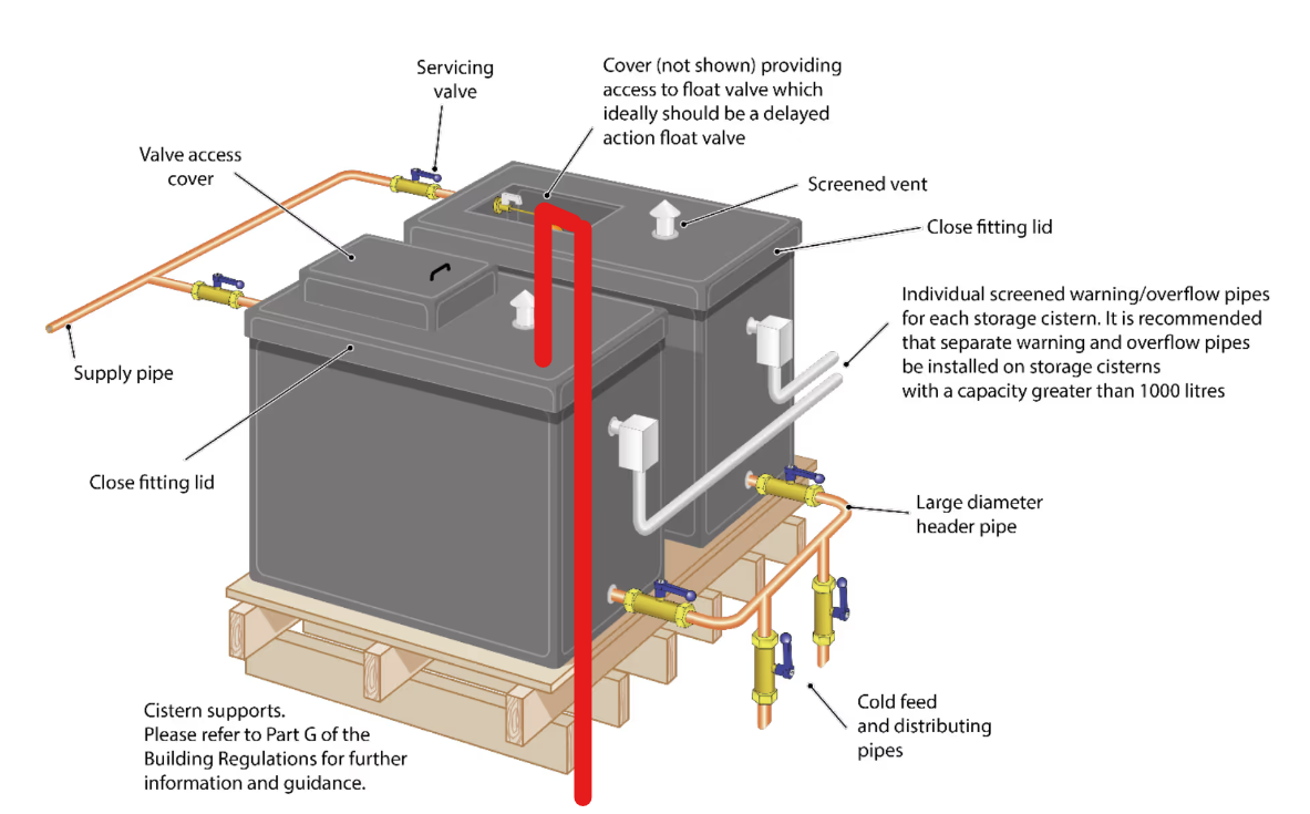

Yes it will be fine, except it won't have the fitting for putting the 22mm vent pipe in through the top.Great diagram. Thanks , that’s really useful. It looks a lot more pro than the setup I am looking at which has an old lead pipe pointing into tank. The plastic bylaw 30 kit that comes with a new tank is that adequate?
Thank you, that's great.Yes it will be fine, except it won't have the fitting for putting the 22mm vent pipe in through the top.
Many a plumber will heat the pipe so it melts a hole through the lid for itself. That's not strictly correct!
The diagram is from the water regs. I have a copy somewhere, this is the only one I could find online.
