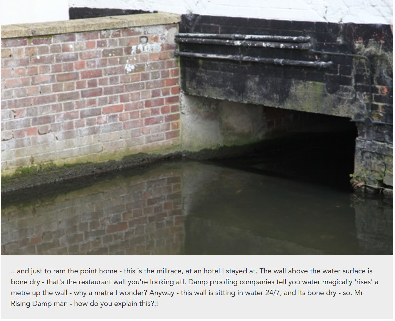

No not really - I've experimented myself and yes a brick in water gets wet so there is an element of truth, and maybe the next brick up the wall also gets wet through absorption, but to imagine that water creeps up a wall several feet jumping across the mortar layers......
Very difficult to argue it exists through capillary action to the extent that some people suggest it does against this photo

It's worth reading the report carried out by Salford Uni a few years ago. It's goes into detail about how moisture gets through the mortar joints after a number of years. They had the finance to carry out a number of surveys on older, damp properties. Rising damp has always been difficult to reproduce in the lab.
The problem with Peter Ward's site for me is that he makes stupid statements, such as ' rising damp was invented in 1962' and the UK is the only country with a rising damp industry'.
Even Jeff Howell, who wrote the book, has had to come round to the fact he was wrong.
