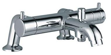

is hot water always on left?
ok thanks. don't have a manual and can't find anything online so hoping its on left.
Set the tap on max hot, if you can blow through the left tail but not the right, then hot should be on the left.
It will matter for your unit in the picture. It will be the hot on the left on those.

I can't blow through right tail (all settings same).
I can just about blow through left tail (all settings same).

It's in the Building Regs.
Approved Doc G, page 28, para 4.6: Where hot and cold taps are provided on a "Sanitary Appliance", the hot tap should be on the left.
"Sanitary appliance" includes a bath, sink, washbasin, shower and bidet.
