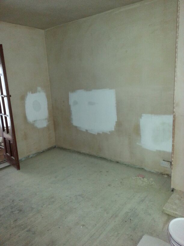

Firstly, i've put this in the plastering forum rather than the decorating forum because this is all reliant on the plastering side of this job - the plastering will affect whether we can decorate or not, rather than the decorating affecting the plaster. That's why i put it here, to pick the plasterers brains - just in case anyone wonders why it didn't go in the decorating forum.
Short of it:
damp wall was boarded out, dot & dabbed. I was warned (by co-workers) of the circle effect & when asking the ones doing the job, i was told the wall wasn't piddle wet through & they were tanking, so i wont have this problem - don't worry.
Let it dry out & i could see every circle. It then faded & returned.
I patch painted to see what it'd look like.
I don't want to waste expensive paint by layering up if there's zero point.
My gut feeling tells me i could put 100 layers on that & those circles would STILL show through.
Not too sure how wallpapering would fare though (i know, let it dry out properly. I'm talking about papering in 12 months time).
Time passed since wall was boarded & skimmed .... 4 weeks.
I've already been warned by another plasterer that the whole thing MAY need to come off & start again, different approach.
Just wondering if i'm wasting my time painting it & will they show through wallpaper?

It doesn't look like any sort of damp to me. What it looks like is when the wall has been hacked back, chunks of brick have been knocked out and filled with mortar that is taking a bit longer to dry due to its depth.

I've been spoken to about the circular dabs that will be used to fix the plasterboard & sure enough - circular sections are showing as you can see.
So i can understand the talk about D&D on a damp wall, but i don't understand why they'd remove random bricks for no good reason.
Chisels and lump hammers are hardly precise. Dot and dab damp circles need condensation from within the house to appear. It's not cold enough for that on those walls unless it backs onto the neighbours chimney breast. Chimney breasts are different, you get funny effects from them.

Then it sounds like the damp is caused by condensing water inside the chimney from either combustion gases or a damp house (Washing drying on rads). No point tanking the bottom. The whole lot needs tanking all the way up.

That said, the independent damp surveyor said the cause was the underfloor water. There's quite a significant amount, enough to require a sump pump that must kick in every few days. The floorboards are slightly curved upwards. He said this was due to the moist air underneath caused by the amount of water down there. The joists were reading high levels too.
Strangely though, i've just thought - the water runs from the rear & collects at the front, yet it's the wall to the left of the chimney breast (rear) which was the worst by far & not the wall to the right (closer to front of house), which was bad enough, but nowhere near AS bad.
On the topic of the wall... what are these splat marks?
As when you paint over it it shows through:
Ok that's just a mist coat of Dulux Trade SuperMatt.
Does it disappear with subsequent coats? Though, it seems to show through quite strongly.
Does it need to get sanded with fine paper first? I don't want to paint it all only to find out i should've [done something first] and then it ends up being patchy or whatever.
