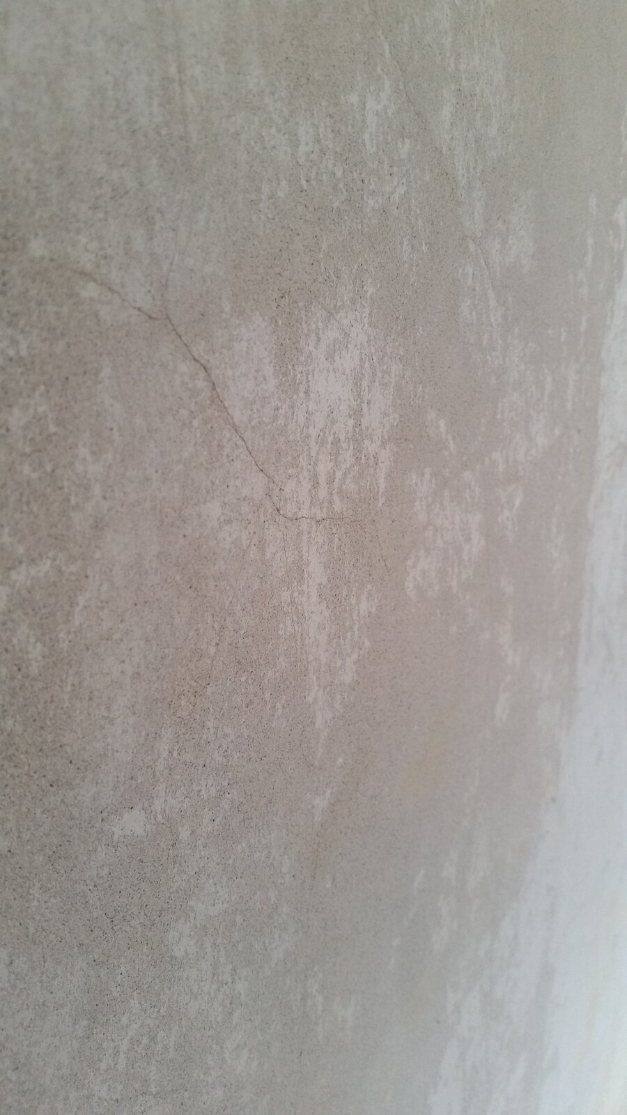

    Is it ok to leave a small, smooth amount of wallpaper glue, seemingly perfectly level with the plaster to the eye and touch before priming with a dedicated primer? I can get it all off in little 3 by 3'' patches with hot, soapy, vinegary, bicarbonate of soda water but it takes a lot of hard scrubbing and I've got a house worth of big walls to go. It would take a long time and maybe wear out my arm at this rate. 20200908_140533.jpg 20200908_140520.jpg

    Are you sure it is glue?
    Not distemper?
    How old is the house?
    You can get paste off by spraying it with warm water to soften it, then scraping of the sludge with a broad metal scraper.
    BTW vinegar and bicarbonate neutralise each other.

    Pretty sure it's not distemper (first I've ever hear of it and just looked it up), I scraped off wallpaper and as much of what I think is glue that I could and now my scraper won't affect what's left as it's very smooth after scrubbing with my solution. I'm hoping I've got rid of enough with my scrubbing, that's been quite hard already, to not have to really put my back into it to get it to completely bare plaster. It seems like what's left might even work some way towards being a primer. Using a better solution might help too, thanks a lot for pointing out my mistake with vinegar and bicarb.

    The whiter patches feel smoother than the grey plaster but not glossy as some describe wallpaper glue sometimes being after scraping on here.

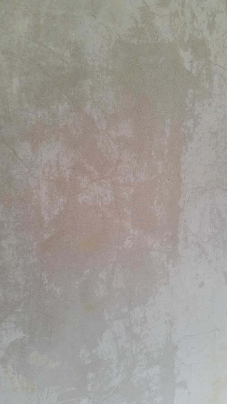

    20200908_145233.jpg Here's a photo of some of the remaining wallpaper and what can be seen of what I've been scraping and scrubbing off.

    have you got a pump-up plant-mister?
    it looks like the paper is painted woodchip, which is horrible.

    mist it repeatedly with warm water and a tiny spot of WUL. It will slowly soak through.

    Then just wipe off with a rag?

    scrape it off with your broad metal scraper.

    Ahh that's loads easier, thanks very much.
