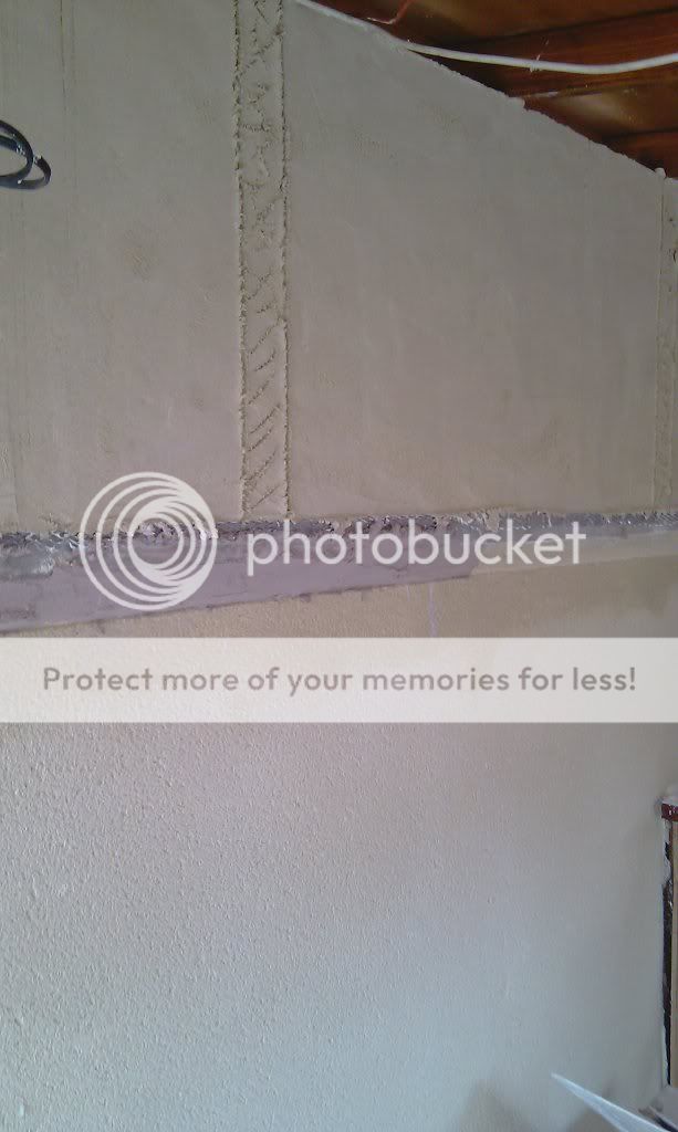

Yes you can, we render both the pebbledashed prefab units, and new ones that are manufactured without the pebbledash finish to allow for a decorative render, we do this direct for Hansons as well as to private clients. If you are not used to modern rendering systems don't attempt it your self , as it could be quite costly.
Prior to application with the joints fully meshed
Finished hand cut render job

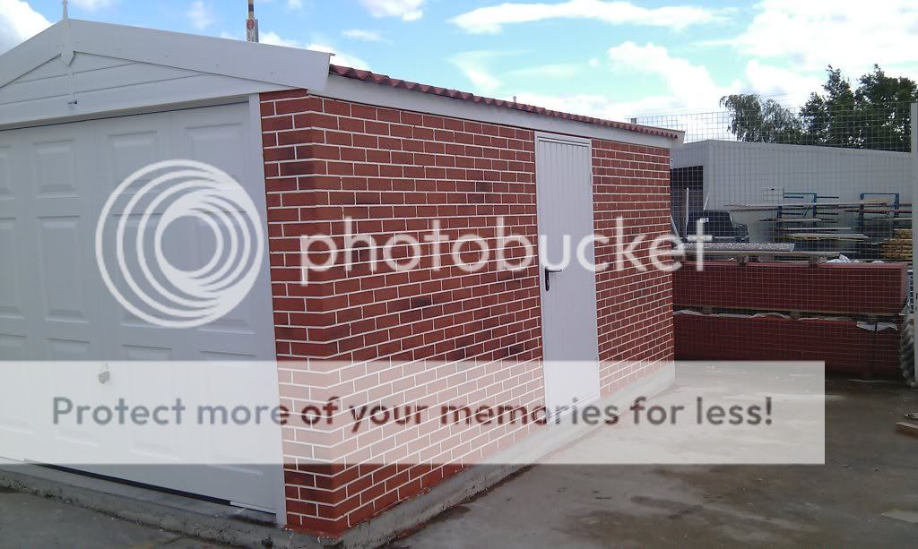

One we did this week, this was matched to the brickwork on the owners property
Before
After

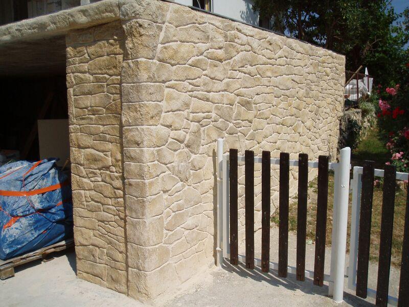

yep we do the stone, hand cut and printed, also false beam work
check out the false oak beams
Before
After
