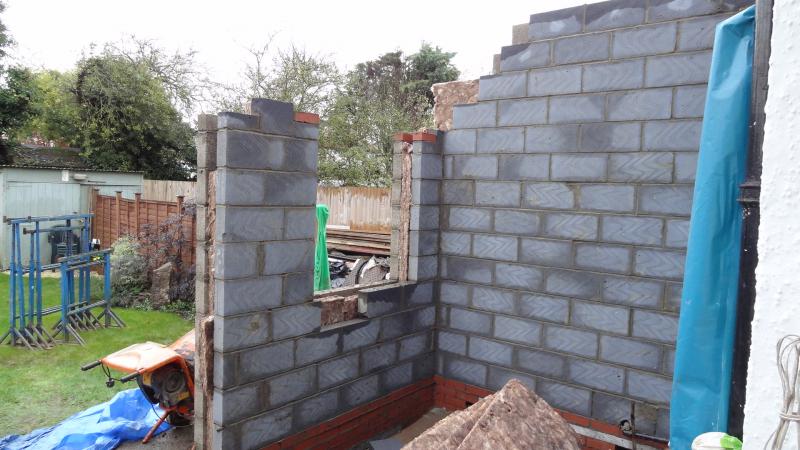

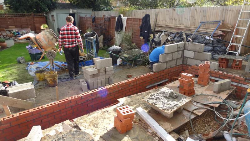

Well the bricklayers started on thursday. Five of them for a small 3m out extension. Had to leave half way through the day and was amazed when I came home at 7 and they were still working. Prob 3/4 done in one day. All in all, it looks very good apart from a few minor things I needed to point out. Stupidly, in the alley, the air bricks are just below ground level, but that will be corrected. They haven't been back yet, but will come tomorrow to finish. I've found two problem that are grinding me and I could do with some advice.
Down the side of the house, they have not extended in a perfectly straight line from the existing wall.. If they'd have used string properly from the front of the house and beyond, it would have been obvious. Basically, over the 3m it is about 2-3 inches inside the line. This bugs me, as we will have a kitchen counter that will extend from the new wall through the old, so a difference in line, may cause issues. Saying this the old and new wall thickiness is different. They have finished this wall, so asking them to start again from foundation seems not to be worth it.
The second thing I have just noticed is the cavity thickness. I specified 90mm with 85mm dritherm. They have left anything from 100 - 110 mm cavity and in some places 120mm.

A job of that size should only need a couple of guys on it, and they would be done inside a week, easily.

Certainly more than 30mm out over the three metres. More like 90 to 100. Simply, when they started on the furthest corner in question, it wasnt in the right place. Their work from there up is fine.
I would expect walls to be built square and cavities to be even .... ie walls plumb. It really is not difficult, and accurate setting out is fundamental
It does not sound that good to me. Can you put a few photos on so I can give you a better opinion. Pulling the line from existing is a pretty basic thing.

Thanks Stuart. To be honest, the more I.ve been thinking about it, the more I feel it should be redone. Just that one wall. Will put it forward to him in the morning.

If bricklayers had profiles to work to and building is running out of parallel or out of square then this is down to you, however bricklayers should have checked it first and if not correct then brought it to your attention before starting. If no profiles were provided, but it was made clear to bricklayers that responsibility for setting out was down to them, then it was their fault, plus lack of supervision on your part. Proving it was their fault would be another story. Sub contract bricklayers are there to lay brick not contract management. Tolerance for plumb in vertical wall 2.5 high is 8mm. Any thing over this is not acceptable..
In passing, with 80mm dritherm, you will not achieve current u values unless the K value of external blocks are 0.15W/mK or lower and K value of internal blocks are 0.11W/m2K. If corner is that much out as you say, you will have fun and games fitting units, work tops and roof verges. If you want unit and work top under window, then you need 1.050 deep window and not 1200.
Brick and block as a whole looks reasonable, but then again the time they are taking, so it should.

Thanks for the advice, just what I needed. At one stage I went back outside at 21:30 last night to double check measurements and it was about 55mm out of line over 3m. My concern wasn't on the outside, as this can be mended with thicker render, the concern is the knock on effect inside with units, counters and flooring lines looking odd.
Similarly, I thought, is it worth makinf a fuss of 15-20mm difference in cavity width to what I specified.
Suprisingly, brickie arrived this morning, I raised the issues, to which he looked a bit embarrassed about and couldn't dispute. He then had a go at his labour in local language and agreed to basically start again. He will rebuild the brick work and blocks down the alley where the line is not straight, and on the front wall he is taking the blocks down and rebuilding with correct cavity.
Feel much better about it now. Cavity wasn't such a concern, but the wall not being in line was..
