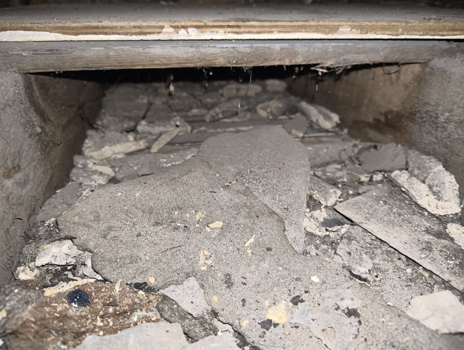

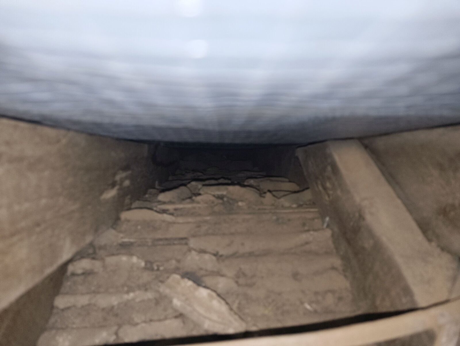

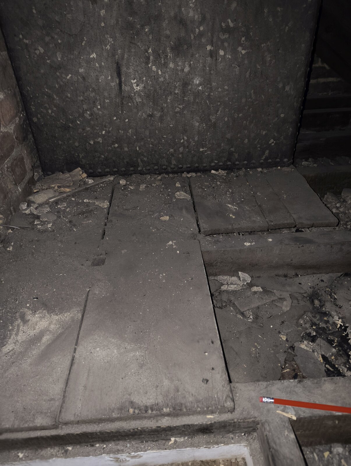

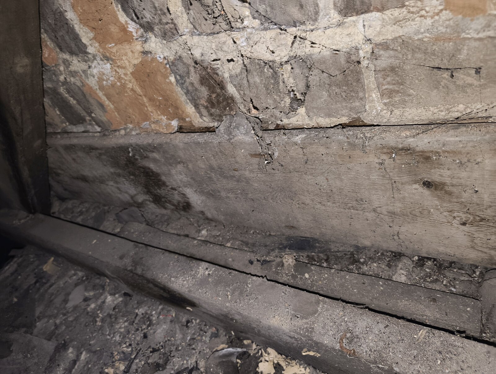

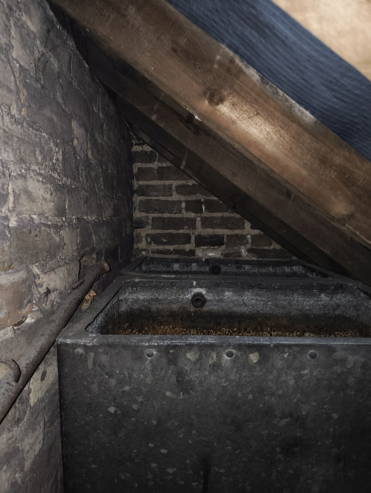

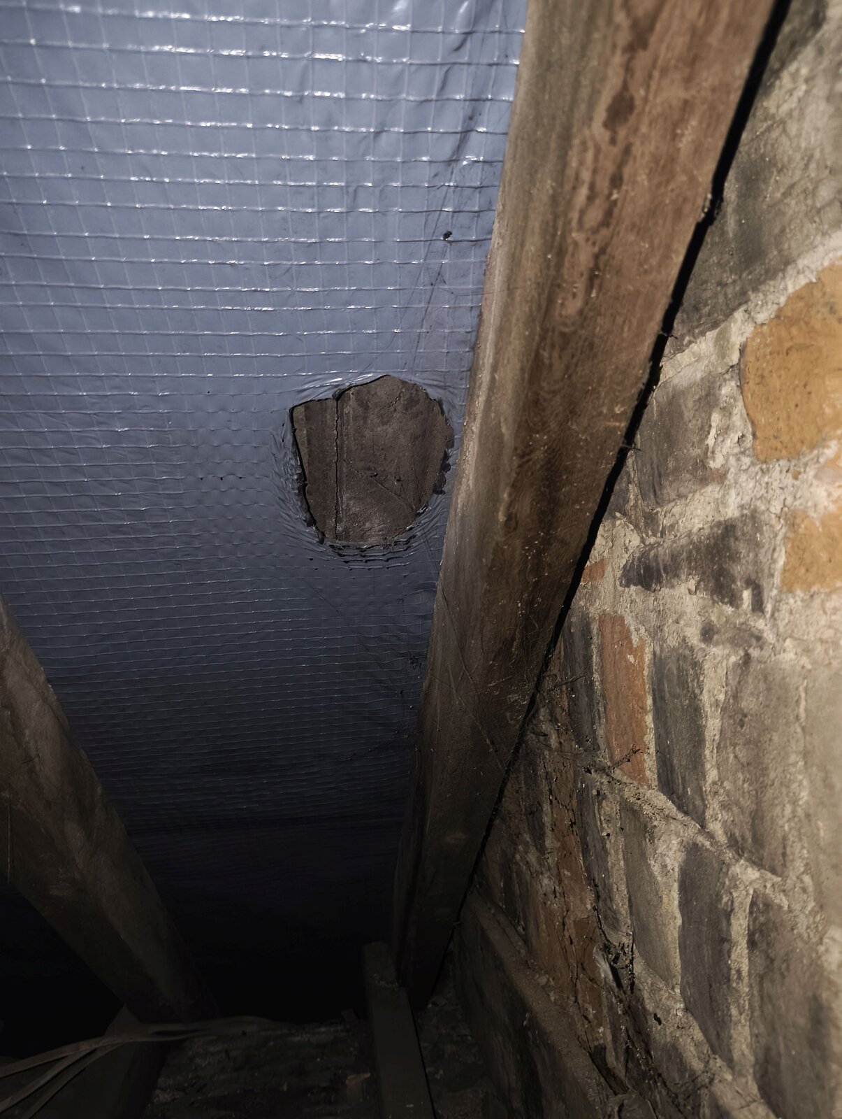

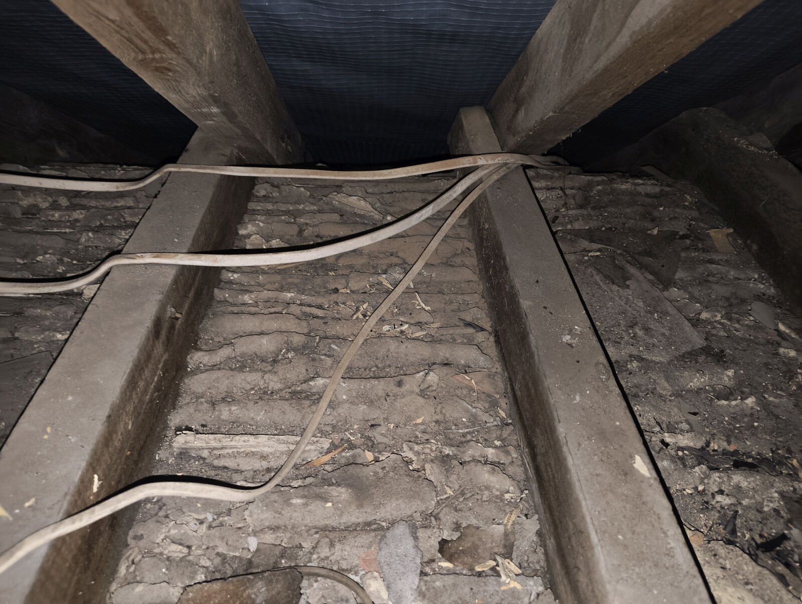

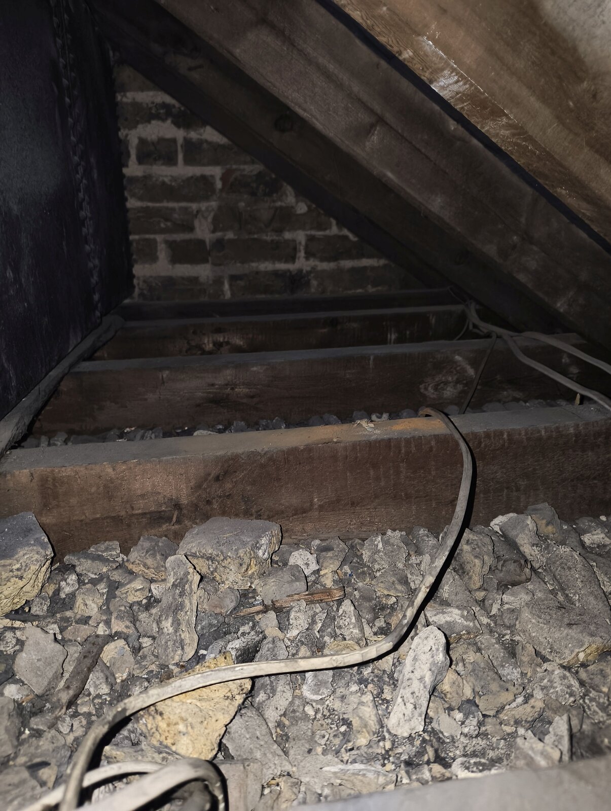

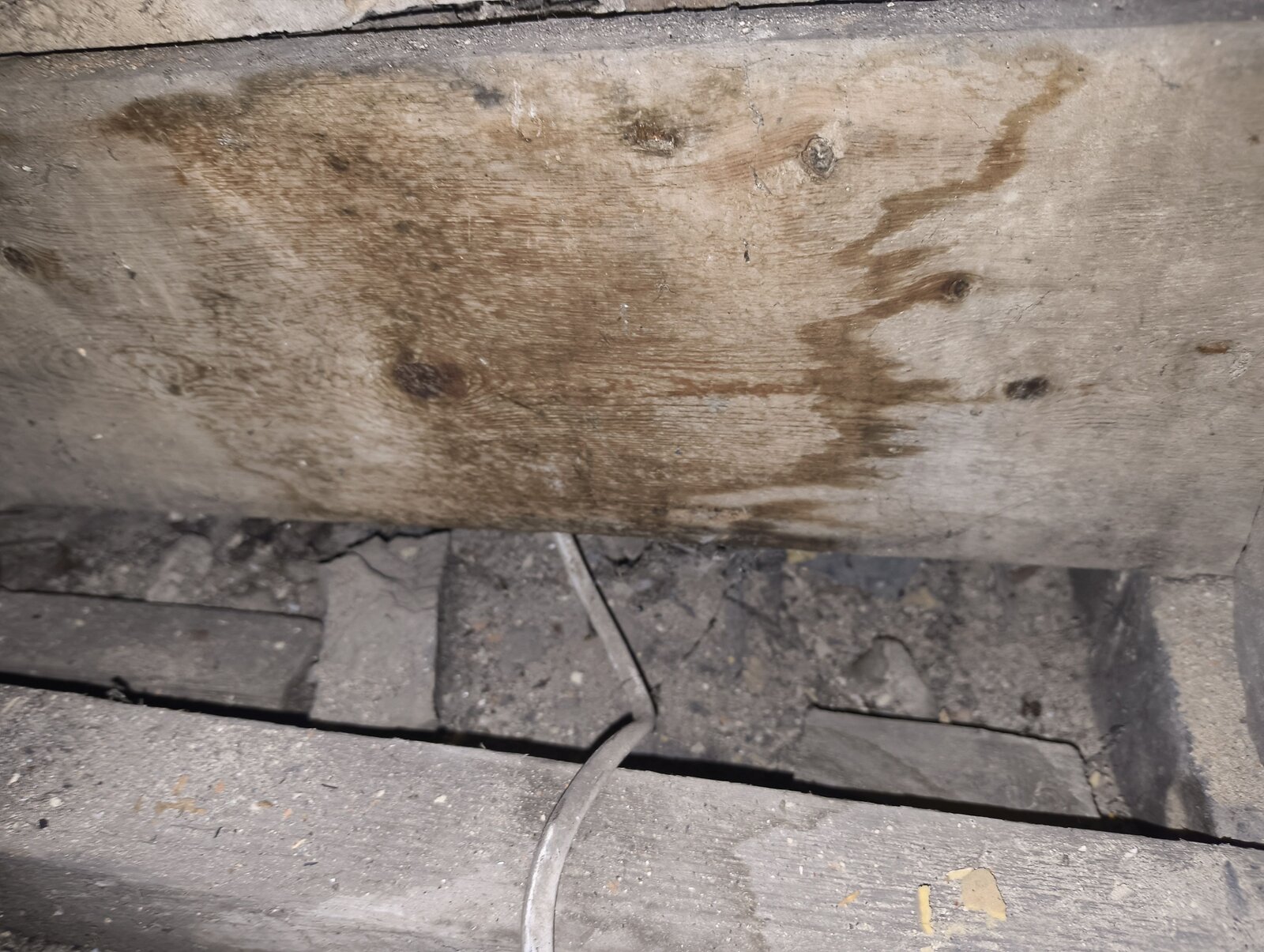

I'm a free holder, owner occupier, of a top floor flat, split level (two attics), in an old building. There is work needs doing on a chimney stack that is causing water damage (main attic which is ~40sq m) and there is a problem with water ingress from the flashing above the lower attic (above bathroom ~6sq m of level floor with a section that slopes down as well) when wind drives rain against the back of the building. These issues will likely not be fixed until next spring and I mention them as it may affect what is the best course of action to get at least some insulation between the joists for this winter. Currently there is none.
As I think that more than 10 photos (maximum per post) are required I will upload 9 of the rear attic in this post and others later.
So these are 9 images of the little rear attic. As you can see there is an old metal water tank up there. I can't get rid of it, someone brought in an angle grinder but couldn't do it. It's worth noting at this point that I have a sparky coming in soon to rewire the lighting circuit (there is currently no earth) and have told him to set up the cabling so I can insulate it without the cables being a problem. So, my thoughts are to clear the debris that is up there and then poor loose fill insulation between the joists which are 29-32cm apart (inc inside and under the water tanks) before laying something like Thermafleece CosyWool perpendicular over the top . So then I need some sort of baffle to prevent the loose fill pouring down the slope but I'm unsure of how to approach doing that. Plus I don't know how to deal with the small area close to where the attic joins the back wall. Plus what is the best way to insulate the slope part? The beams that go down over the slope are 100cm so that gap is a little less. I hope I've explained myself well enough and will upload main attic pics in the near future.

Old lath plaster ceilings. You can vacuum dust and PVA those to firm up as it's a worry working about those as they can cave in.
Re insulation. Use the acoustic slab as that's more solid and you can get it up
I've seen those tanks cut up but I don't know how they did it. Maybe a mental nibbler. They are cheap enough.
Cables Id run in trunking tidy. Don't lay them all over the place as normal
A hack saw is slow and tedious, but will cut through a metal tank without deafening noise or sparks.
I agree with hoovering the dirt and broken nibs off the L&P. I can describe how to reinforce it. The work is slow and labour intensive but not difficult.

Let us assume that for whatever reasons the water tank is there to stay, at least until next April when I can afford to pay for it to be done, but I want some insulation up there for the winter.
When it comes to using PVA do you mean making a solution with water and giving it a few coats?
The hatch to the attic is tiny. I'm 8 stone and can barely get through it. A 5m hose on my Henry vacume may allow me to use it up there. I suspect that a dustpan and brush will have to suffice.
The insulation needs to go down the gap on the slope part of this attic. Do you mean use acoustic slab for that? Is that a rigid insulation board you mean? Will pouring loose fill under the boards that the water tank is supported by be worthless then?
You would need to vacuum dust prior to applying PVA.
Should find information online.
As for slope it's hard to see. Kingspan is good for that as you push in.
Also any asbestos up there. Some white material in photos?
None of the information I got 8 years ago when buying the place suggested there were any issues around asbestos. The sparkies I've had in to quote and the clearence companies I had in to quote and then clear the attics have not mentioned asbestos.
So you were not taking about Kingspan when you said 'acoustic slab'?
Actually, can anyone explain why I would use slab insulation rather than the stuff that comes in rolls?
I was thinking you would need to remove insulation when work starts for access. You can use the roll but it's a right pain lifting and storing.
If that is not a worry go for the roll
