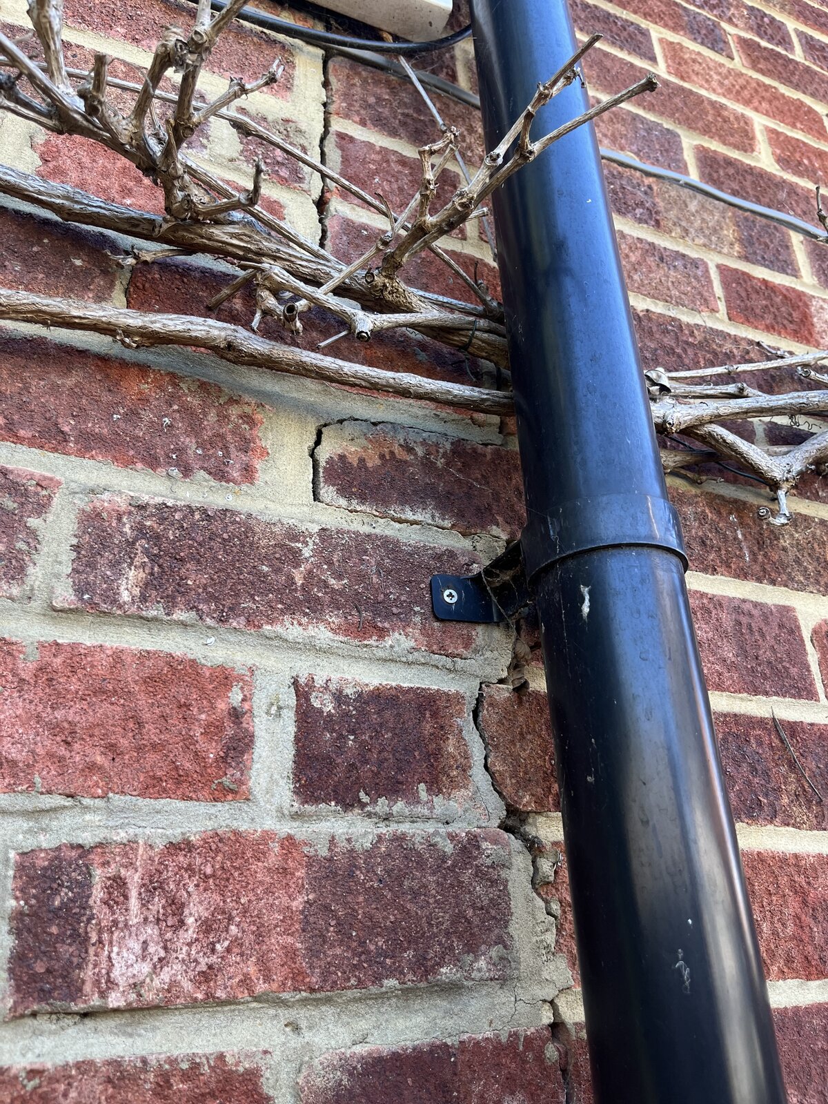

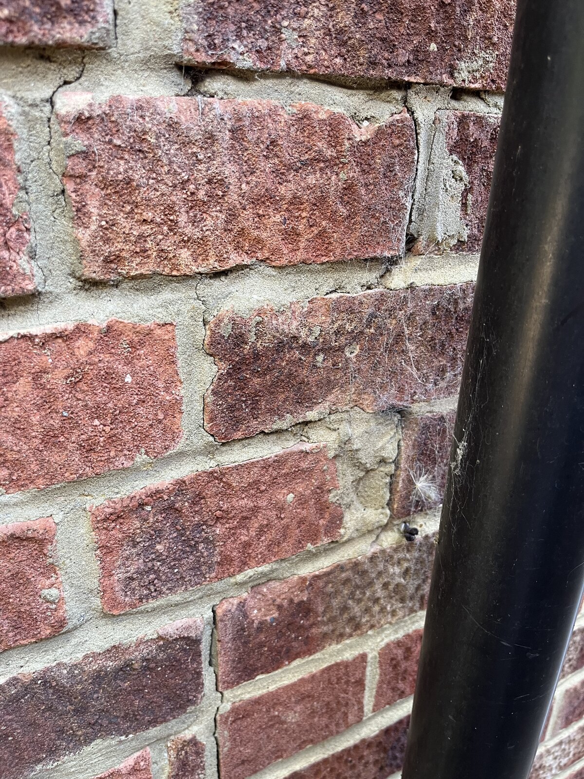

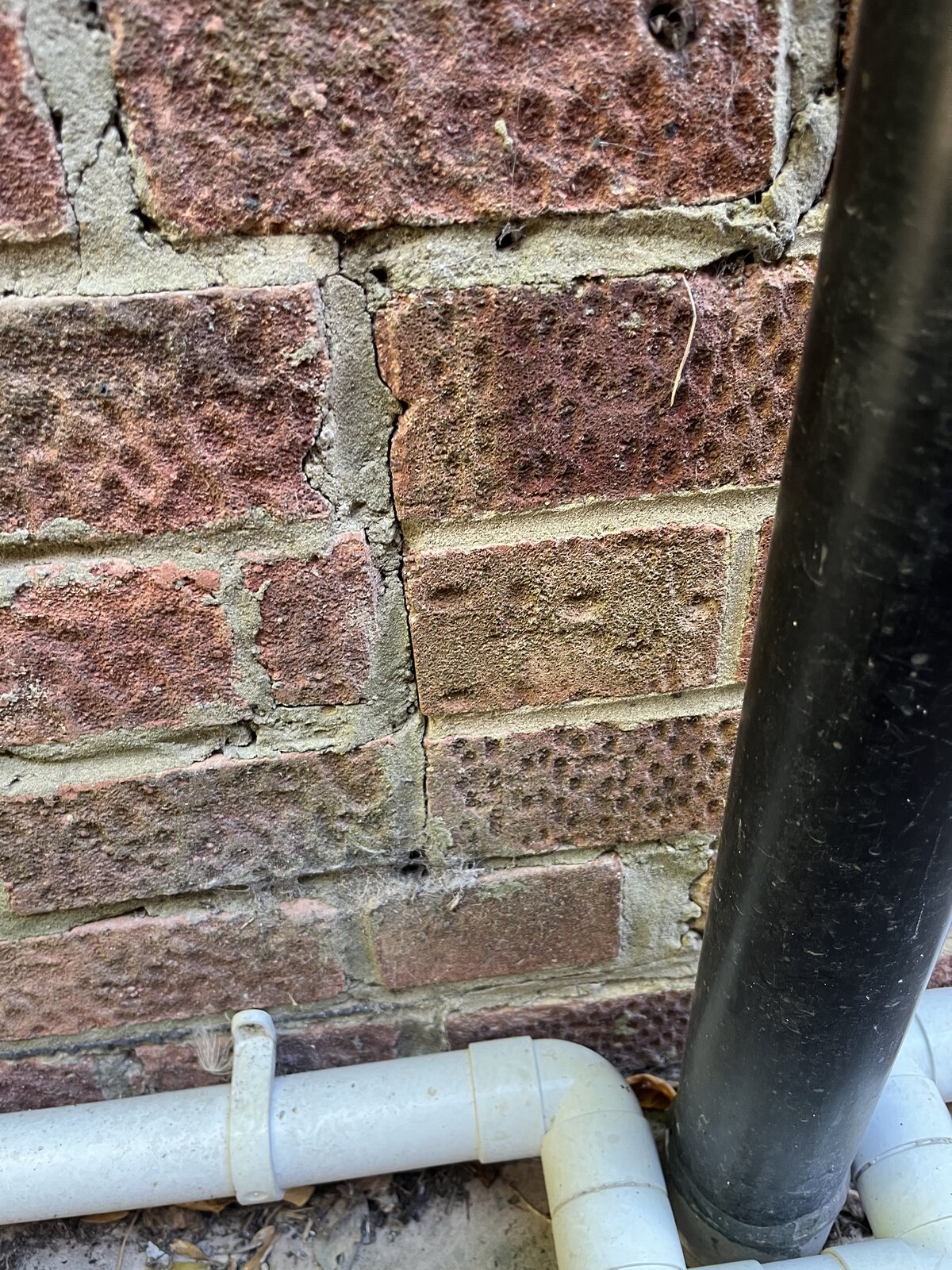

Hi there, we have lived in this property for 3 years. 1960s house with a single story extension built in the 80s. We’ve noticed these cracks where the extension joins the main house and are very concerned. They were not mentioned in our full structural survey. Can anyone advise on what our next steps should be. Many thanks!

Looks like you have an extension toothed into an existing structure. Also looks like the crack is slightly wider at the top than at the bottom.
There is a possibility that it could indicate rotational movement of the extension foundations.
Have you noticed the crack change in size recently or over a more extended period of time?
Do you have clay soils? Any trees nearby, particularly large mature ones, or possibly smaller ones in close proximity?

You can monitor the crack using monitoring studs and vernier callipers to determine if the movement is ongoing.
You can also dig a trial pit and check foundation depths, and get the soil tested along with analysis of any tree roots within close proximity of the foundation...

To me it looks more like bad toothing in that has cracked over time.
There shouldn't be 3 rows of bricks lined up.
They would've been better off with wall starters if they didn't know how to do it.

Is the crack larger at the top than the bottom? If it is it indicates rotation of the foundation. If not, it's probably just shrinkage at the joint.
At the moment the crack looks minor and the insurance company at best will arrange for an engineer to report on the cracking.
However, you will probably have an excess to pay so it'll come out of your pocket.
If it's just poor workmanship it's really nothing to be concerned about. You could tie the walls together with some helical bar but that shouldn't work out particularly expensive.

Unfortunately it is slightly wider at the top. Does this mean the foundations have moved and the extension will need underpinning or would we be able to tie the walls together?
Certainly an ash tree shouldn't be 1m from the extension on clay. I would get the insurance co involved, but you might also, if you have legal expenses insurance with your house, have a chat to them about the tree and potential issues and see what they say. It may be a long road, and the tree may have a TPO, but ideally the tree should probably be removed. However, there is the caveat that removing a tree can cause "heave" - the opposite of subsidence. You may well need input from a tree expert.
