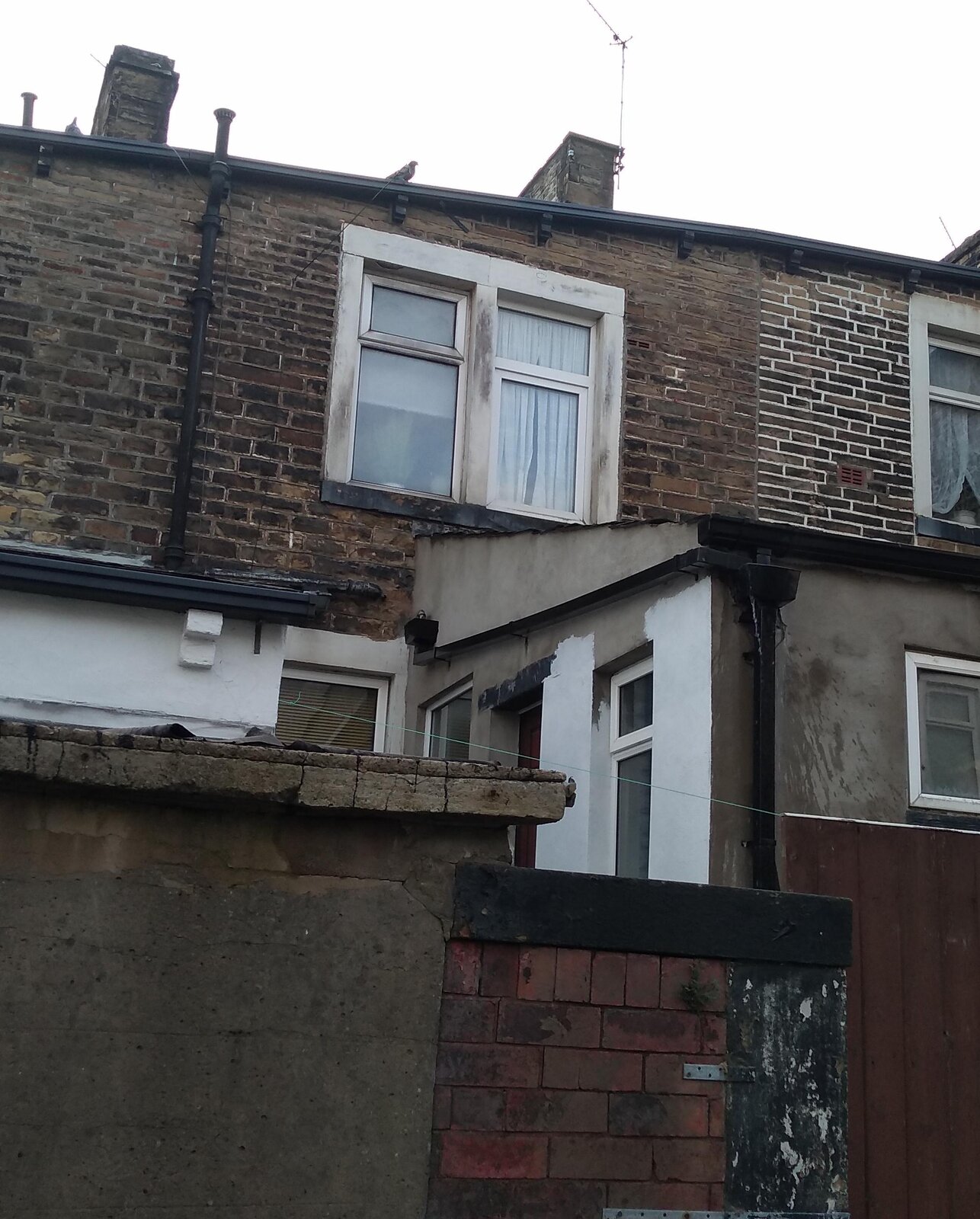

Today I noticed my neighbour's hopper was overflowing, even though it wasn't raining.
Then I noticed the water appeared to be steaming, although admittedly it was chilly.
Then I noticed it comes from a pipe near their bathroom and I started to wonder.
Are they drainging thei bath into the gutter??

Haha yes it does appear to be the case!
Apart from being illegal, it's quite an odd way to do it. I guess they shied away from connecting into the cast iron soil pipe.
The use two two hoppers seems
Also odd that they fitted a whole extra bit of downpipe and second hopper instead of just running the bath pipe straight to the lower hopper:unsure:
Probably thinking of a better flow rate ;)
To that effect it may have been a bit of overkill regarding the Building Regs. Max run for a waste would have been 3m, before they needed to upgrade to 50mm pipe, and possible there were/are other wastes (e.g. a shower) going into that hopper that we cant see.
