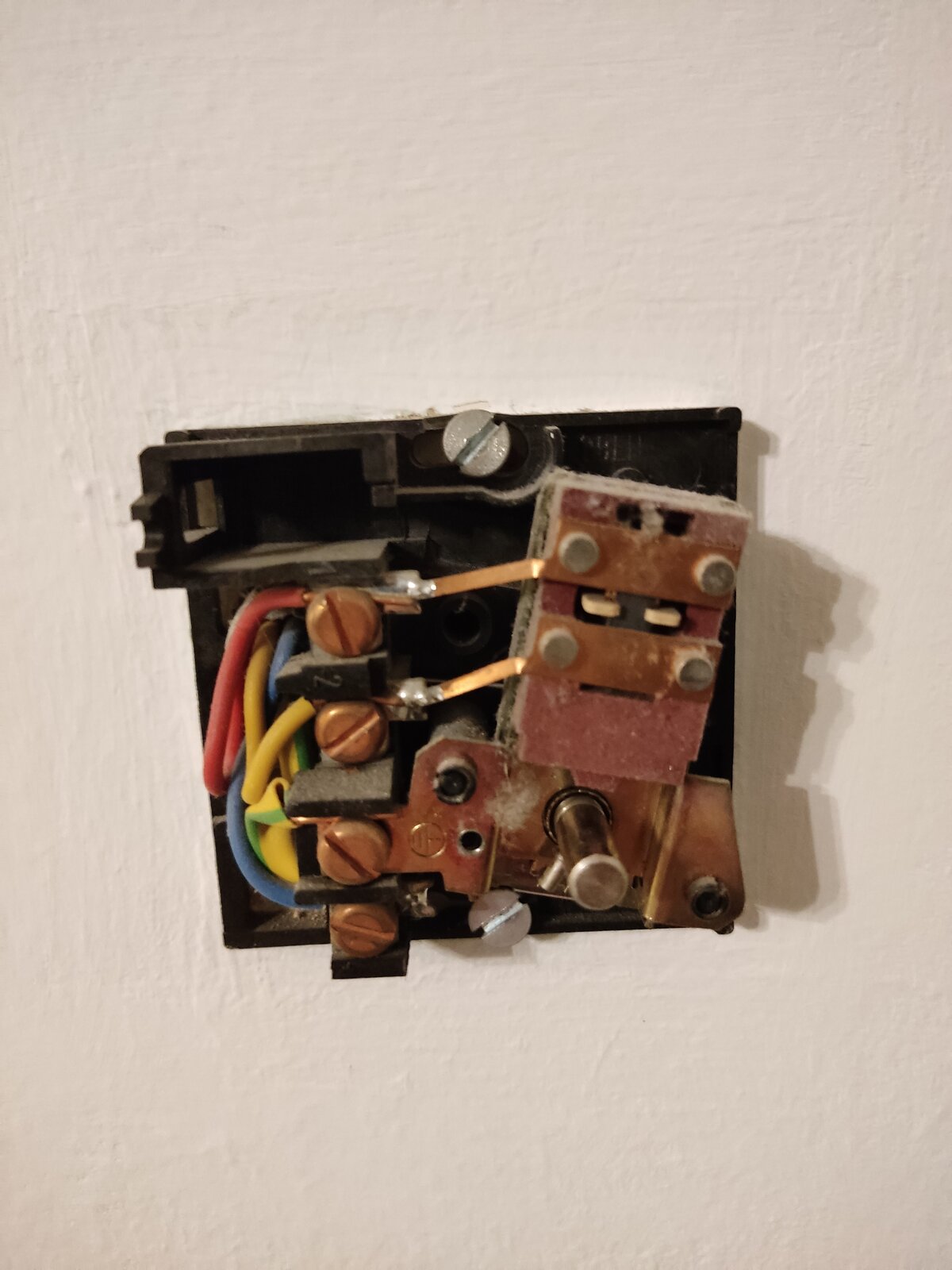

The current thermostat is an acl 4 wire model. Is that compatible with nest? If not, what work is required please?

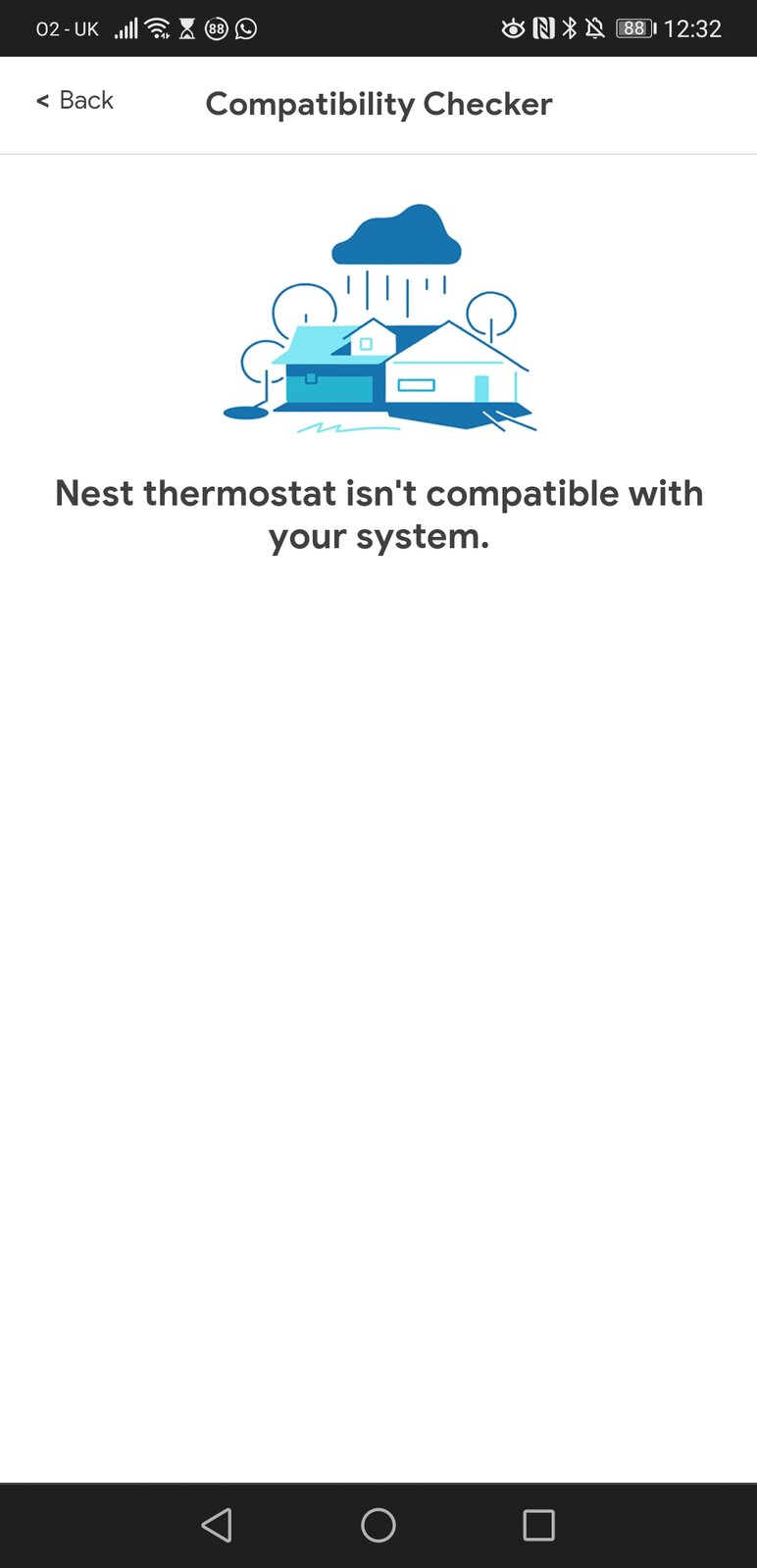

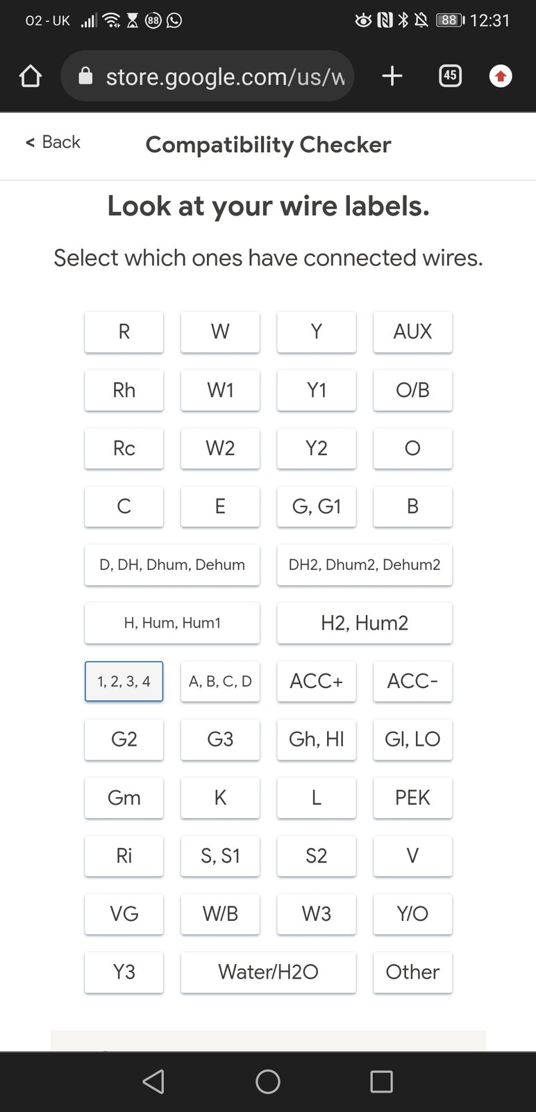

I found an online compatibility checker for the nest E and says its not compatible when I select the wire labels as "1,2,3,4" - wondering if I chose the wrong selection?

The online checker you have used is for the North American version of Nest that controls combined furnaces / air conditioning. So I assume you have the UK Nest-e version which is much simpler:
The red wire in the thermostat terminal 1 goes to Nest-e Heat link terminal 'C' (Common)
The yellow wire in the thermostat terminal 2 goes to Nest-e Heat link terminal 'NO' (Normally Open)

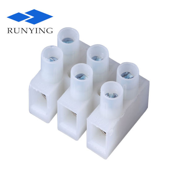

UK Nest-e does not require connections to the other two wires so the blue neutral and green/yellow earth should be insulated / isolated separately and tucked safely out of the way. I normally would use a couple of screw connectors.
The central heating should be set to be permanently 'on' at the LP241 and all control of the heating done using the Nest
That's great! Thanks for your explanation. Would something like this be okay to isolate the unsused cables?
