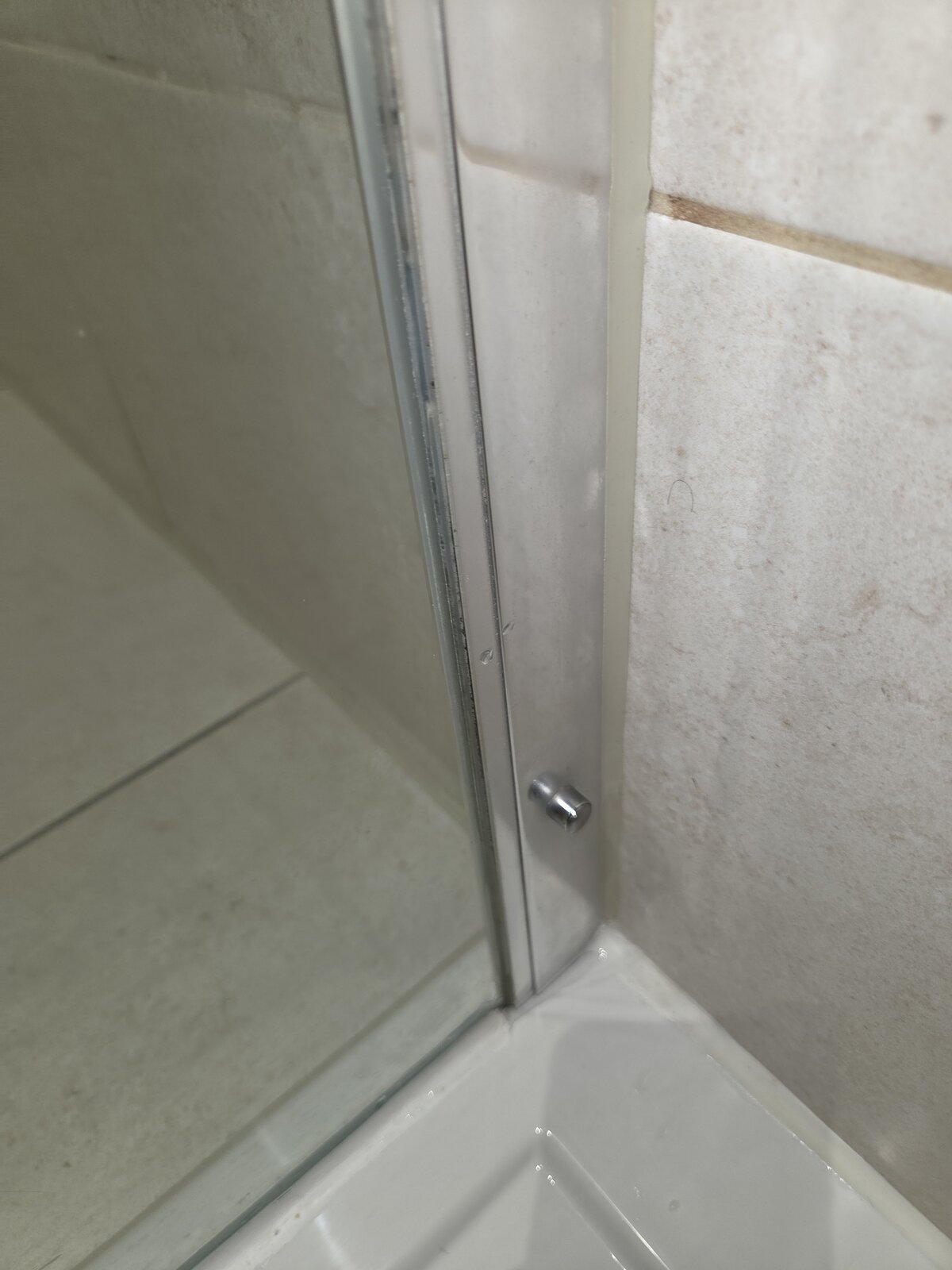

Is there meant to be water sitting here (shower)?
9 May 2010
266
20
Fife

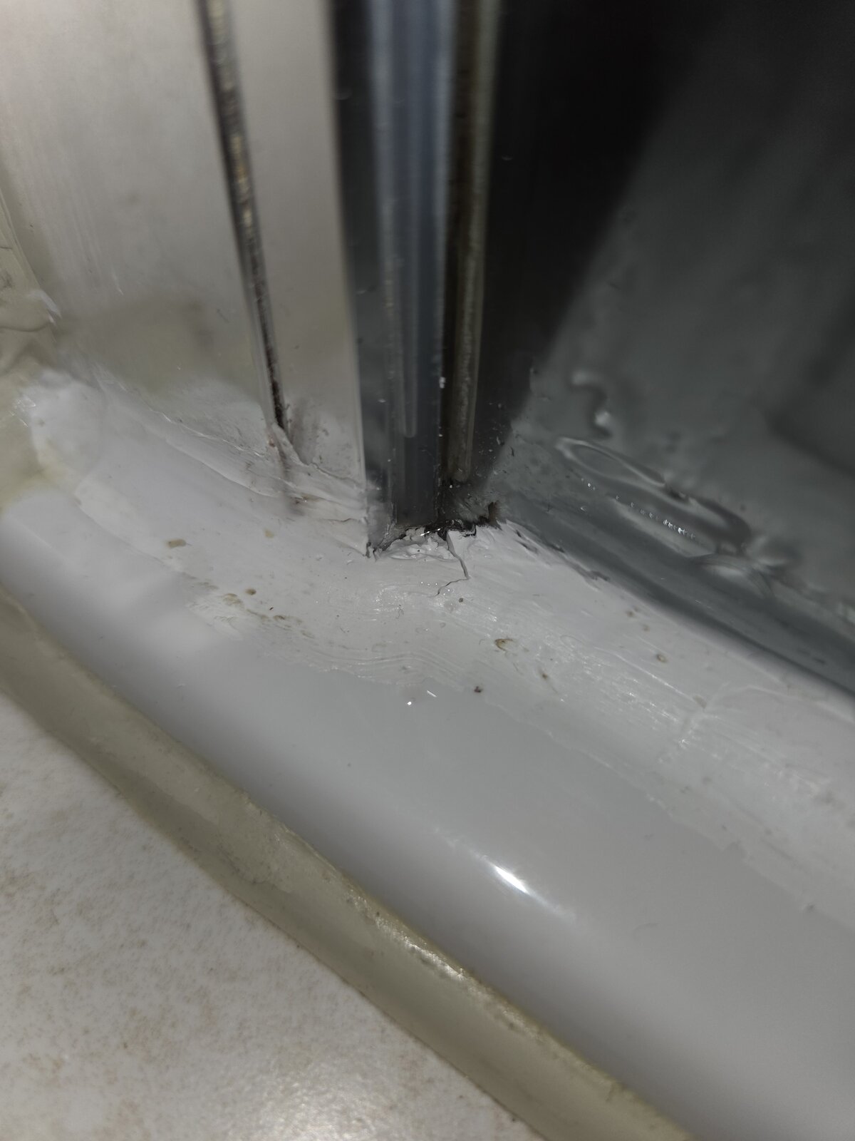

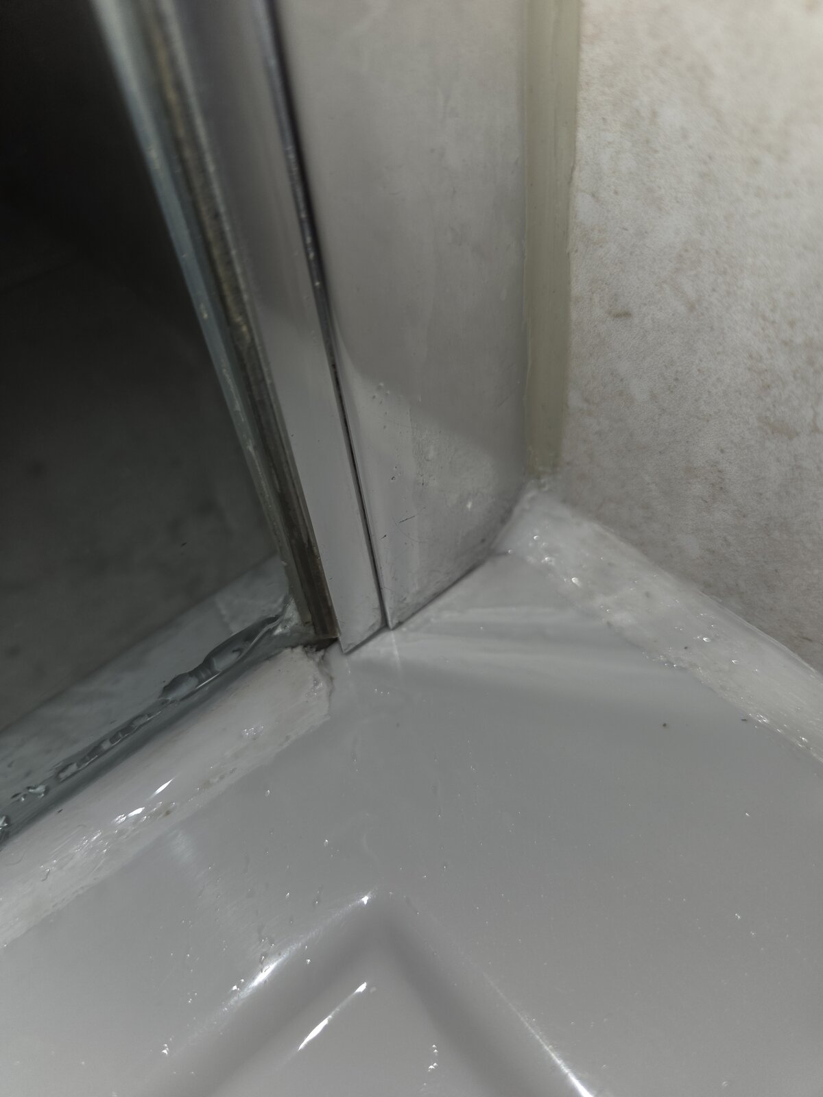

Hi, i have a silicone guy coming to reseal my walk in shower tomorrow but noticed there is water sitting in the outside clear vertical channel (not sure what the technical term is). I peeled some of the silicone away (before i took photos) from the outside at the bottom of the plastic strip thinking if the bottom of the strip wasn't sealed the water would drain out however it hasn't.
Is this normal as i thought the water was meant to drain to the inside? Does it mean there's a bigger issue?

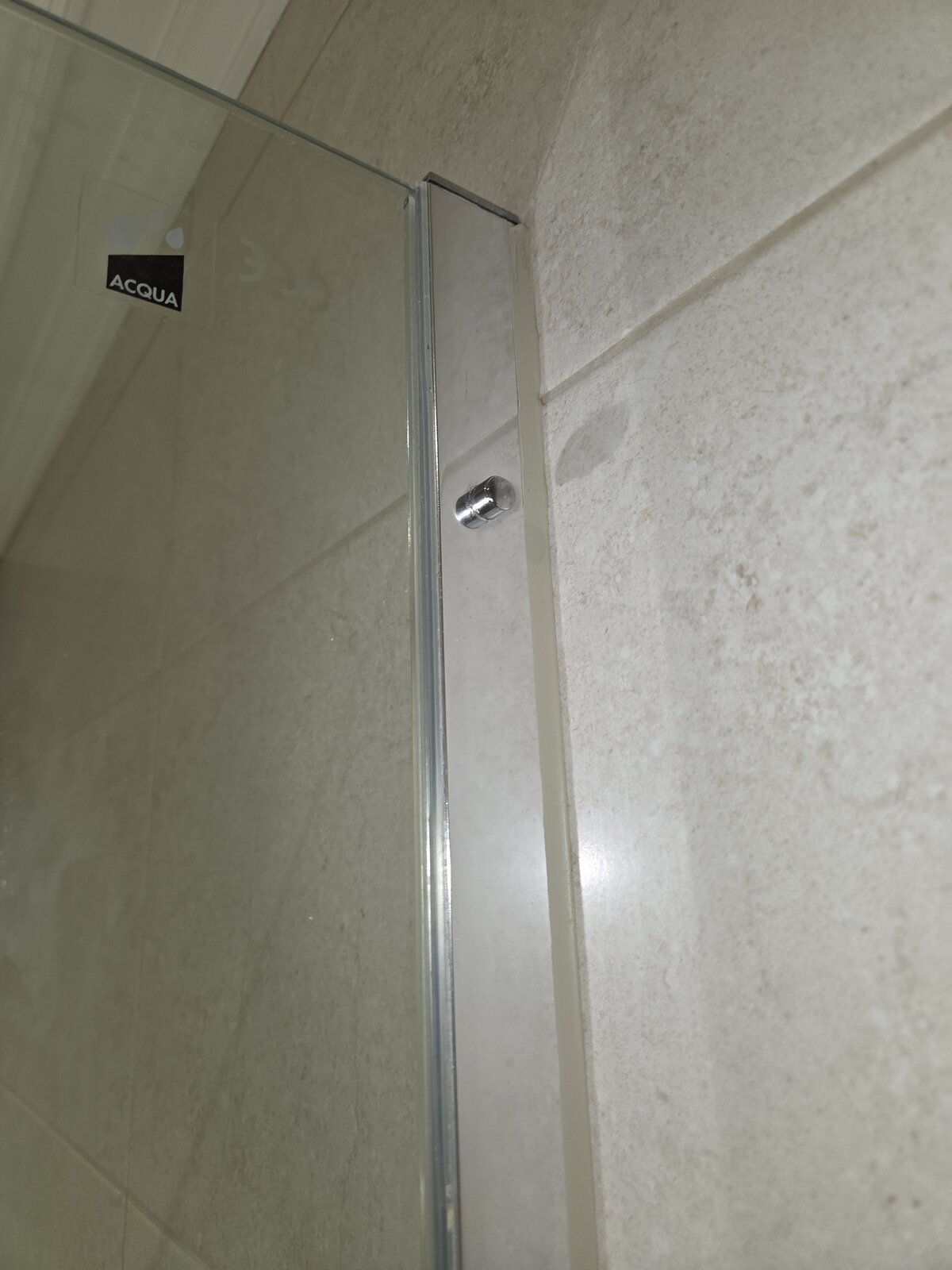

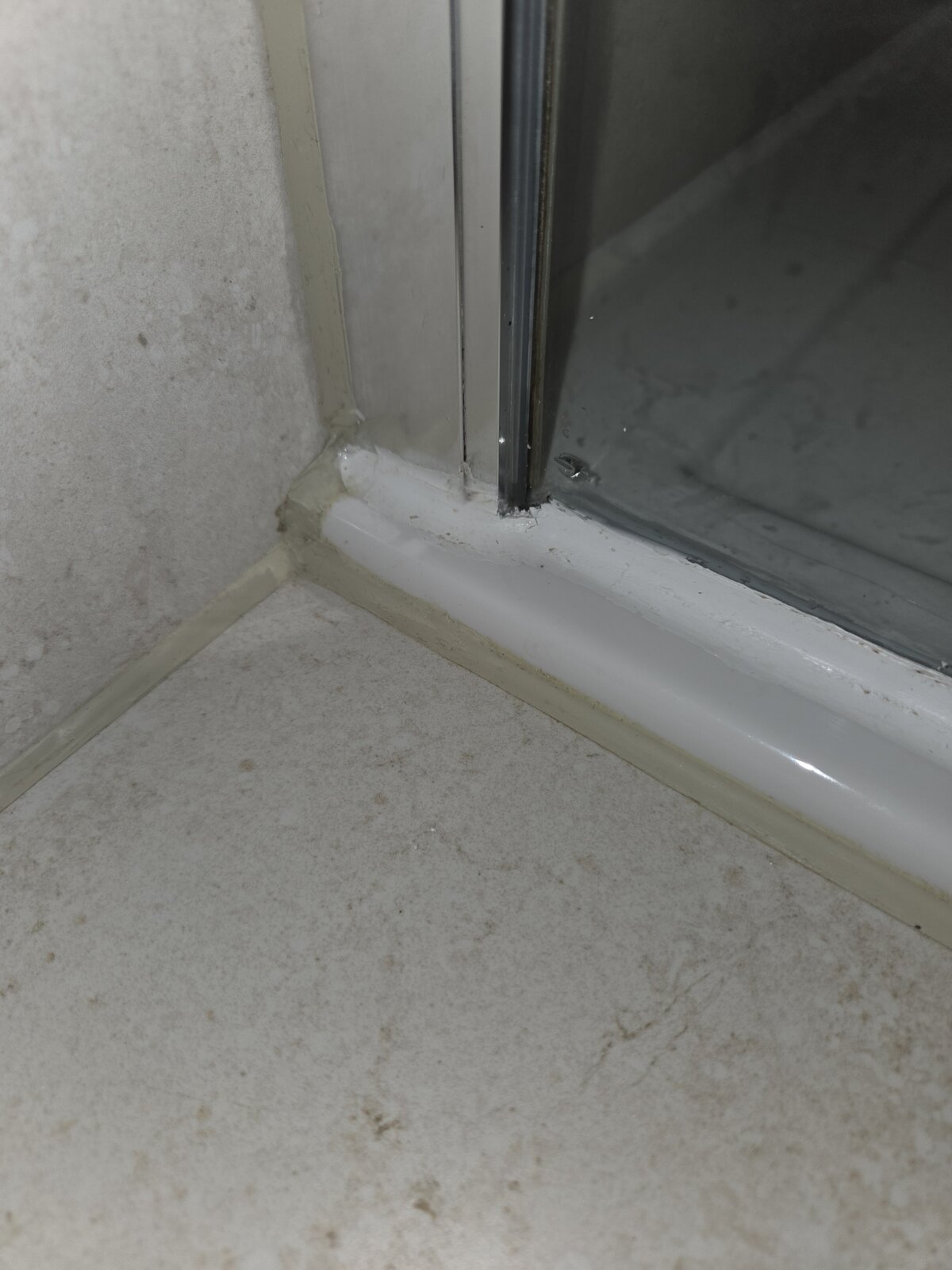

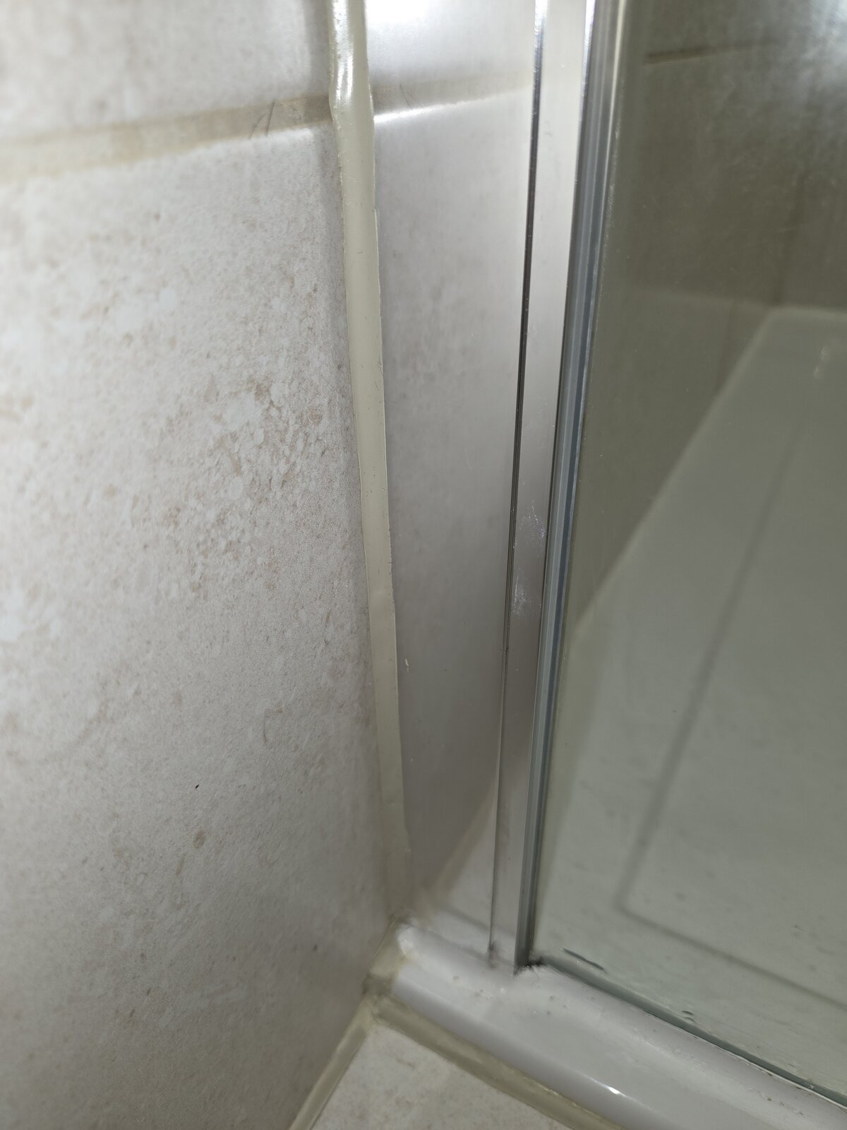

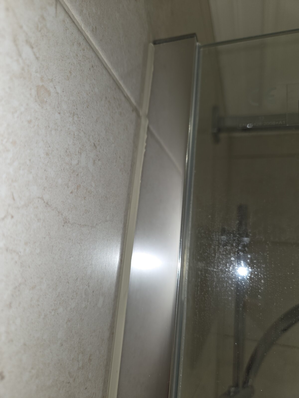

Also looking at last 4 photos the aluminium part of the screen attached to the glass doesn't seem to be pushed in to same extent from top to bottom (not sure if that's just because the wall maybe isn't flush?
inside view -
Outside view -
Inside -
Outside -

I may be wrong but I think it is designed so that you do not put silicone at the bottom of the glass, it looks like the tray is slightly raised at the outer edge and and water that gets under the glass is free to drain back into the shower. The silicone there at the moment is blocking the escaped water from draining back.
The frame is screwed to the wall then the glass frame section pushes into that and that gives you adjustment for things not being square. Which is what you are seeing
Thanks for replying. I thought that with the bottom of the aluminium profile (Photo 1) not being sealed at the bottom internally, the water would still drain back into the shower?
I think the seal should only be on the outside of the frame so no water can get trapped too.
Thank you. Is that the same for the internal vertical joint too (where the aluminium frame meets the wall tile?)
NEVER EVER Silicone the INSIDE of a Shower cubicle.
Only ever Silicone THE OUTSIDE shower profiles to wall & the shower base to the shower rails.
As soon as you mess around sealing inside, you trap any water, that gets between the profiles & starts to rot away your silicone, causing leaks.
If the inside is NEVER Siliconed, then this lets the water that enters into the shower profiles, drain out into your shower trap.
You're worrying about the ~1cm of water that is present in the bottom of the gasket between the aluminium frame and the glass that the frame clamps?
You don't need to
No
The glass mounts are thus deliberately, for exactly the reason you suppose; frequently walls are not plumb and/or trays are not level so there has to be some measure of adjustment/give somewhere. By the rail being two part this can be achieved though you will see the deviation of you look closely. You can't really resolve it any other way short of rebuilding the wall to be plumb or the tray to be square to the wall, which may then affect water flow so you'll have to look past it
Likely you've only noticed now that you're looking very closely because of something else you're wondering about. Don't worry about it

Just to add....The 1st picture where there is NO Silicone bead between the Wall Profile & Base!! This is often done because of the reasons already pointed out earlier. So water can freely drain back into the shower base & to the waste.
As i said, you should never silicone a shower cubicle/enclosure internally. Always important to silicone externally & check manufacturers installation instructions.
Theres 1 situation imo where ive sometimes had to silicone internally & this has been along the shower glass panel, if for instance, there is far too much flex or movement, this could be due to poor quality product & poor thickness glass.
See! Its never straight forward is it? lol

Appreciate the help everyone. I'm assuming if it still happens after the reseal it's not an issue?
No bad will result
