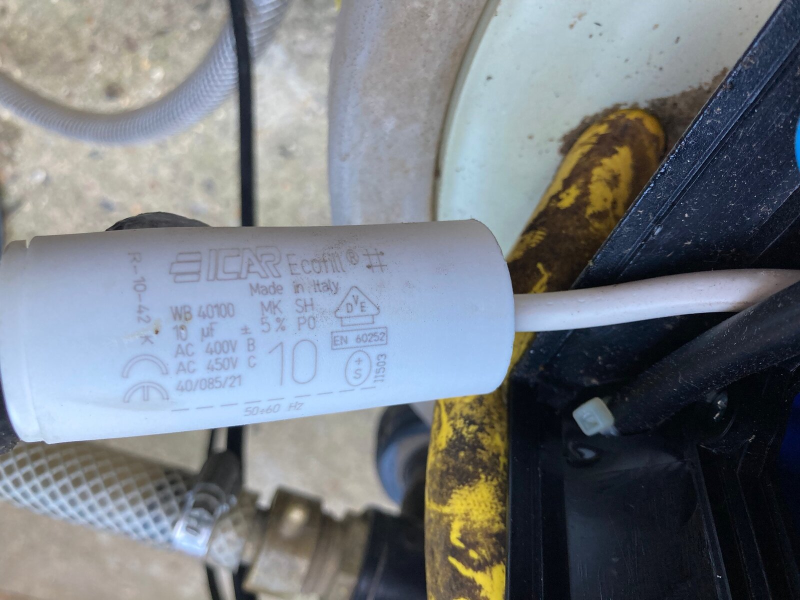

Hi all,
I'm usually found in the plumbing and heating or combustion chamber forums.
I've a powerflushing machine (basically a pump) which is having issues.
The motor has a start up capacitor which is showing a blob of what looks like blue tack on the side, but it's rock hard.
Should this be there or is it a bulging capacitor? I can't tell.
And can it cause the motor to overheat? I had to start it by manually spinning the fan and after an hour there was a funny electrical burning smell, lots of vibration and a red hot motor. So had to shut it down.

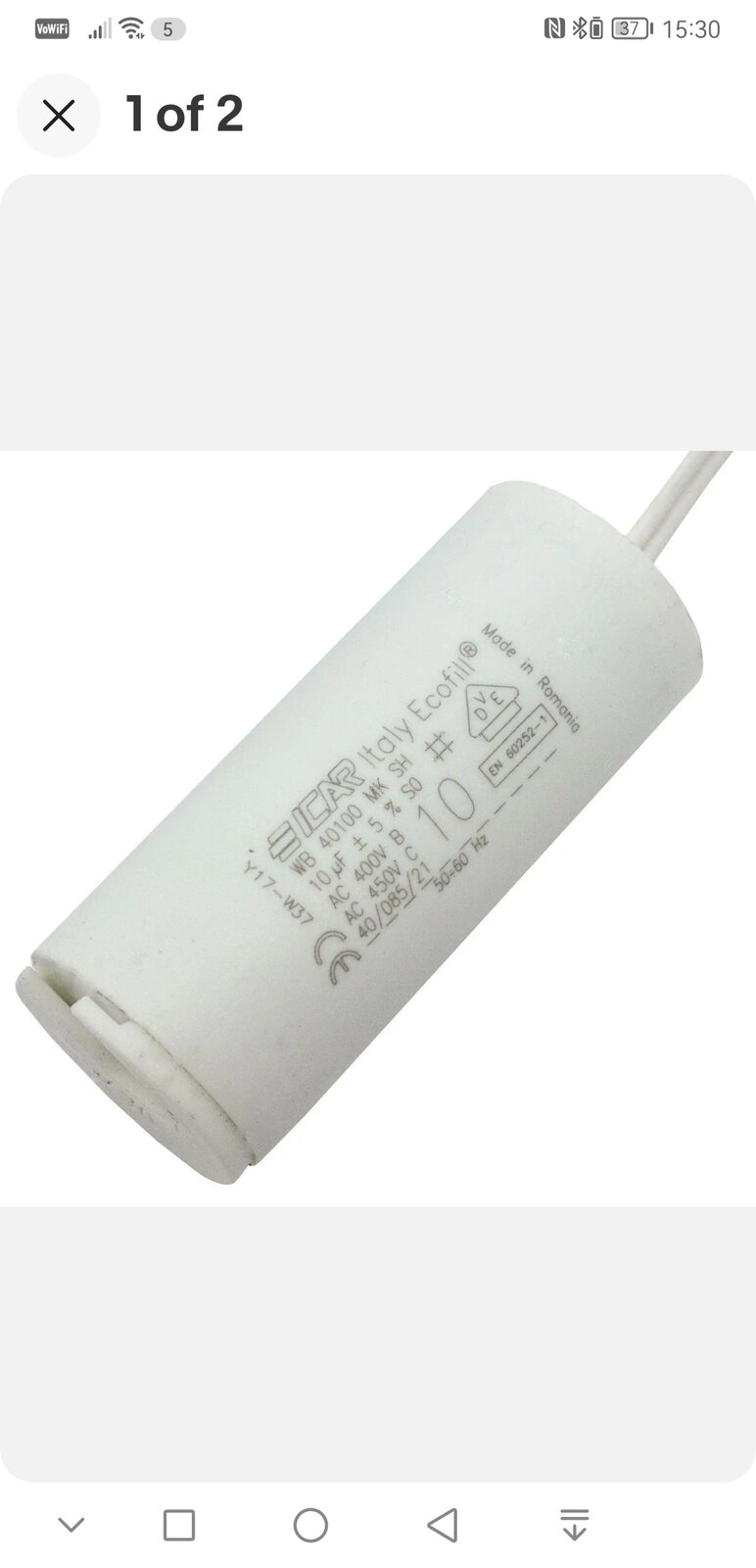

Pics attached of existing cap with bulge. Data label and a potential replacement cap I found on ebay but is not 'exact' same details on label... Although very similar.
Can a failed cap like this cause motor to overheat when running or is it purely for start up and should not cause motor to overheat if manually started, as I did?
TIA
Dean

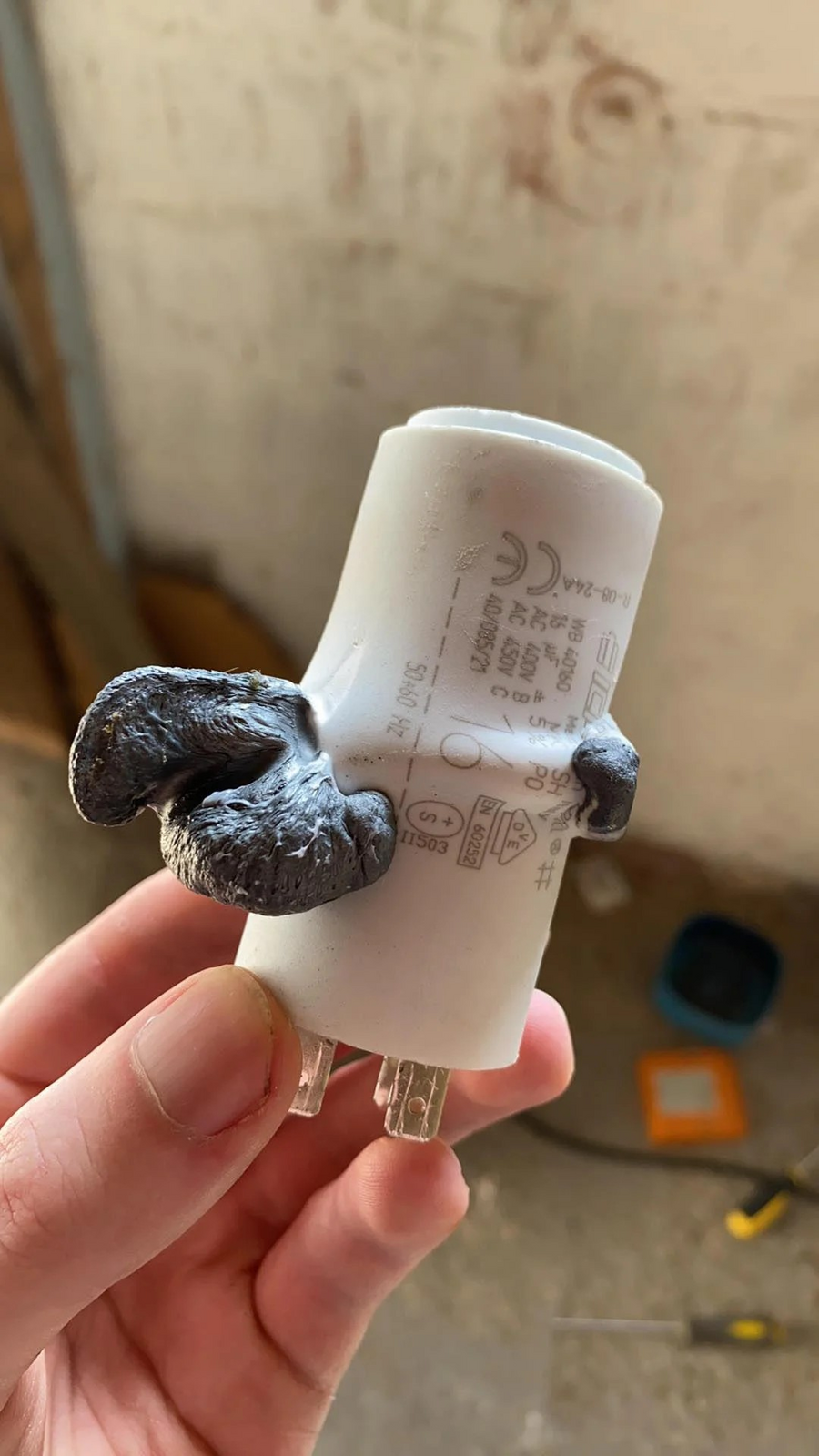

Yes that is sign of a blown capacitor. Being only the start capacitor I dont think it has anything to do with the motor getting hot.
Example from elseware, a little more extreme than yours!:
New capacitor time I think!
Although there may be further issues, that led to the cap failure.

Its quite common for 'cheap' motor caps to fail in the way you have seen. I don't recommend that you source a replacement from Ebay!
Some general rules for substitution:
i). A 'motor run' capacitor can be used to replace a 'motor start' capacitor but NEVER the other way around.
ii). A higher voltage rating cap can be used to replace one of a lower rating, but never the other way around.
iii). Don't assume that the maximum voltage that the capacitor is exposed to is the supply voltage - it can be exposed to higher voltages.
iv). A capacitor of a smaller tolerance can be used to replace one with a greater tolerance.
