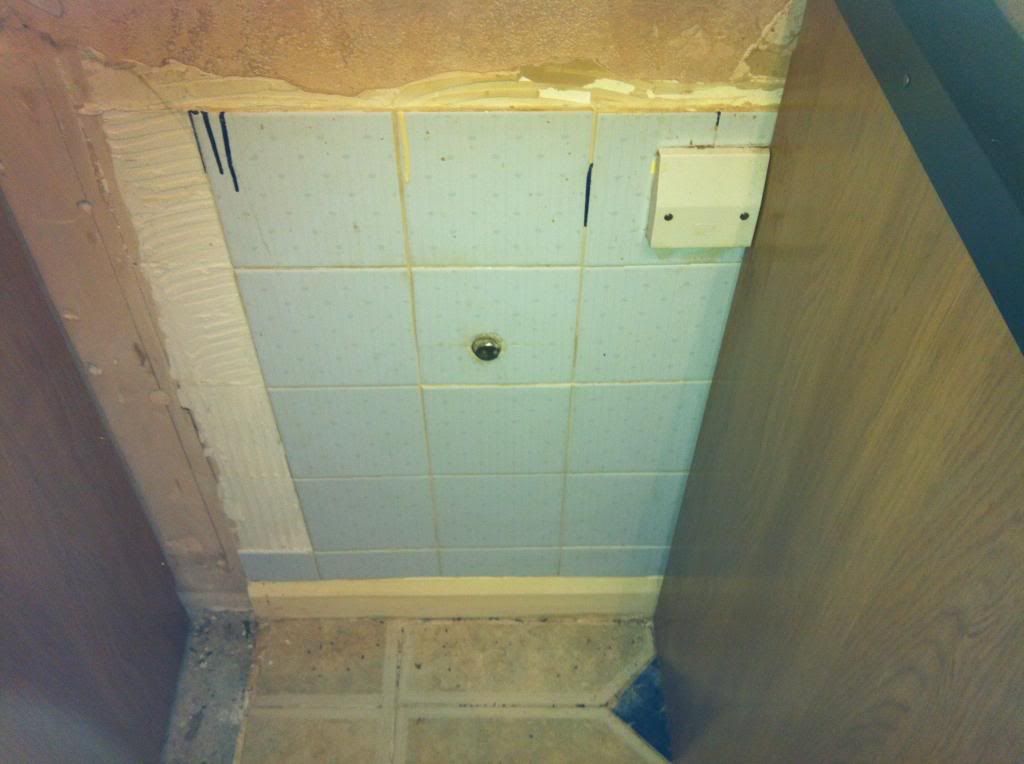

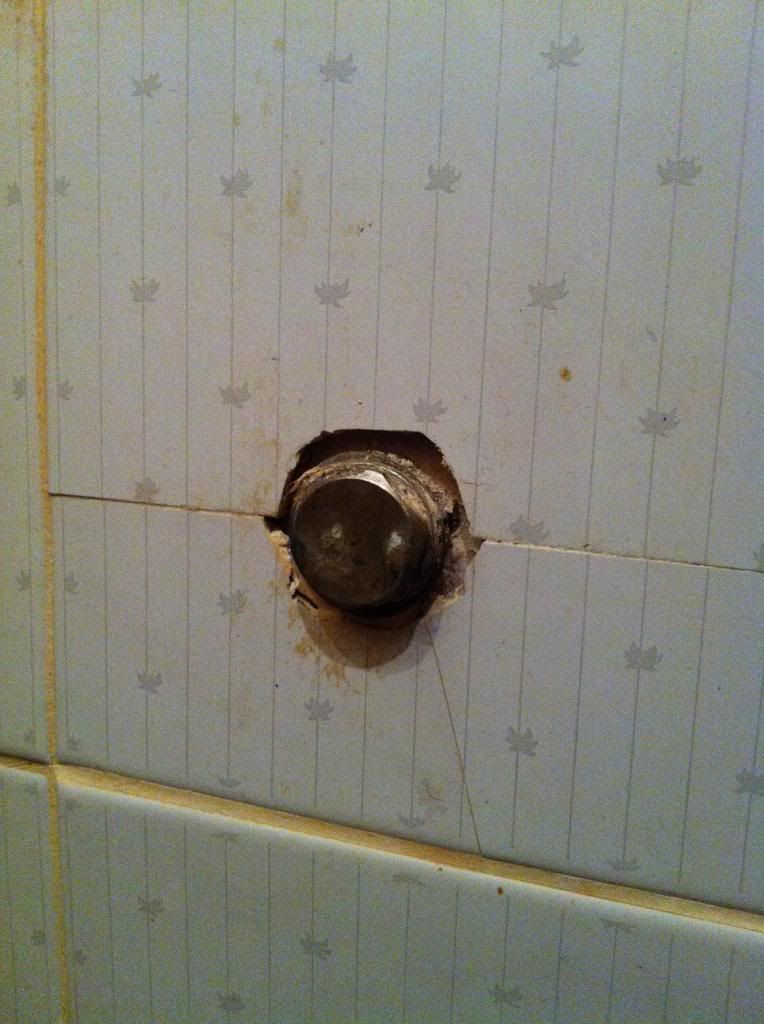

I'm in the process of refurbishing my first property.
I would like to purchase a dual fuel cooker but was unsure whether I had a gas connection for the cooker.
On the wall where the cooker should be is a silver cap which i am not sure if it is a capped off gas pipe.
I have a couple of pictures showing this.
http://i1178.photobucket.com/albums/x371/china_rose888/image-1_zpsda9f82de.jpg
http://i1178.photobucket.com/albums/x371/china_rose888/image.jpg
I just want to make sure that is a gas connection before I make a purchase
Many thanks
Looks like a gas pipe blanked off, however you would need to get a Gas Safe registered person around to sort it out and make it ready for the gas cooker. It will need a bayonet type fitting putting on the outlet for the gas cooker supply hose to fit onto. As it is, it wont connect up.
