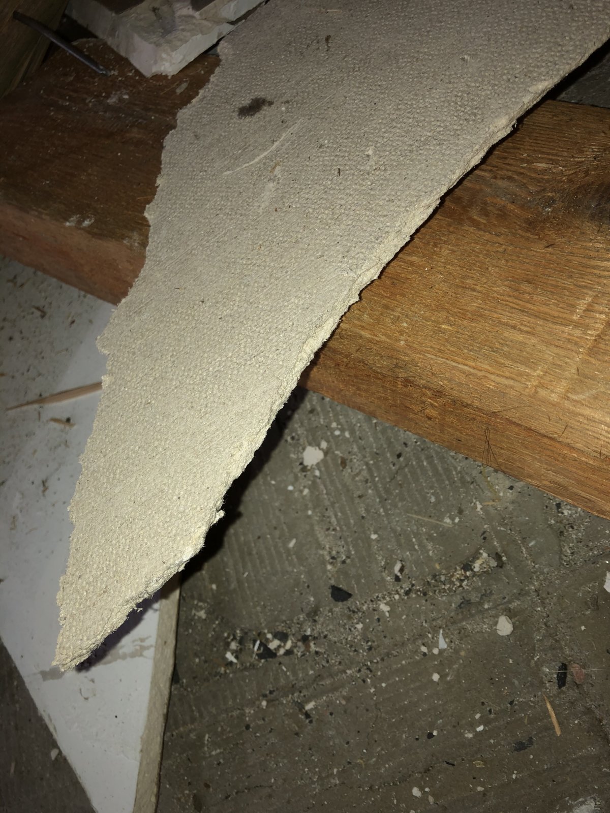

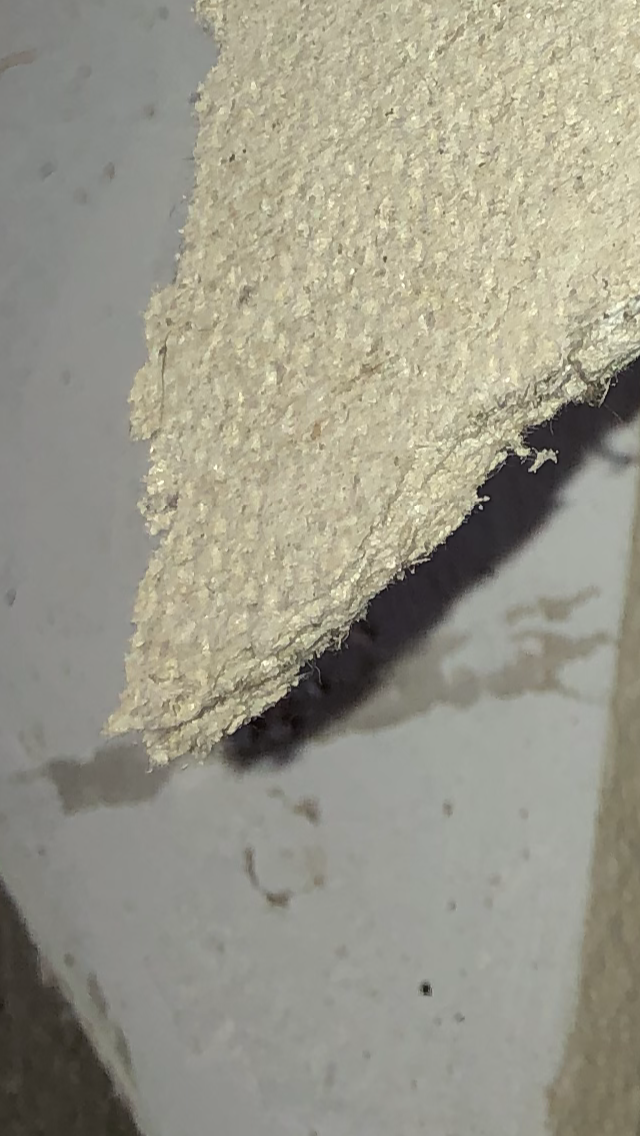

Yes could well be, usually about 6mm thick smooth shiny one side dimpled the other hard and brittle (stiff to break and hard to push a pin into) if AC. Softer if AIB and thicker.
