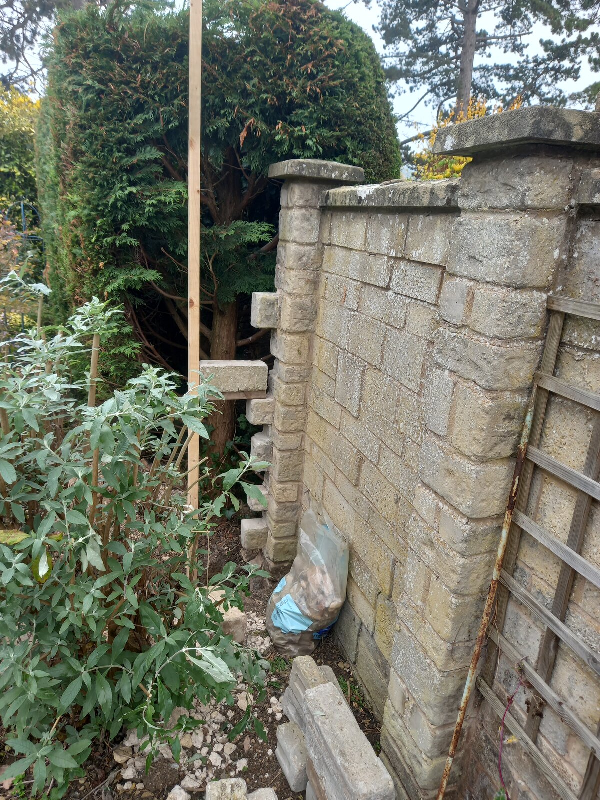

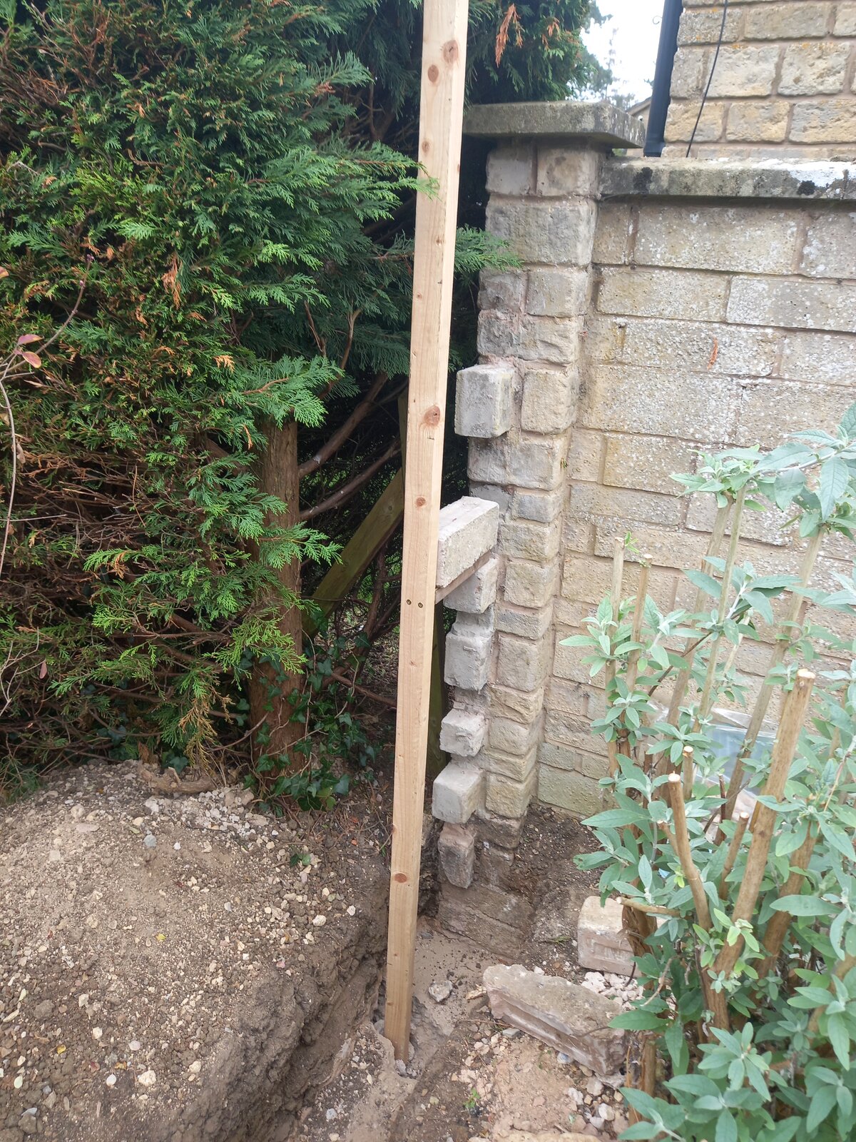

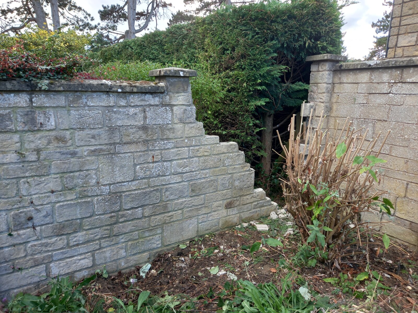

My garden wall had developed some large cracks over the past few years and got particularly bad this year. So much so that we've knocked it down and, once the footings have been dug out, are likely to replace it with a hedge instead. The situation we current have is the existing neighbouring wall that used to tie-in to our wall in the corner (see pics). Without our wall, theirs is susceptible to movement. It's not loose per-se but does flex slightly. I'm sure with a big shove or a gale-force wind, it could be brought down.
I want to support the wall with adding a small buttress in the corner. It will be one brick (stone) thick and extend out about 12". My query is whether this is sufficient to make any difference or am I just wasting my time?
In an ideal world we would demolish and rebuild the whole wall, digging the footings deeper and reinforced and re-doing all of the joints. This option is not possible / not financially viable though.

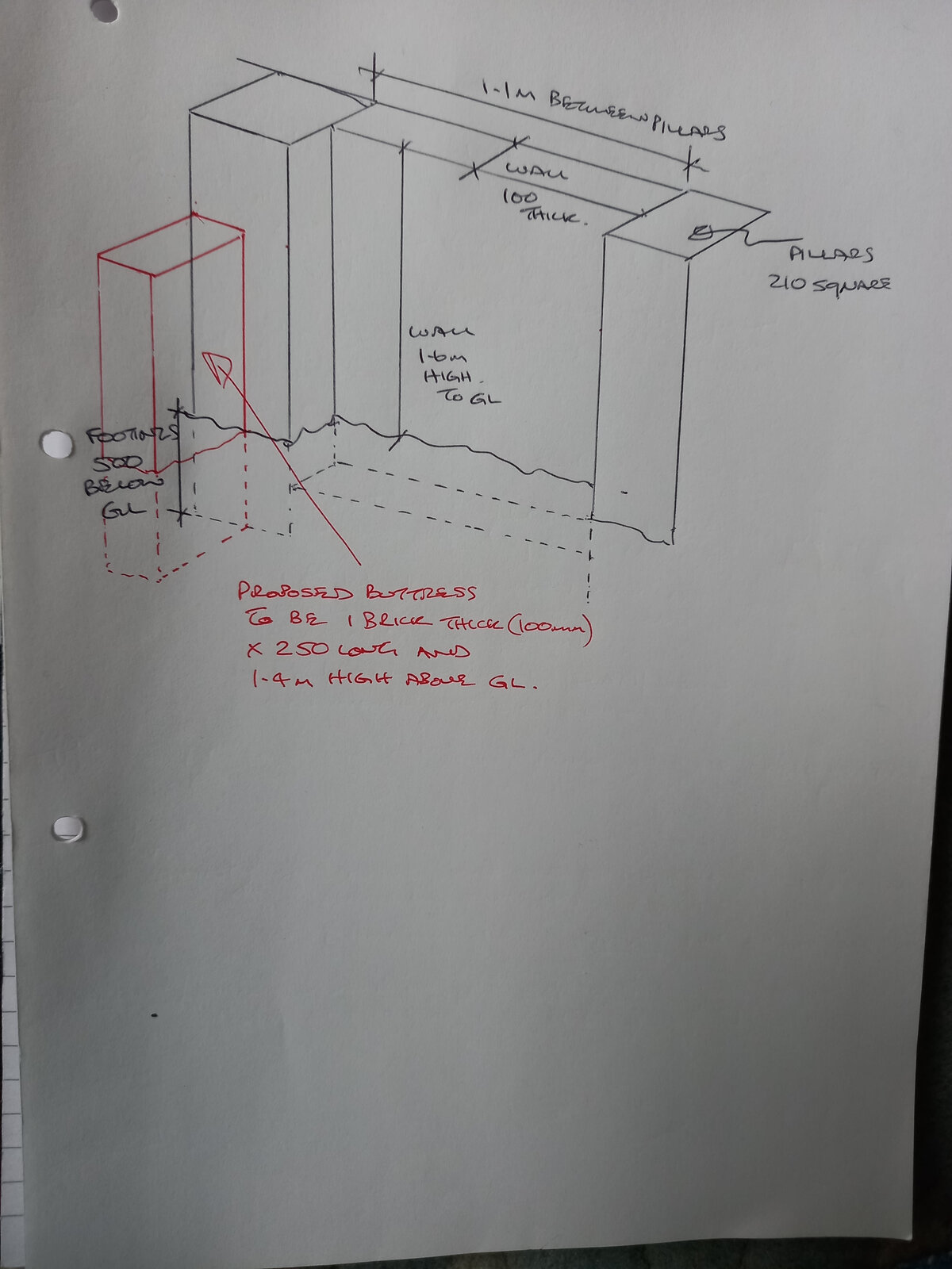

The current wall is 1.6m high from ground level, one brick thick, with pillars (210 square) at 1.1m spacings face to face. Footings are 500mm deep.
My plan is to add an additional one-brick thick wall, 250mm long, 1.4m high, at 90 degs to the end pillar to stop / reduce the possibility of the main wall from toppling over. This 'little' bit of wall I'll be building is in fact the re-building of the previous 90 degs wall which I knocked down in the original pics.
I assume that we we're talking structural mass of any 'buttress' as to whether it will do it's job? I haven't totted it all up but tbh I think it will looks sufficient.
Putting it another way. If it's not then it's one hell of a difficult job to build something bigger, digging out old foundations and re-building etc.

A quick way to find the size of a new pier is to work out the horizontal wind load on a portion of the wall and assume the wind is trying to push it over. Then, assume that all the wind load is to be resisted by the pier alone, and then work out the weight of pier required to more than counter-balance the horizontal wind load - if that makes sense?! This is a conservative way and would give a safe size of pier.
1. work out the area of 2/3 of the length of wall between the end and the first intermediate pier (including the width of the pier itself). This would be approx. 0.8m? x by height of 1.6 m, = 1.28 m2.
2. Assume all the wind load on this area is taken by the pier alone (the thin 100mm thickness of the main portion of the wall provides very little resistance).
You could safely assume a wind load of - say - 0.6 kN/m2 assuming you are in a suburban- and not exposed area or near the coast. (1kN is approximately 0.1 tons in old money).
Therefore total wind load on your pier would be 1.28 x 0.6 = 0.76 kN. This will produce an overturning moment at the base of the pier, which = 0.76 x (half height of pier) = 0.76 x 0.8 = 0.6kNm.
A quick back-of-fag-packet calc. suggests that your existing pier (0.21m x 0.21m) plus your new pier (0.1m x 0.25m) would not have sufficient mass to counter the wind load in a once-every-five/ten year gale. I'd be inclined to make your new additional pier at least 450 and preferably 500mm long to be safe. It should also be well-attached to the existing pier (say, with at least 4 decent stainless steel brackets) otherwise that itself could be blown down sideways.
