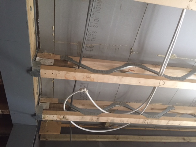

Those following my threads will probably have seen a few moans about my plumber. I took these photos today as not sure this is correct. This is basically first fix pipe runs in a timber frame house.

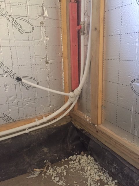

This first one is for mains feed to roof he added an isolation valve which i have to somehow surface mount he said is fine will be hidden behind cabinets in utility. Not sure how I'm supposed to plasterboard it of maintain a VCL on the frame.
This one is for radiator feed on first floor. I showed him the rads and where i was putting them but he doesn't want to take responsibility of drilling through in the wrong place so has put them on a loop and told me to put them in when I've hung the rad? Obviously i can't finish the ceiling below before the wall above which seemed odd to me plus ill have to drain down to feed the loop through.

First picture is a mess. And leaving the valve concealed is stupid. Is that curve in the pipes not gorgeous to be an issue too?
Second picture I can follow his logic, but the history of the job is not promising. I would bring the pipes down in the wall and leave myself options at the bottom.

I'm not sure the guy is used to working in a timber frame. Just how can I fix the pipework issue? I can't really run the pipes through the soleplate so maybe swap the bend for a tight 90? But that still leaves it surface mounted which I suppose I can accept as it's behind units.

All the work I do (well 99% any way is new build) and that is absolutely shocking.
Bin the bloke off and get someone else in to sort it out.
