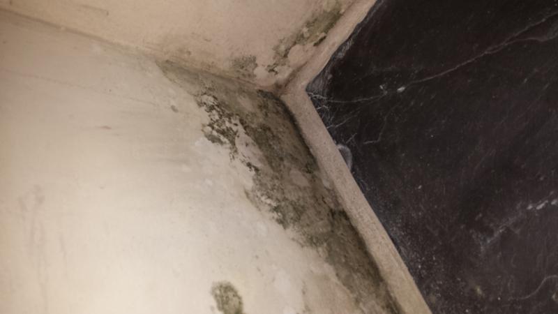

I have attached a couple of pics but basically I had a fireplace done with heat prof plasterboard skim. Over the last few weeks salts and dark patches have appeared. I am 99% sure it is damp but would appreciate some expert opinions so I am 190% sure.

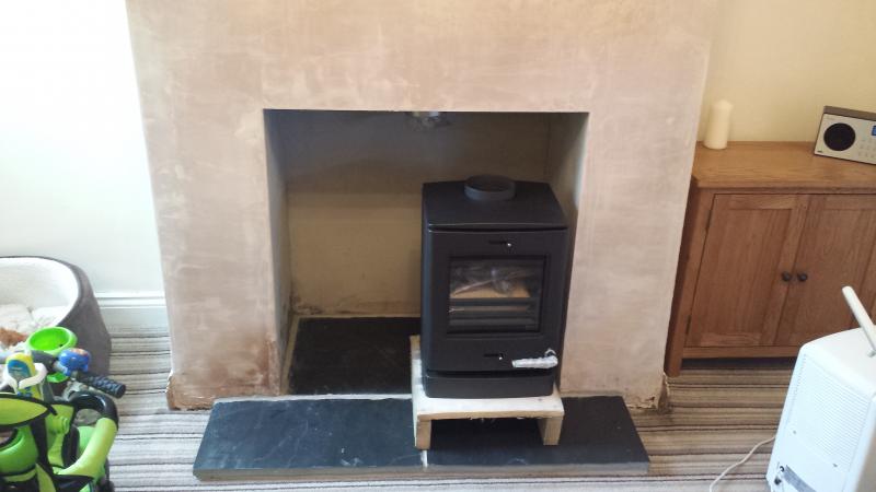

Hi there, I will take a few more pictures tonight when I get home. Basically in June we had the inside of the fireplace prepped for a wood burner. The installer dot and dabbed heat proof plasterboard and then did a skim with heat proof plaster. Everything bar 1 little bit dried like normal, but in the last few weeks black patches and salt deposits have started to appear. The bottom of the opening has slate tiles but underneath I was told to do a base of concrete. This was poured onto a bed of hardcore but no waterproof sheeting was put underneath. I'm starting to think that maybe moisture is coming up through that.
I might also add that half of the front of the chimney breast was re plastered and this has dried normally. Prior to opening the fireplace we did have damp problems as whoever closed it up did a bodge job with no ventilation and lots of dirt and debris thrown into the bottom.

That is correct, because the brickwork didn't look amazing we opted for them to use plasterboard on the 3 sides which they dot and dabbed on.
The inside of the fireplace was bare brick, when the previous occupants had it sealed up, whoever did it didn't put a vent in and there was a lot of dirt and soot and brick behind it which obviously retained moisture.
We removed a bit of skirting from the front but have since disposed of it.
The stove hasn't been fitted yet as this is holding us up from painting it.
Flue was swept twice before they installed the liner. I'm not sure if they could or would have swept the flue above, the opening that would have been in the above room has been sealed up so don't know if it could have been accessed from below.
Chimney stack should be fine as we had the flashing sorted when we moved in, which was 5 years ago.

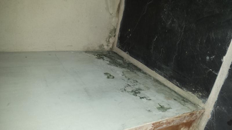

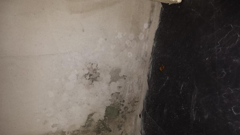

The dark patches are all at the bottom of the plaster and the plasterboard rests on the concrete base I poured in. When I was opening up the fireplace the bottom of it had tiles in the bottom which was uneven and a lot were broken. Underneath them was a lot of dirt, when I dug down for the base there was what appeared to be some kind of old cement base as there were clumps of crumbly yellow stuff so I'm guessing it perished due to water/moisture which is why I'm thinking the base as opposed to the walls.
The fireplace was open for about 6 weeks or so before they came in to start so it had a good bit of time to dry out, and the front brickwork which was plastered with normal plaster has dried ok with both sides showing no signs of salt deposits or damp.
A guesstimate:
the constant moisture that was rising from the old soil in-fill below the back hearth (& front hearth?) would have been dispersed by the open brickwork and cracked slate. And previously by the fire.
You blocked off the rising moisture escape routes and its now presenting as you see. Capillary pressure is even taking it on to the face of the c/breast.
If the above is accurate then the remedy is to remove all the D&D p/b, and clean off any sooty brick.
Then dig out to lay a membrane below the back hearth in the fire opening. Lap the membrane up to finished hearth level.
Hidden under the carpet, is there a front hearth?
You could inject DryZone cream into the fire opening three "walls" if you think it worth it, and then render up with a 4:sand and 1:lime mix. Or Limelite remedial plasters.

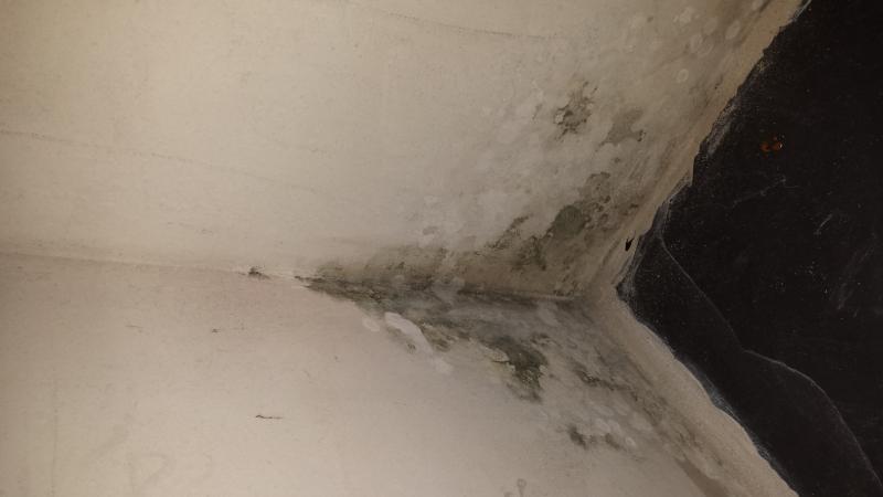

The LH metal corner bead (in the fire opening) will have to be replaced with a plastic corner bead, and affected plaster on the face of the c/breast will have to be removed to opening height - make good with the above mix.
Dont paint or tile anything - watch and wait.

The front hearth is on the concrete floor as it needs to extend a certain amount from the stove front, the back piece of slate is the one on top of the concrete base.
I was hoping to try and remove the back slate tile without removing the plasterboard, mainly for the fact that the top plate has been installed on top of it and there is about 300 KG of insulation in the flue that I don't fancy having come down.
There is obvious damp on the LH face of the c/b. This damp contains salts - it wont go away. The contaminated plaster and plasterboard have to come off.

The steel Register Plate is usually fixed to the masonry - sitting it on the D&D p/b is not best practice.

The register plate is screwed into the masonry but is flush and sealed around the top of the plasterboard. Would you say it would be better to cover the walls with the sand and lime mix rather than more plastarboard?
