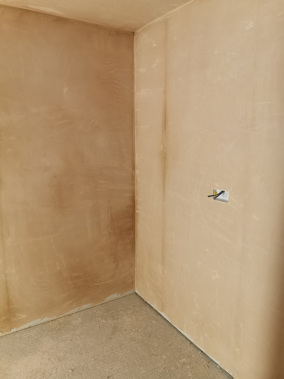

Hi all,
As title, had a few rooms plastered this week, up against it to get the decorating done for Xmas,
Are the two walls shown dry enough for mist coat or do I need to wait for all the dark lines to become light like the rest?
Chris
If you want it decent for Christmas, give it a mist and a finish with Dulux Supermatt or similar. This is a porous, non-vinyl paint that allows the plaster to continue drying out.
It is not as durable or scrubbable as a vinyl silk, but is easy to paint over once your Christmas guests have gone, or at any other convenient point in the next couple of years.
