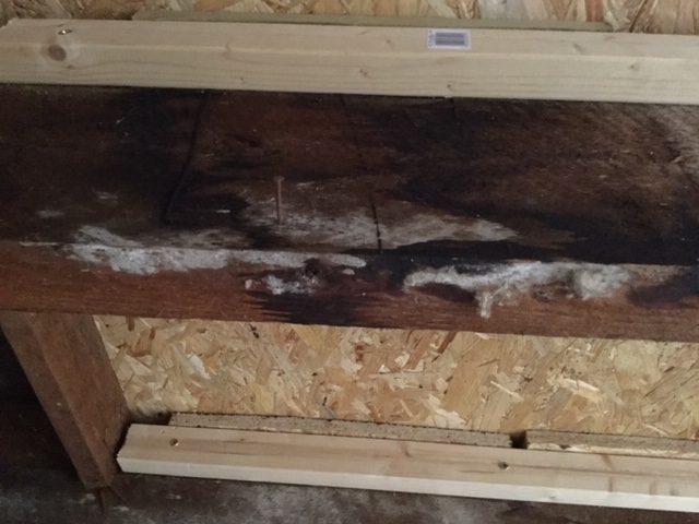

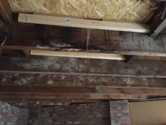

Is this Dry Rot and if so what should I do?
23 May 2017
340
15
Can also see snow like substance on the garage floor.
Planning on replacing the roof very soon but as you can probably see its pretty wet after last winter. The previous owner used the crappy board to mend the roof. The OSB you can see is my attempt to overwinter the problem.
what is the wood like, poke it with a screwdriver and see if it has any crumble or give in it?
could just be surface mould but the poke test should tell you if it's something more sinister
regarding what to do, if it is dry rot then replace the timbers at the same time as the roof
Thanks, John, have been worried, to put it mildly.
No, give when poke with a screwdriver.
No crumbling at all from what I can see.
Can I simply treat with spray bleach?

I plan to let it dry out, remove any crumbling (weak) timber and treat with a wet rot treatment.
Would that do the job?

Chances of dry rot in a garage area low.
Have you sorted out the leak? If when it's dry the timber is hard, then it won't need any treatment.

Thanks for the insight, I was pricing up to do the lot so will just buy a tin to do what I need too when I see what's going on under the old.
It's not so much a leak as the roof was repaired with fiberboard at the back of the roof (I think a kitchen worktop). :censored:
Am hoping to get this sorted within a couple of weeks.
Would you advise me to get the roof off and let it dry out under a tarp ASAP?
Some good advice above
If you want to dry it out just get some heat into it even from sunshine as long as you make sure the roof isn't leaking any more. Taking off the roof won't help much it's the warm dry air that does it. Things tend to dry out over time and the rot will stop.
Airflow will help dry things out. Leave doors and windows open when practical to do so.

The trouble is the fibrous board holds the water in like a sponge.
Will move forward with this ASAP.
Plan to remove the roof as soon as the boards and EPDM arrive and are safely covered over.
Am going for a more expensive tarpaulin from a tent supplier.
