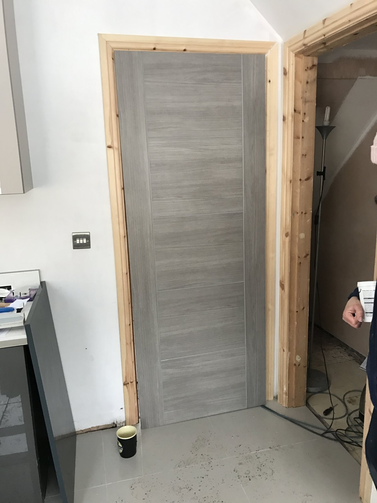

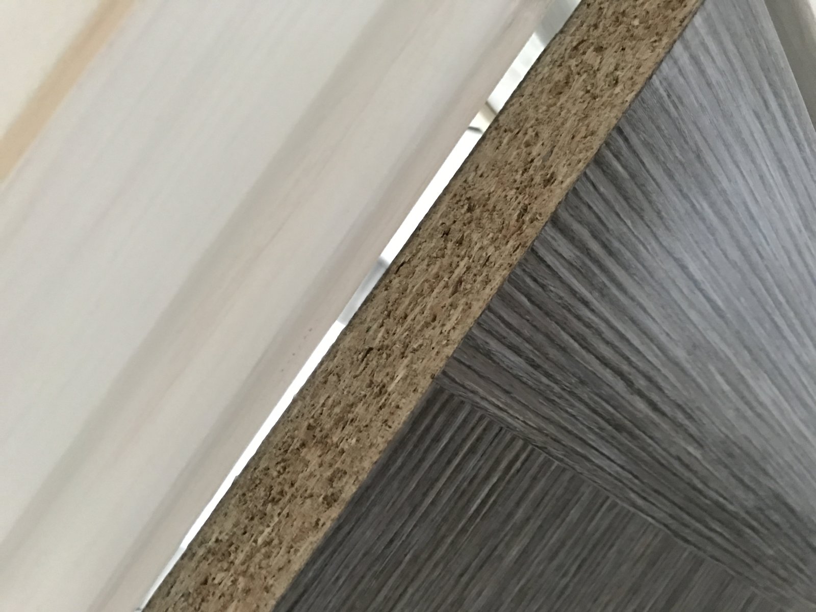

Is this right for an internal door?

Seems a bit poor to me being bare on the top and bottom
It's a Portfolio from Premdor
What about LPD? We like one of theirs called a Vancouver
To the untrained eye it looks a better quality:
just watch them doors if there the formica covered ones as are easily chipped and a pig to repair(always be seen)
You need to seal it, or it'll swell in the damp weather. You can use 2 part wood filler, or silicone sealant, or varnish.
I'm going to sell on the Premdor, it just seems like a **** worktop. It's a 762mm and it doesn't fit my 765mm opening whereas the LPD fits and seems more like a door.
