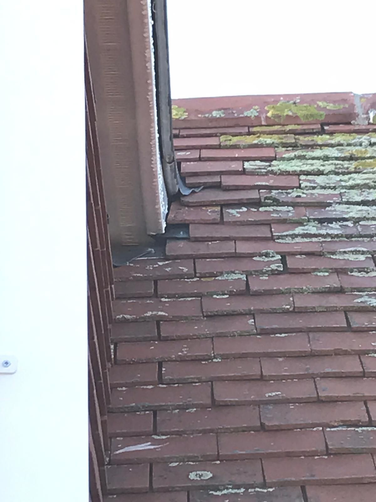

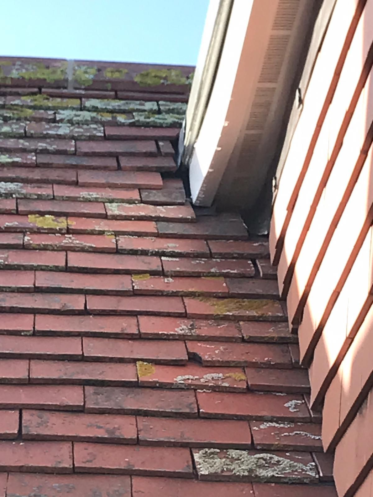

I've had a couple of window dormers built recently, The tiling around one of the dormers looks a bit rough at the dormer roof junction
. Please could any professional roofers on here give me their opinion as to wether the tiling is of acceptable quality or could it have been done better, many thanks
Untidy and careless. 25 mm cuts not acceptable any water getting into the soffit could run under the tiles. could do with tile and halves
thanks datarebal, I appreciate you giving your opinion which confirms my own thoughts even though I'm not a roofer.
What muppet puts in a slither of roof tile, as useful as a chocolate teapot
