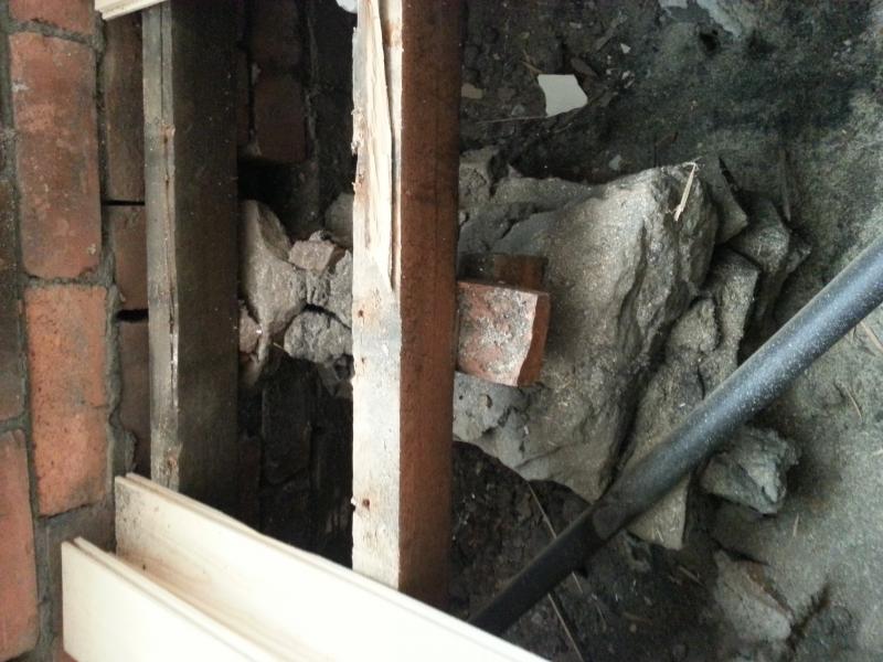

1. Do i replace the little joists like for like? They are 5cm by 7cm. I want to avoid removing bricks.
2. There is some sort of abomination that the two little joists rest on, would you suggest building a brick pier of some sort?

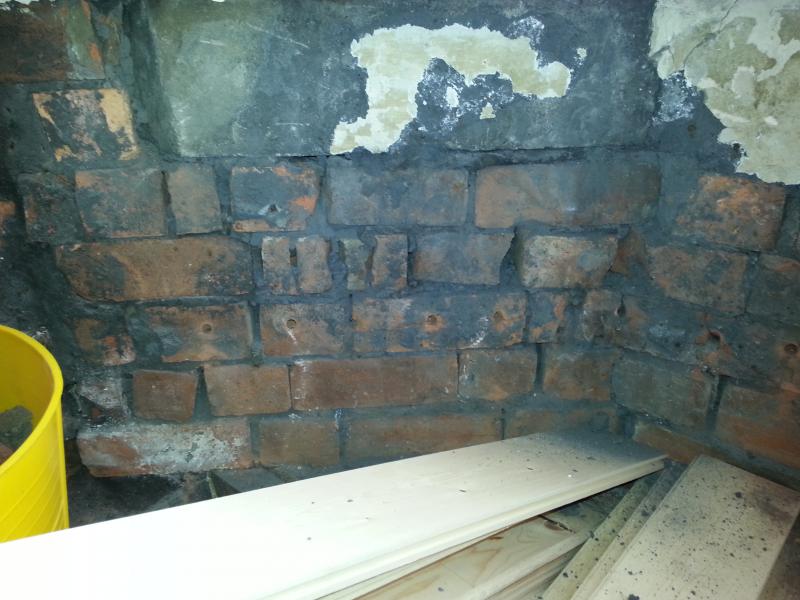

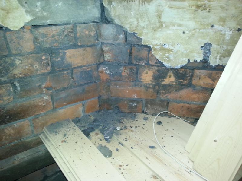

3. There are some loose bricks in the bay window, some large gaps and a line of bricks that have holes in them, liquid dpc? Do I point them and then use a 5:1:1 mixture of SLC? How would you apply this? Do you dampen the wall first? What thickness?

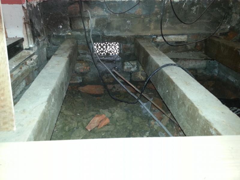

5. The air vents are of the iron type and have quite large holes, I have had mice and slugs, what mesh would you recommend and how best to attach to the vents.

1. You can replace them but you need to stop them from rotting again, make sure they dont sit directly on bricks, either use joist hangers on DPC
2. WOW. This is lovely... No idea what to do with it. I think what has happened is the floor started to sag so they have propped it up with those small joists, then they sagged so they put rocks under it. I think the proper solution is to have the joists reinforced or tied together with proper nogging. Cant see any reason for that other than a sagging floor
3. Looks like injected DPC. Just repoint, if needed take the bricks out and motar them back in

5. Remove and replace with plastic ones from B&Q or wickes. You will need 2 modern vents to replace one old iron one

1. How would I reinforce the little joists? Would they not need supporting from underneath?
2. I would like to keep the iron vents, I am able to reach them from inside the room in order to put mesh on.
3. If I were to put the larger joists on hangers, would that not entail more work? The joists are on a brick ledge at the moment.
4. There is a lot of soil, rubble under the sub floor, do I remove as much as possible in order to aid air circulation?
vents are far to low,rain water will be getting in.
remove old 1s,brick up and install new 1s 6" above outside level.this avoids splash.
Thanks gregers,
If i did replace new for old 6 inches higher, what about inside the room? the height of vent would be same height as skirting board. how could i get around that issue?
