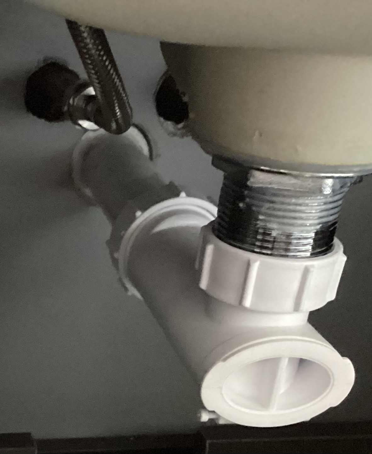

Just had a new sink fitted and opened the unit drawer expecting to see a trap but saw this instead. What is it and does it replace the usual trap? Thank you.
Order online at Screwfix.com. Shallow self-closing waste valve allows discharge to flow freely whilst preventing foul odour or sewer gas entering the building. Easy to clean with no need to disassemble the discharge pipework. Will not dry out through evaporation or lack of use. Designed to allow...
