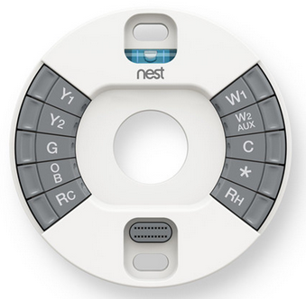

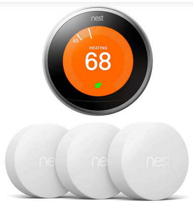

I didn't know nest has

Didn't know nest was a thermostat/zone system only. That makes it pretty outdated today.
