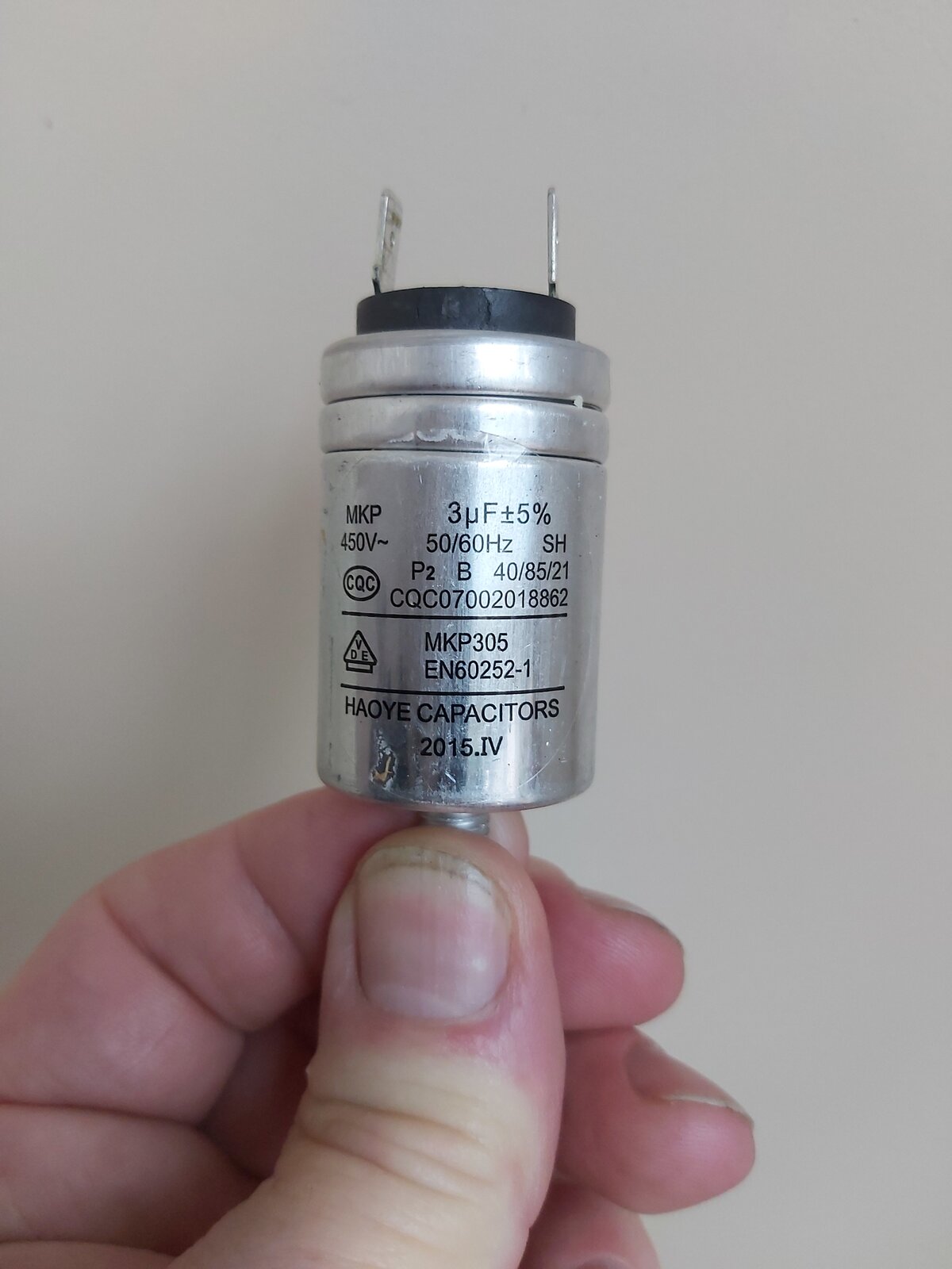

Was your original capacitor metal cased and replaced with a plastic cased one as linked? The capacitor on my KID60B16 is metal so I don't know if it's a direct substitute?

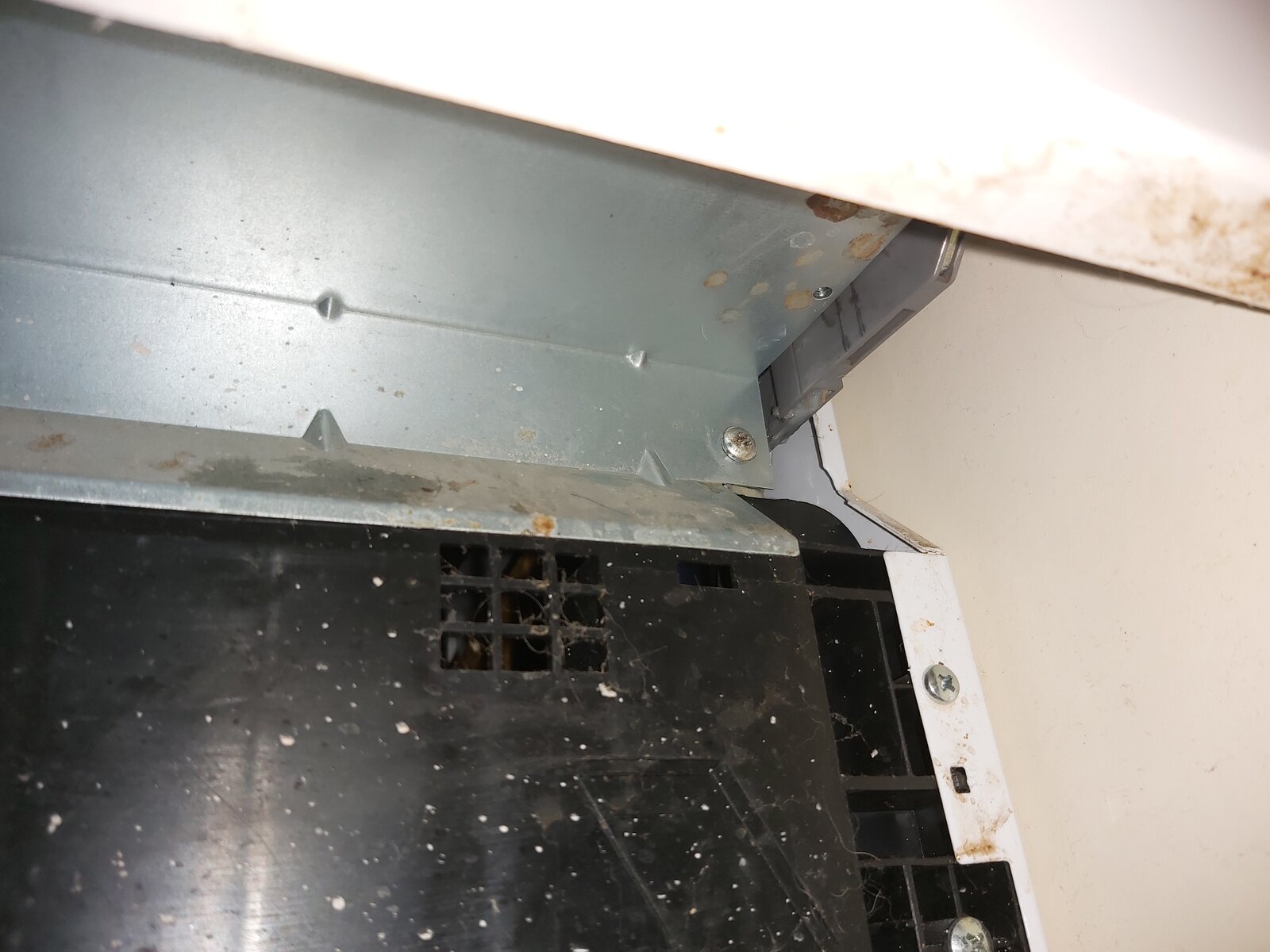

The metal panel to remove is hidden behind the bottom edge of the front door trim panel that is fitted to match your kitchen cupboard doors (See attached photo of front RH corner looking up from the floor). It is fitted just above the plastic chassis.
I took the rh side panel off to get to the wires at the end and to have more space to remove and refit the new capacitor.
The capacitor as fitted is a metal one (see second picture) but the replacement is indeed plastic.

Thanks again BJW64 - my unit looks the same at the front bottom as yours. I wasn't able to confidently access the capacitor from the front or sides. So I ended up tipping it and accessed via the bottom. There is actually a bottom plastic panel - silly me for thinking the chassis is one whole unit. Once that's open (held by clips) and anti-flood wire removed, it was a piece of cake to get to the capacitor. My capacitor is identical to yours. So i just ordered a CPC one.
