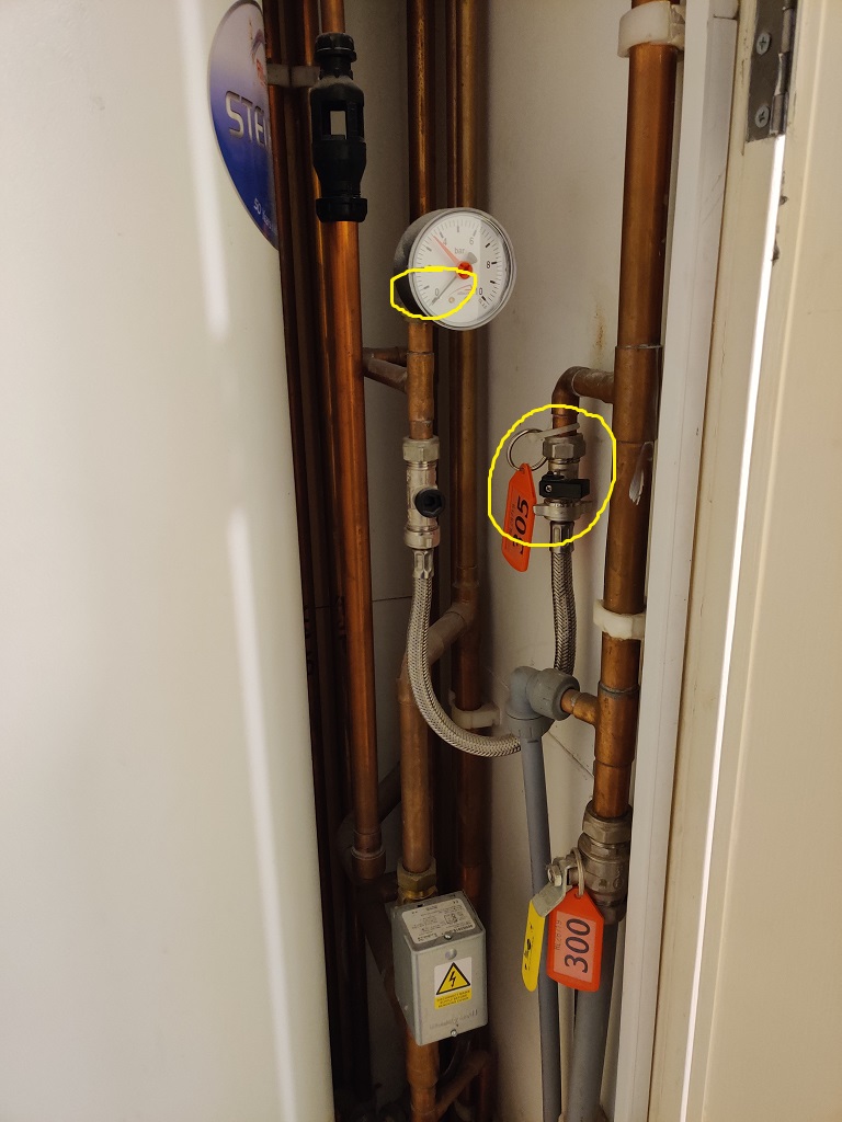

Moved into a house with a Keston Qudos 28s.
Has been working OKish for a year (sometimes hasn't turned on)
Now, I have error codes E67 and E26, both relating to low pressure.
I have found on another floor next to the immersion heater what appears to be a top up loop.
When I open it, I can get the pressure to above 1 bar (shown on the LCD display), but it slowly goes back to 0.
The pressure relief value on the boiler feels a bit funny to turn so i am guessing it could be this is broken?
Am I correct in thinking that these should be sprung, as it doesn't feel like it?
Anything else it could be?
The manual refers to the correct topping up procedure but doesn't mention what that is.
I've highlighted what I assume is the top up loop.

The PRV will feel funny to turn its not a valve in the traditional sense , it has a spring that actually works the valve without knowing the type of valve fitted it could be a adjustable one or fixed pressure one. But once triggered that can be a b ugger to reset themselves.
Firstly I would check that water is not now leaking passed the prv, you will need to find where the pipe attached to the prv goes and look for out flow. Pressurise the system by turning on the valve below the pressure dial next to the tank and then the valve on the cold water feed nad then check the prv exit pipe for drippage.
Wth a bit of pressure bleed all the rads, make sure that you do it when the system is off.
Lets see where that gets to.

sadly you have a very poor boiler, they are notorious for that exact symptom, I know you inherited it, but you really shouldnt be operating it with the casing removed, it is a competition between Keston and Ferroli to win the worst boiler manufacturer competition

Its relatively accessible, however the current boiler is 28cm in depth in a cupboard of 31.5cm depth, so possibly the depth could limit the choice of replacement without building work?
