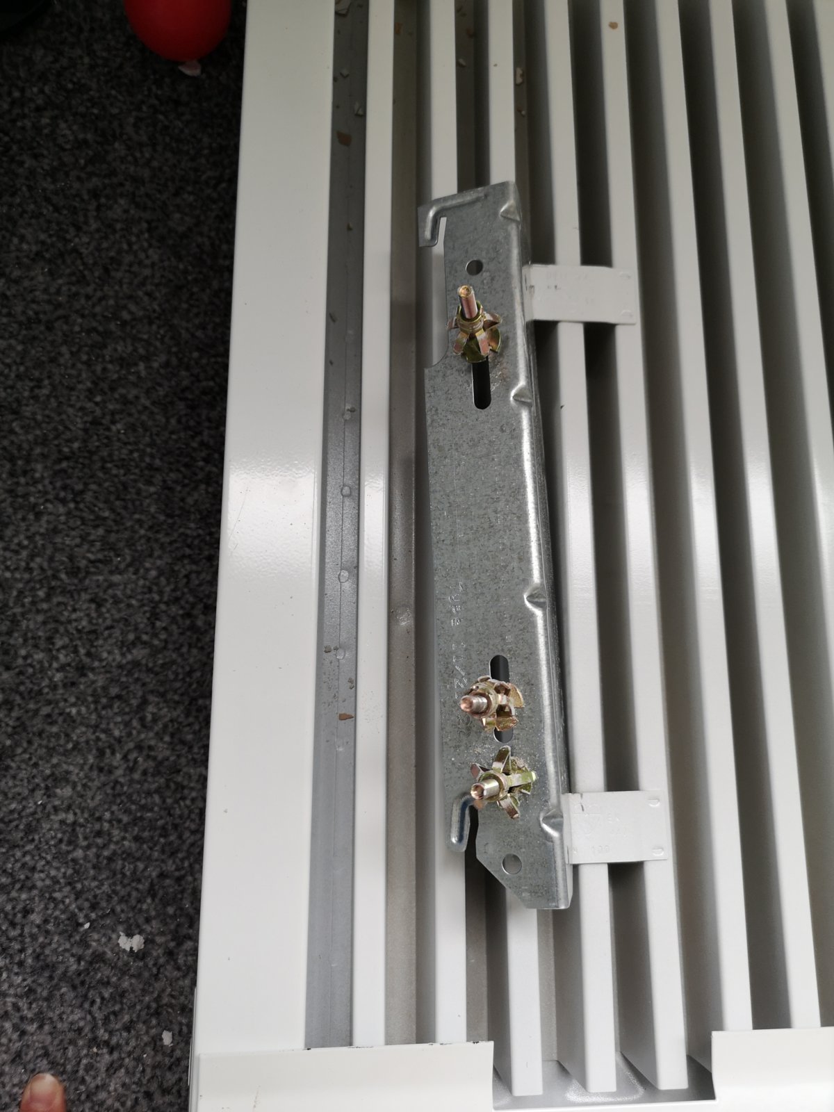

I looks like Interset fixings were originally used. AFAIK they have have a much higher load bearing than a spring toggle. Or do you mean use the spring toggles with the existing (enlarged) holes.
Mind you, it looks like they didn't tighten the intersets sufficiently. 2 out of three of them don't seem to be fully expanded.

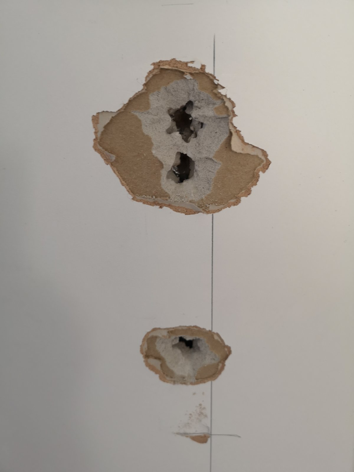

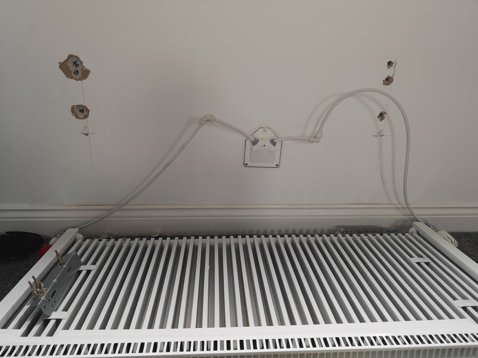

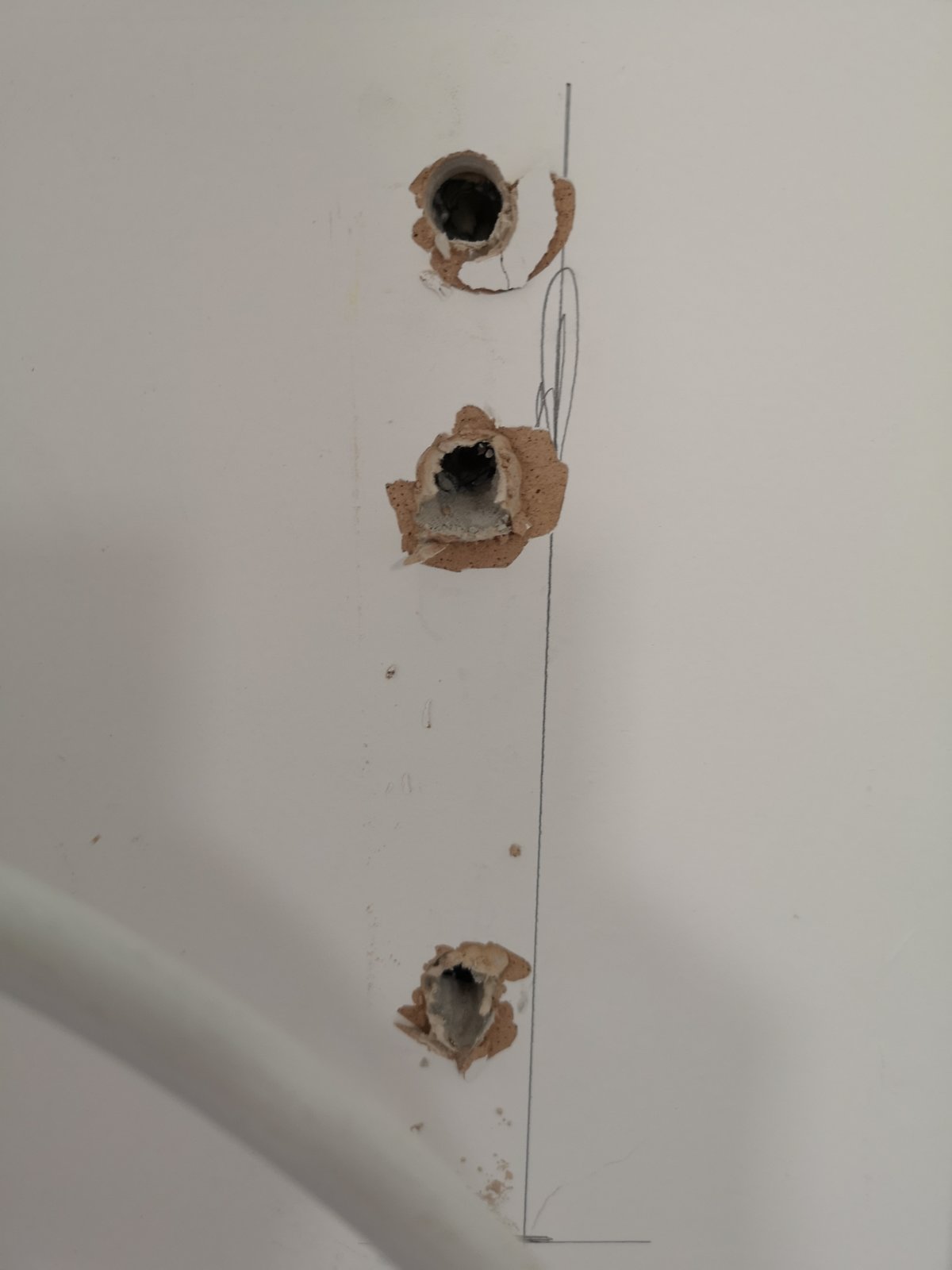

Hello,
I need some advice please. My kids have successfully managed to pull the radiator off the plasterboard wall (I am assuming it is plasterboard since it sounds hollow when you knock on it) in the playroom and it is currently laying on the floor. Fortunately the pipes are plastic and flexible so there are no leaks.
I obviously want to fix it asap to avoid any further issues, but am not sure the best course of action. The radiator was affixed, aligned to the middle under a window and I really don't want to re-position it off-centre and lose the symmetry. Due to the amount of damage to the plasterboard when they pulled it off the wall, I don't think the option of using larger fixings in the existing holes will work.
Is there a way to repair the plasterboard so that I may re-drill and affix the radiator in the same place? If not, what other options exist?

You might get away with these, they're pretty strong. They need a 10mm dia hole if I remember right, with luck the existing holes are smaller.
https://www.screwfix.com/p/fischer-self-drill-plasterboard-fixings-metal-35mm-100-pack/47347
Judging by the pics it doesn't look like the expanding legs on the fixings got behind the plasterboard, or bigger holes would have been torn out. If that's the case the pullout force would be much reduced. You mighty try the same type again, but make sure they're installed correctly.

I was under the impression that the self drill fixings that you linked to are for lightweight fixings.
I think there's a good chance the original fixings weren't installed properly, but even so they took the vertical load OK, it was the pullout that did for them. If installed right there's a good chance that type or the ones on my link would be OK. Worth a try and if it comes off again do something else. Hopefully by the time the kids get much stronger they'll have more sense!

But if your house has plasterboard walls (like my youngest son for example) without going to a lot of trouble you're stuck with it. The battens are unlikely to be at convenient locations. Just have to use, correctly,the most suitable fixings, ie ones that work best with the relarively weak plasterboard. It will clearly take vertical loads OK. Youngest has some as in my link, and I was surprised how solid they feel. I think that type would be worth a try, if the holes aren't already too big.
