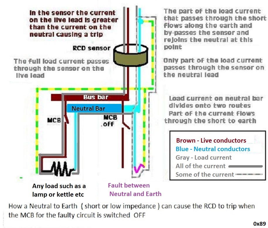

A Neutral to Earth fault in an appliance ( such as a damp outside lamp ) can result in tripping an RCD when another item is switched on. The faulty appliance can be turned OFF at the time.
When you say the outside lamp has been disconnected were both the Live and the Neutral disconnected. If the Neutral is still connected than the lamp could be the cause of the tripping

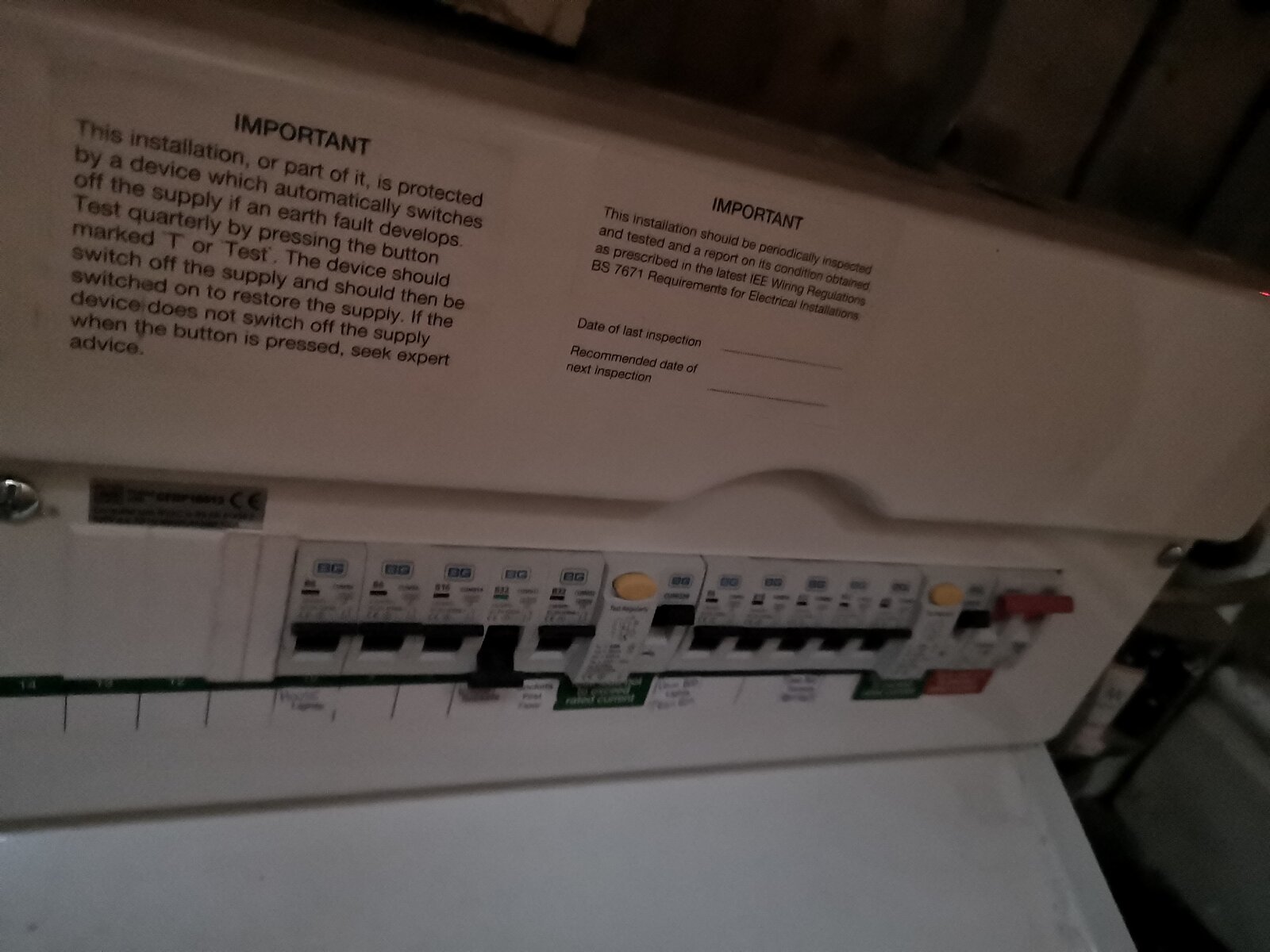

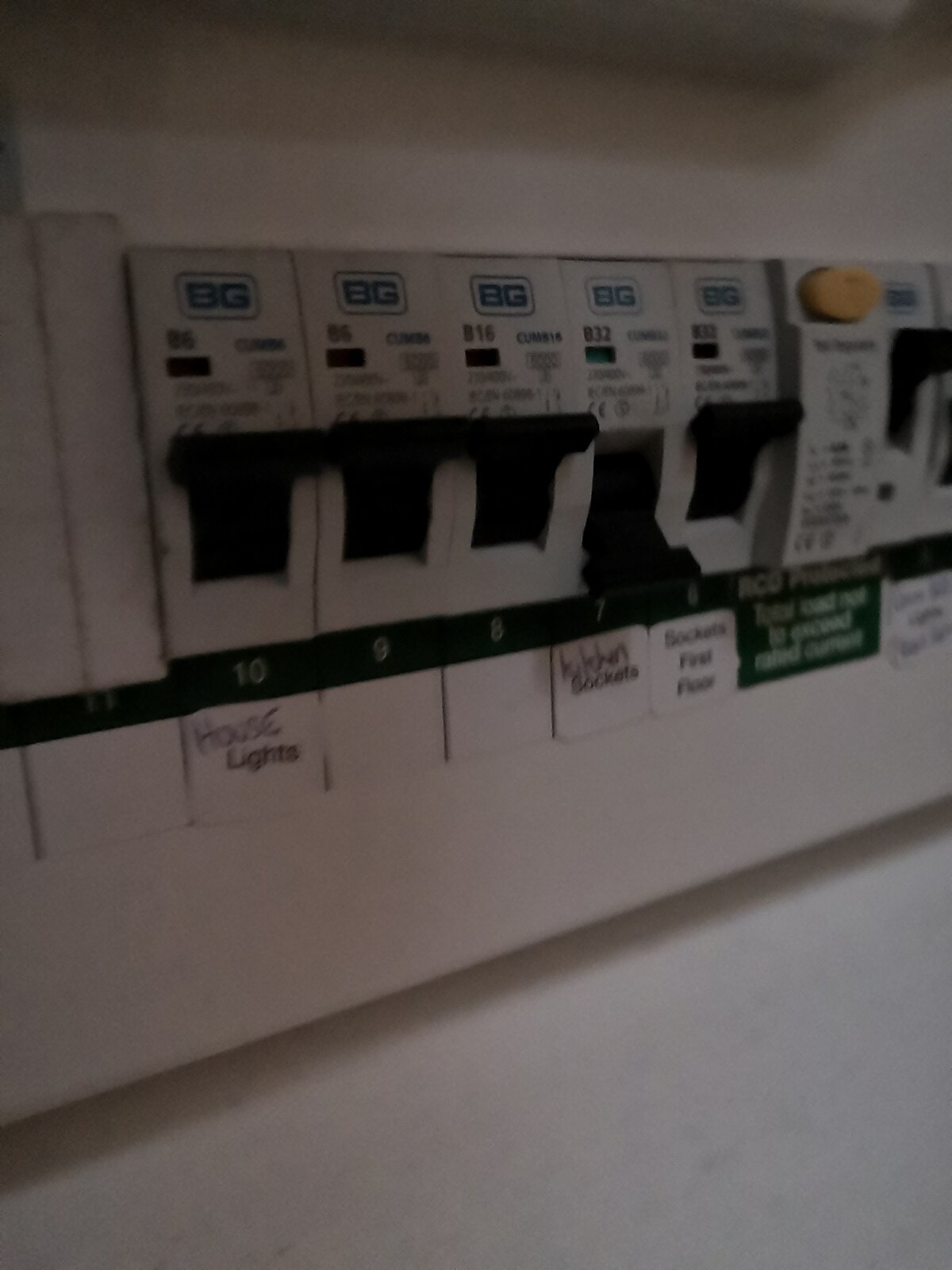

post a photo of your consumer unit ("fusebox") with flap open so we can read the circuit labels, and the letters and numbers on the breakers.
and the meter and surrounding devices and cables
How old is the installation?
What do you mean about the power coming back on? On its own?
Hi, thanks for getting back to me. Have attached a couple of pictures of the unit. Also the electricity meter. I'm not sure on the age of the installation, we bought the house last year and it was here already. When it happens, we generally have to switch the 'kitchen sockets' switch down, and then all others will come back on. If we try to put it up, it will trip again. It usually happens at night, and generally, in the morning, we can then flick the kitchen back up, and all is OK. It's as if it has 'dried out' maybe? It then lasts for 12 hours, or a week!

Taped up wires in damp locations ( outdoors for example ) can still provide enough leakage via the damp tape to trip an RCD. Was the disconnection inside the house or inside the lamp ?
Hi, the disconnection was inside the house. When the electrician looked at it, he put wire caps on also.

OK so not the outside lamp. But still possibly a difficult to find Neutral to Earth fault coupled with the current load from some perfectly good appliance

The RCD thing goes and that means that everything on that side of the consumer unit goes off. The only way to get the RCD to stay up/on is to put the 'kitchen sockets' one down.
