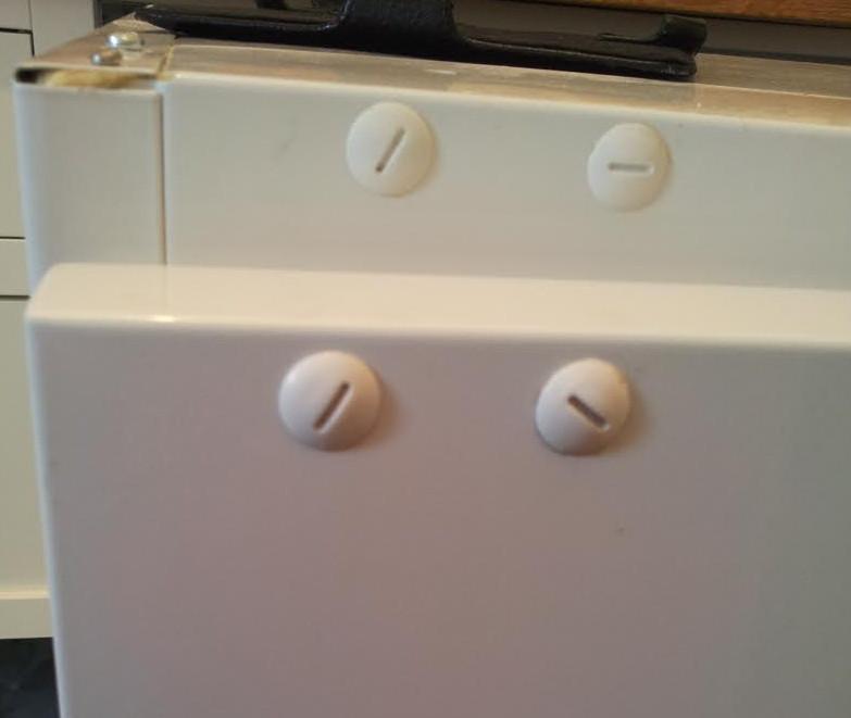

I need to put an integrated door on it now and am not sure what sort of mounting kit I need to get.
Here are photos of the screw holes (38mm apart) two at the top of the fridge door and two at the bottom

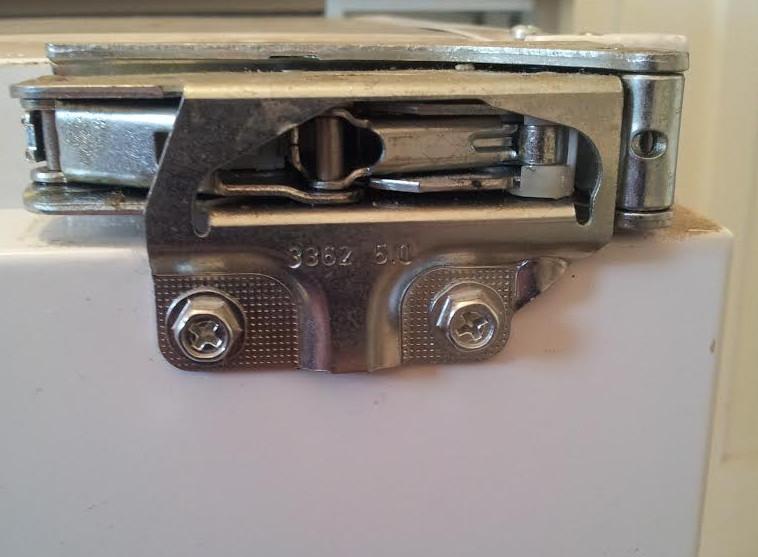

And the hinges, one top and one bottom
Is the door somehow fixed directly to the hinges?
Do I need some kind of slider mount where the screw holes are?
Those blanked off holes will be for if you want to move the hinges to the other side.
On our (different make) fridge, the external door sits proud of the fridge door using some angled brackets which screw to the inside of the exterior door and the side edges of the fridge door. Nothing slides. Can you see any holes on the sides of the fridge door?
EDIT: I think I know why you mentioned a sliding mount. If you were expecting to put a normal hinged door on the cabinet, that isn't the way it works. The cabinet door is independent of the cabinet carcass and is fixed firmly to the fridge door. It just looks like a normal unit door when it is closed. The fridge hinges are designed so the cabinet door doesn't snag as it opens.

It has screw holes in the top and bottom of the door. Thanks. I might have to improvise some brackets.
Yes, you're right, it makes sense now.
