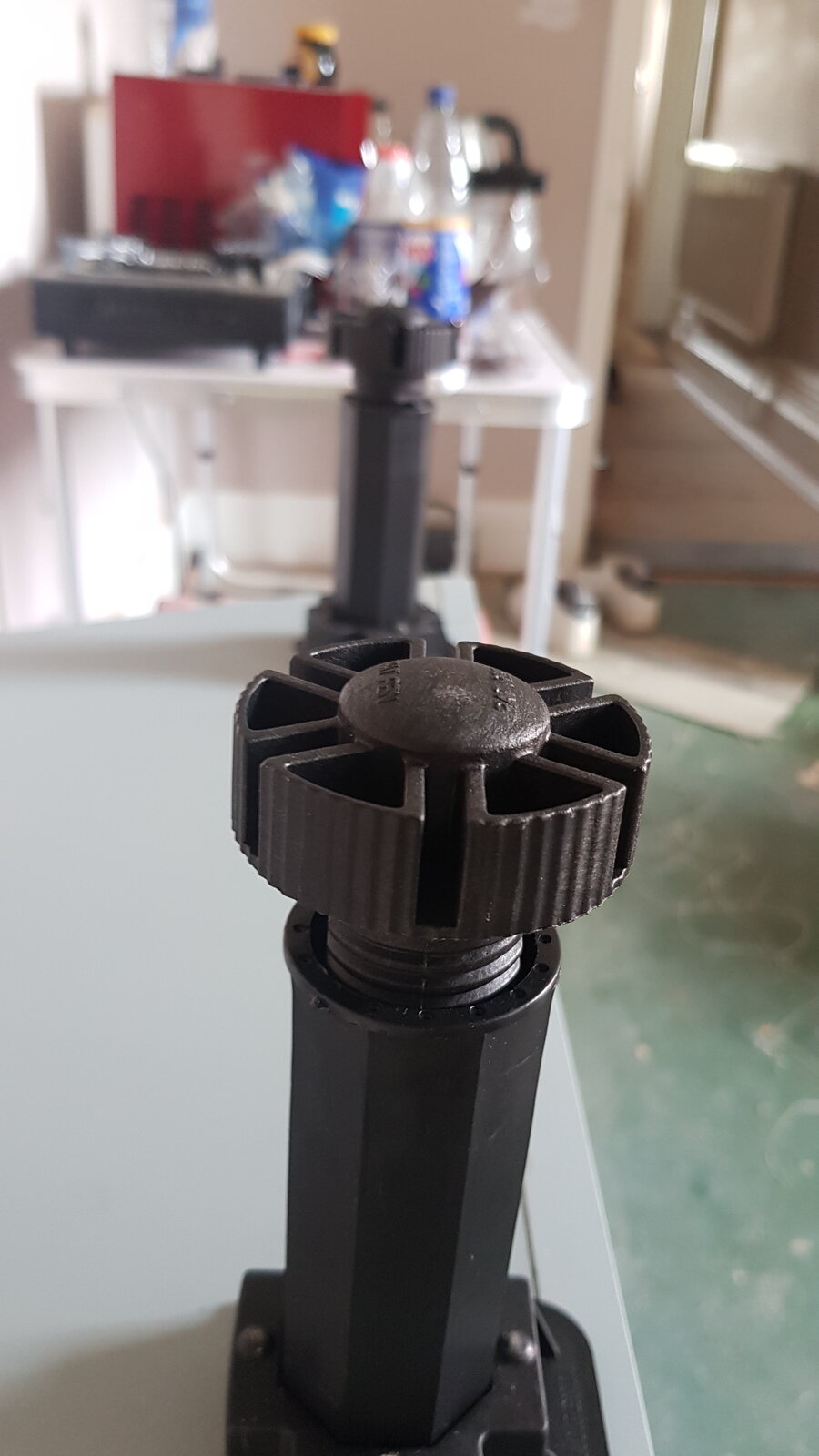

Just had kitchen units delivered, already prebuilt.
The unit legs, which are already fixed in position, are not flat on the bottom and therefore won't sit flat on the floor and I can't figure out why they are designed like this. Any ideas?
See pic
The round bottom foot design is not that uncommon in furniture. The wide section with grooves is not the foot at all, it is so designed so that you can jam a flat bladed screwdriver into a groove and turn the foot to adjust it up and down. Because access beneath cabinets, when installed, is limited, you need a few slots tobe able tomake fine adjustments
