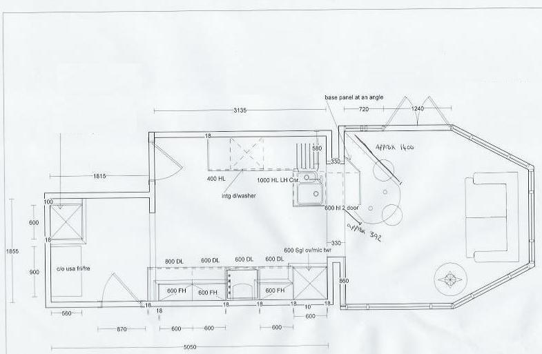

We are about to have a new kitchen installed, and as part of the design we have a large overhanging granite worktop which will be used as a breakfast bar.
I need some advise on suitable support mechanisms for the worktop, I'm particularly looking for something like a worktop leg, that will secure to both the granite and the floor we have a basic leg support on a kitchen unit at the moment, but its prone to getting knocked and doesn't fill me with confidence that such a mechanism even if using multiple legs would provide sufficient safety from the worktop collapsing
I've uploaded a plan view of the kitchen below, which provides some indication of the length of the overhang
Any advise would be appreciated
db - forget about the leg. Let the breakfast bar overhang 'hang' without any OBVIOUS means of support. However, install a couple of support struts below the granite fixed to the tops of the base unit carcases - cantilevers. These should be made from duralimin (aluminium alloy) and let into the top of the carcase so their top surfaces are flush ready to receive the granite. Positioned correctly they won't be seen but for the curious they will appear as polished silver thing that match the stainless steel cupboard handles. Of course you could just use a couple of lengths of angle iron painted black.

from the diagram it only leaves you with about 700-800 gap between the bar and the corner of the wall oposite..
much better idea to have the sink against the wall and leave it open at the end.. use the space for a dining table.. 4 seater.. much more practical..
how set are you against a little building work?
the door to the top left of the diagram.. could it not be moved to the wall next to the fridge (1815 wall.. )
that way you can have a straight run of cabinets along that sink / dishwasher wall? possibly leave a window for light..
does that 3135 wall back onto something? does it have a window?
The 3135 length of wall backs onto the dining room, so there is no window.
The window historically would have been between where the sink is positioned in the diagram and the oven unit, but this now opens out into the conservatory (something we inherited when we bought the house).
As for the angle of the granite, I don't think its set at this point, it was more to give an indication of how it might look (the kitchen unit supplier that did the CAD drawings can't cope with anything non standard). So we will work with the positions and sizings with the granite supplier once the units are in.
We are planning on having a small table and chairs in the conservatory area (again kitchen planner stuck a sofa in the diagram), and its intended use is a breakfast room, as we have a dining room elsewhere in the house.
Hadn't considered moving the door into the kitchen, but has given me food for thought, on the wall where you propose it coming in is the radiator for the hallway, but as we are moving rads in the kitchen anyhow moving one more isnt too much of an issue. The only concern would be the opening as it will either block the access from the current utility area into the kitchen, or open up against the fridge.

took the liberty...
Chrome / black adjustable legs are easily available, many of the diy sheds stock them.
What I'm after though is something which secures to the floor as well as the worktop, we have a chrome adjustable leg in the existing kitchen, and its prone to moving if knocked...
