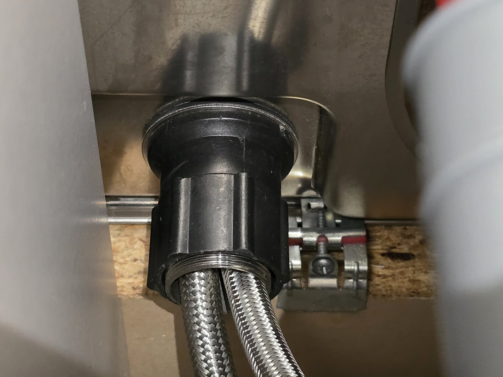

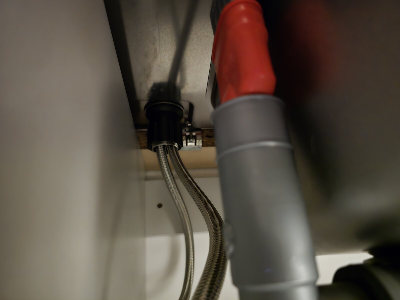

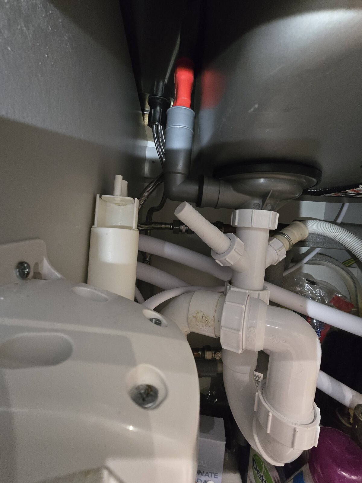

Very new here and wanted a bit of advice if possible.
I'm trying to install a new Kitchen Mixer Tap, however cant seem to get the fastener off the old existing one. Pictures attached. the area available to work in is very restrictive and limited. Cant even get a wrench in as its quite a tight squeeze. Wondered if anyone can offer some advice or tools to help loosen this fastener to the kitchen tap.
Regards
A frustrated one

Looks like it’s only hand tight. Gap in the cupboard at the top and feed tool through? Grip plastic nut with one hand and turn the top of the tap with the other?

Tried with a small wrench. It's really tight and barely has any room to twist.
Supposedly it's hand grip but it's really tight. Suppose it's been tightened with tool. The water softener piping in front doesn't help to give any room to exert force when twisting.

That big nut is hand tight only.
If you can't twist the tap whilst holding the nut, spray some WD40 on the top of the thread and wait 10 minutes.
You might be able to unscrew the flexis just by turning them; they get their seal from a rubber O ring rather than being tightened so hand nip can be sufficient. Once they're out of the way access to the big nut should be easier with a tool, perhaps even a large hex socket
