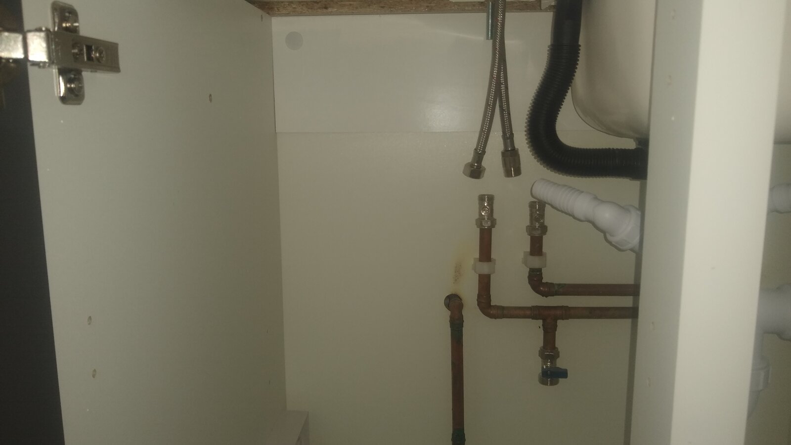

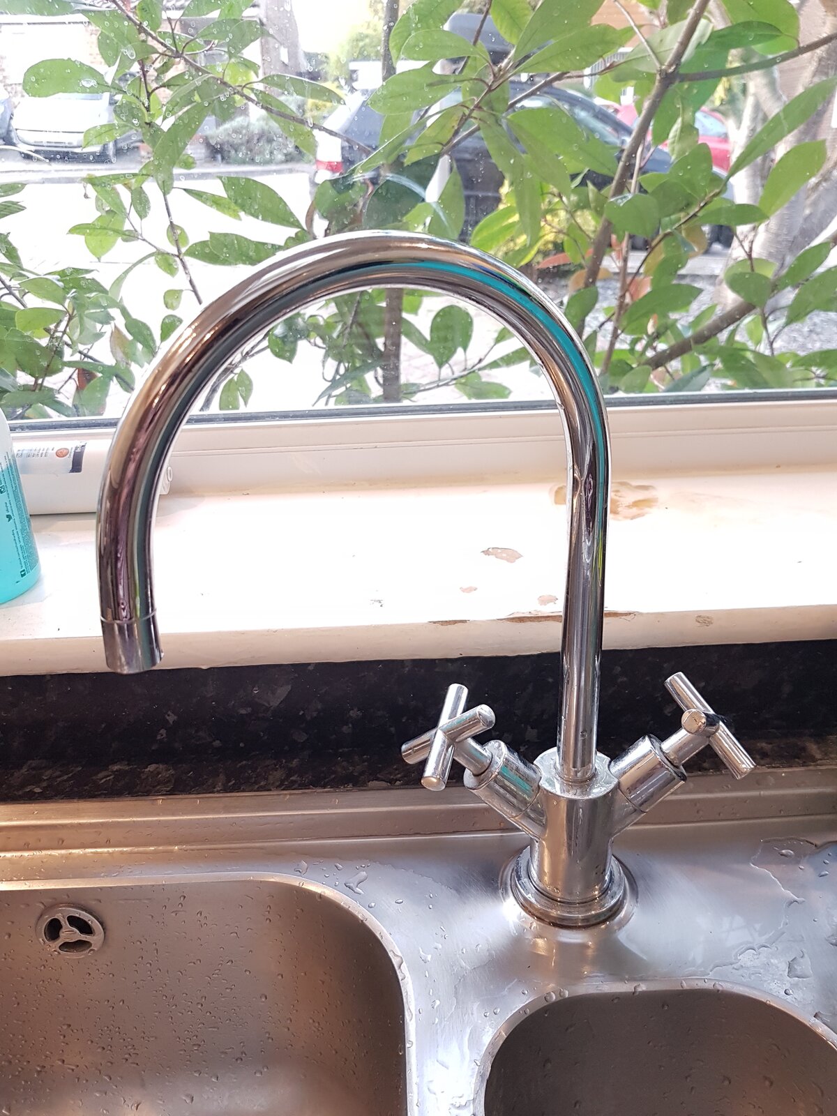

However, casting an eye over our current tap (picture attached), it seems to me that it is not dual flow, becuase when I turn on the hot water, the spout gets very hot? Does this mean it is definately single flow?

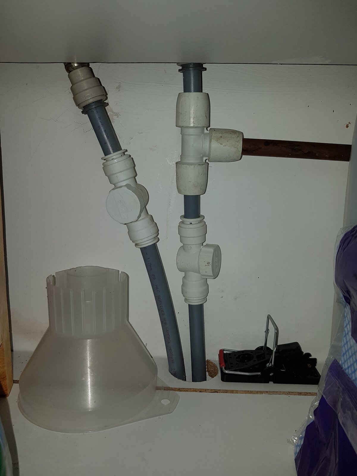

We have never had any issues with this tap, we've always been able to get a nice temperature for washing up, cold water flow is fine. Looking underneith the sink, do those white isolating valves also incorperate a non return valve? Is that why I'm not having any problems?

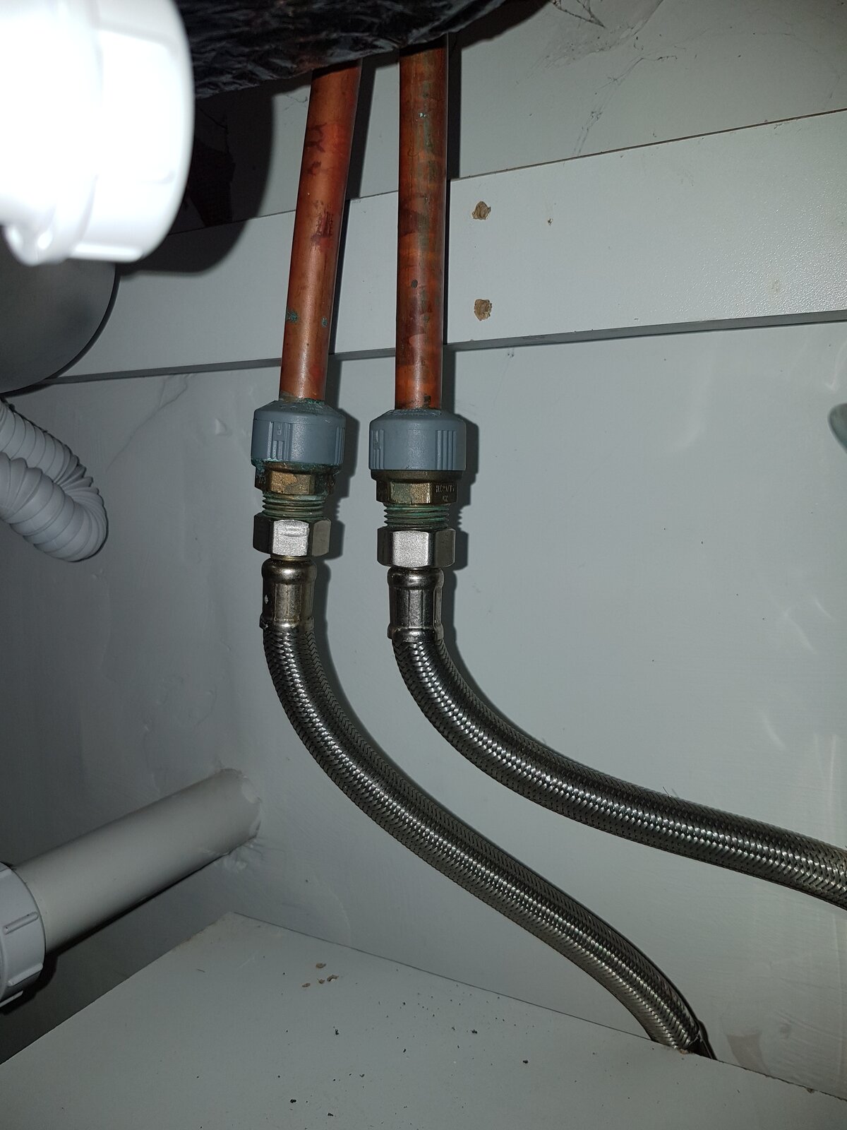

You don't have NRV's fitted, the white plastic valves are just JG push fit isolation valves. The 2 flexi pipes you have fitted will be restricting the flow.
Your cold mains pressure may not be much higher than your gravity hot water ergo you're not seeing much impact in a single flow tap but some see issue from mix in the body taps and some don't, it's usually where the cold mains pressure is much higher.
Single level monobloc taps have a cartridge with typically narrow water ways and tend to be classed as HP (high pressure). Fitting NRV's on the hot side can sometimes sort it but they can also restrict the flow. Some taps are now shipping with a tap tail that has an NRV already incorporated .... the right hand flexi in this pic.

1. Your existing one is a dual flow tap.
2. Normally the cold flows around the outside of the inner tube, and the inner tube carries the hot.
3. However, if it is connected the wrong way round, the spout will get hot even if you are running mixed hot and cold.
4. The outer may also get hot by heat radiation, particularly with a metal spout end.

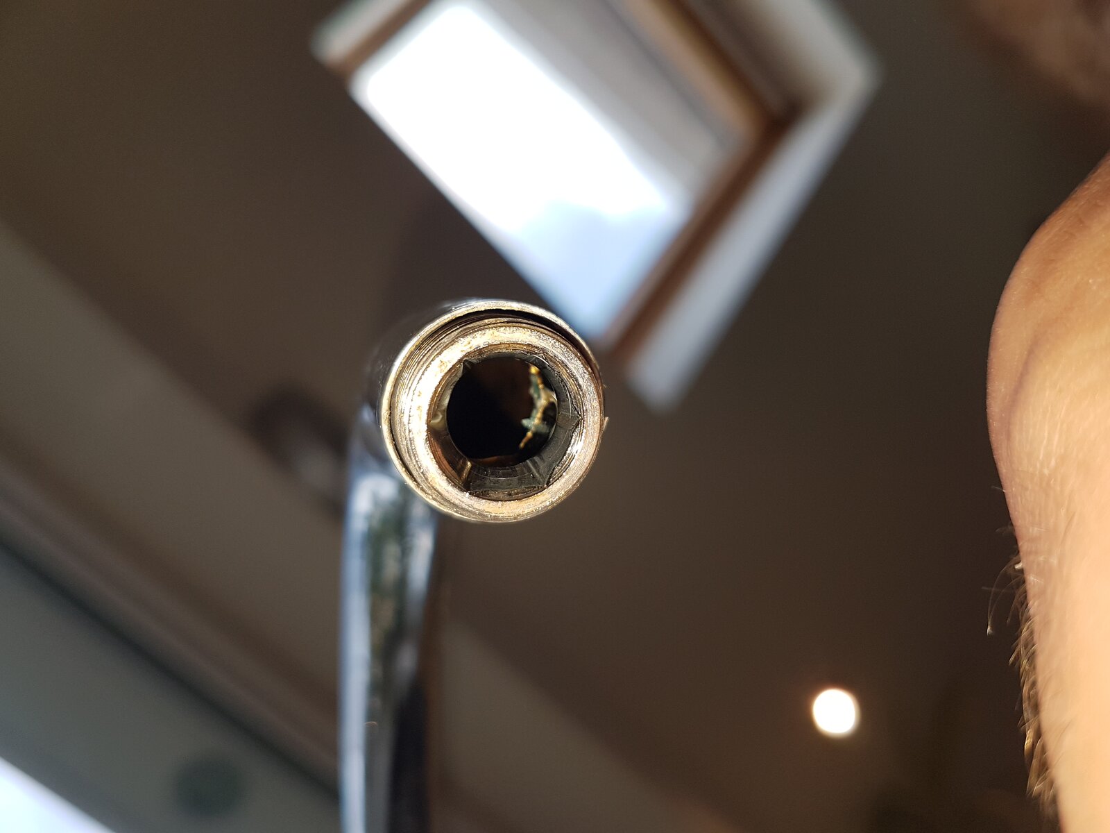

You're definitely sure it's a dual flow tap? Is there any other way to check? I've tried looking up the spout but I can't see anything.
If you unscrew the aerator off the end of the spout, you should be able to see 2 distinct pipes, the outer and an inner pipe. I must be honest I though, I would have lent more towards it being a mix in the body type, single flow, but it should be easy to check.
Is it 1/4 turn valves?
Thanks, that's exactly what I tried to do and I couldn't see any evidence of two distinct pipes, I could only see one dark hole... Yes they are quarter turn valves.
I think this proves its not dual flow, I shone a torch up and could only see one large hole for at least 4-5cm up the spout.
Plus, running hot water only makes the spout very hot, but it cools immediately as soon as you turn on the cold.
