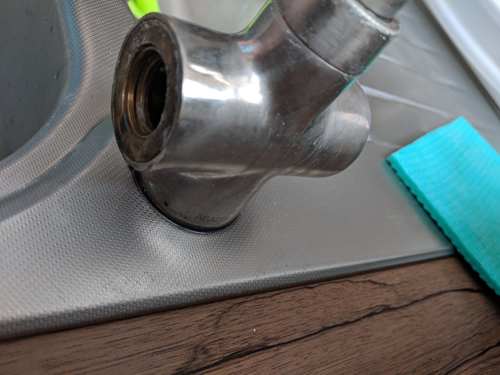

Our kitchen tap seems to have a slow leak. It seems to be coming out somewhere on the cold water side although the I can't see any washers I need to replace any ideas?
Also there seems to be water building up at the top of the mixer part.

The tap leaks slowly when the taps turned on. Once off it's fine or so we think after drying the water around the tap nothing more comes out in the off position.
I was worried I was going to have to undo the screws under the sink to get the swivel part off as there's no grub at the back of it I'll try turning it 90 degrees first

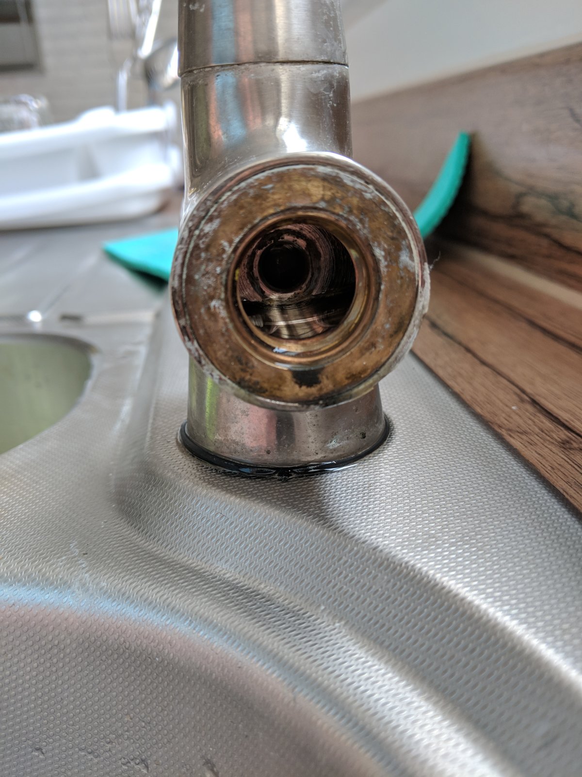

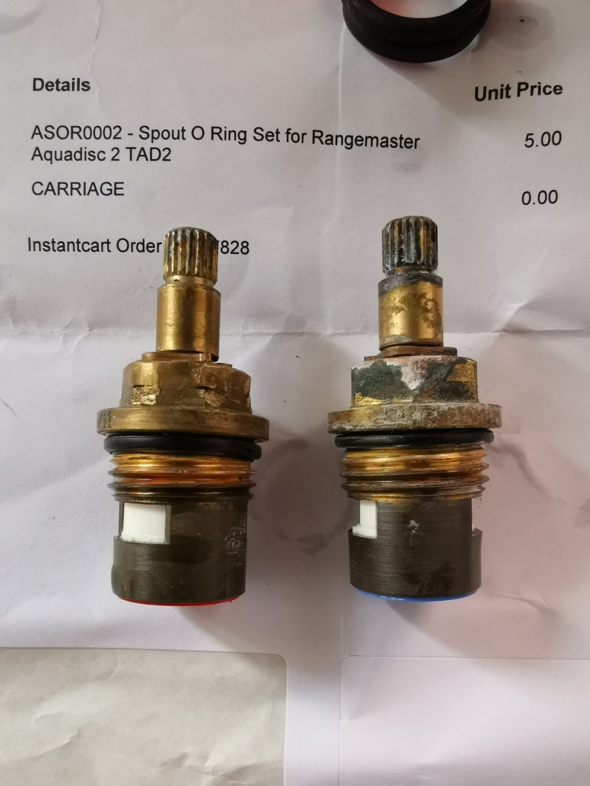

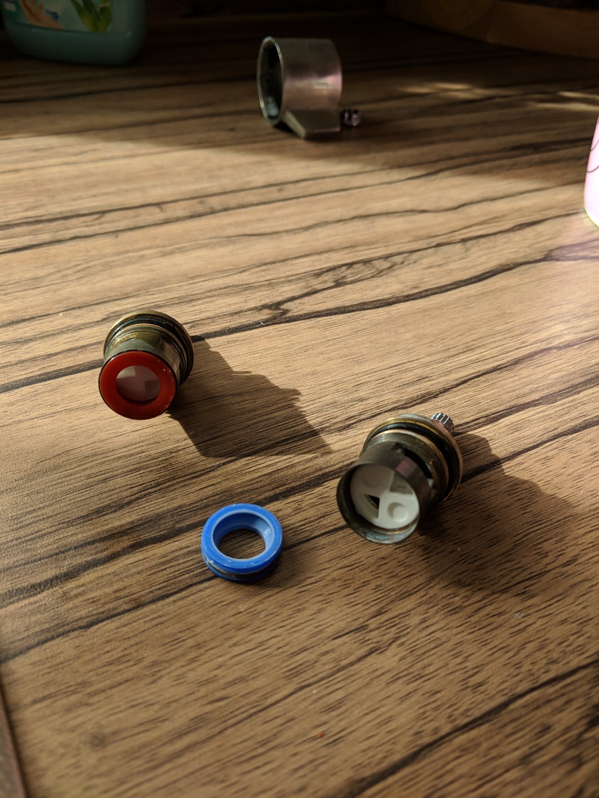

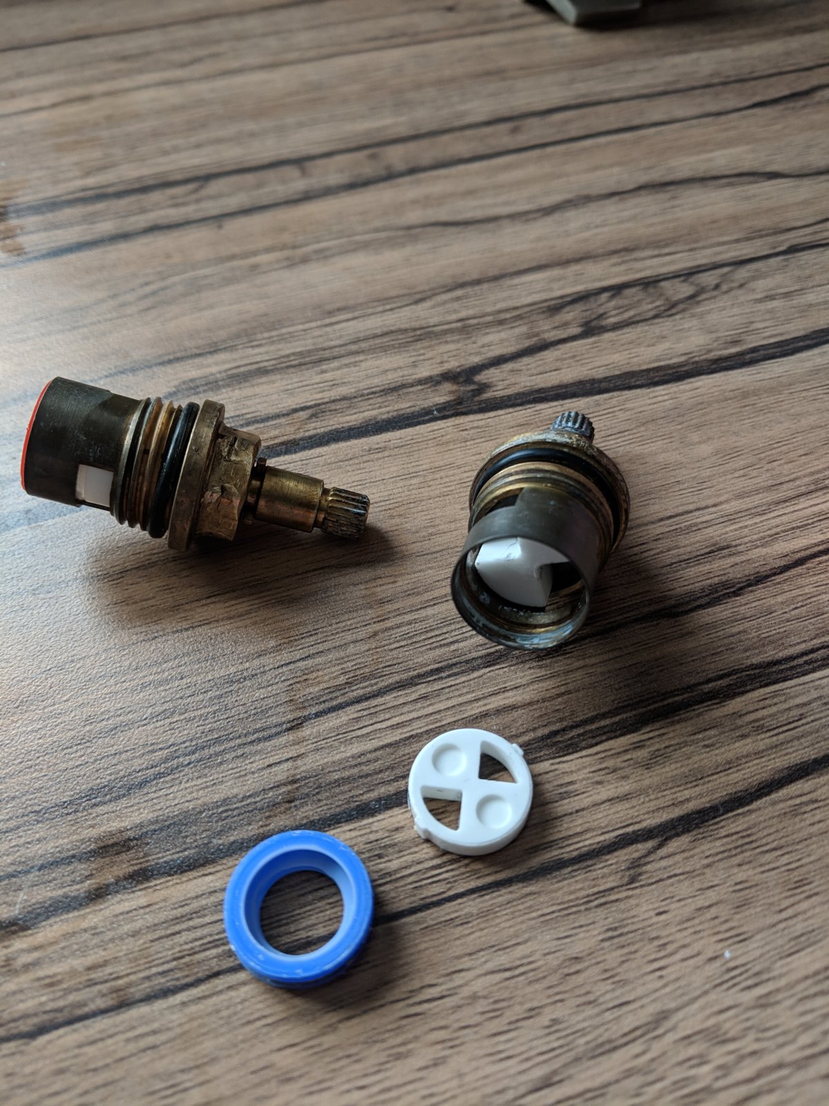

Right taken out the tap cartridges is there any way to tell if there damaged?
Also the only marking on them is by the brass bit which says SMR 09/11,i take it that's the cartridge size i want to order?
There about 52mm in length

1. No, there is no way to tell by inspection. The seal is between the two mating flat surfaces of the ceramic discs, and;
1a. You'd need a good microscope to detect flaws in the mating surfaces.
1b. They often leak because the blue / red silicone rubber washers have worn. It's the compression of these washer which pushes the ceramic seals together.
2. Now you've got them out, consider replacing them anyway.
3. It's the spout that is leaking, you have to find the way to get it out. Try as mentioned earlier, or maybe that shroud at the base of the tap end of the spout unscrews / twists and comes off?

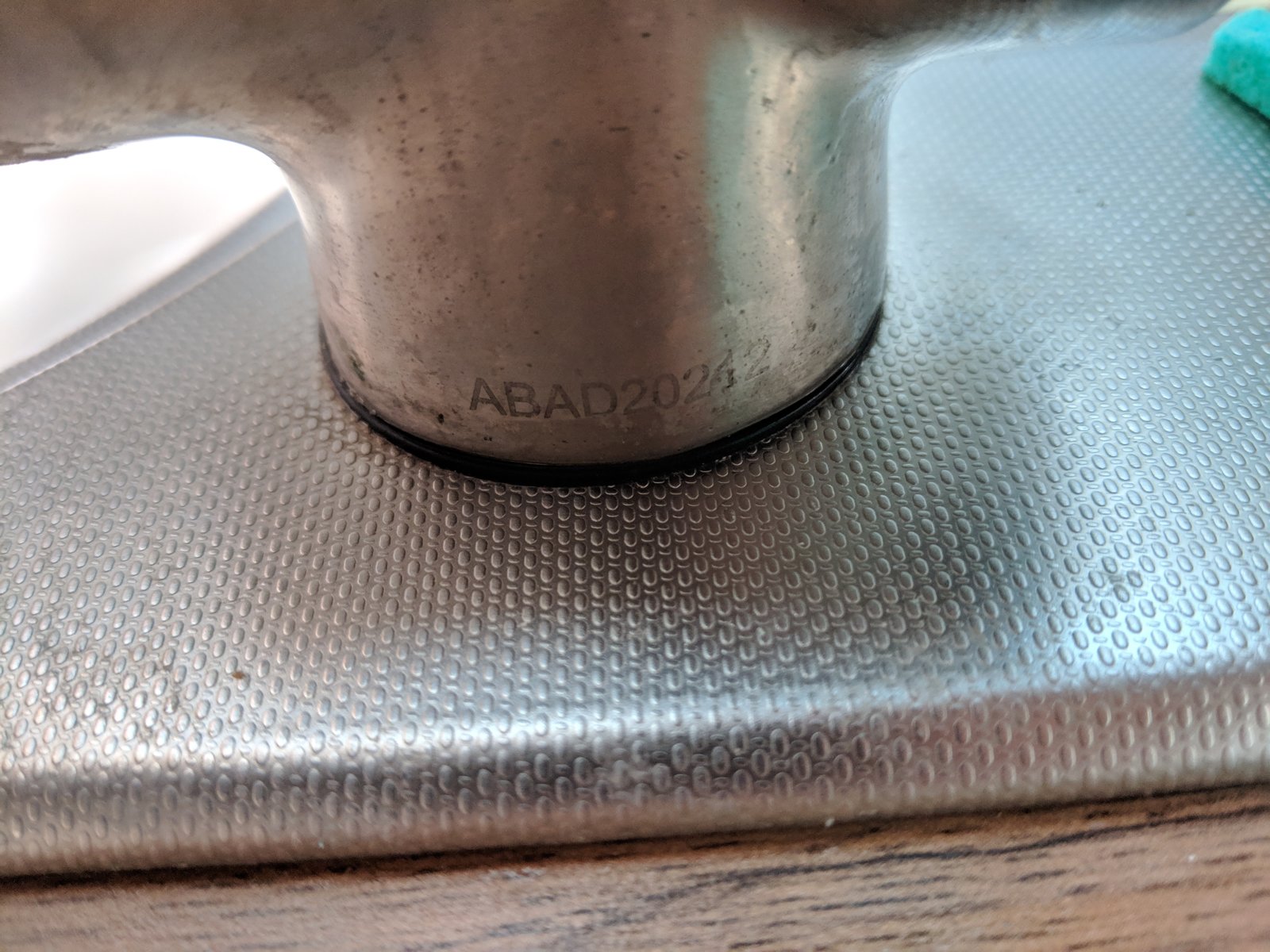

4. There appears to be a model / make etched into the rear of the base of the tap. "ABAD2--" is visible, what does the whole thing say?
5. Get the make and model and you may find instructions on the internet.

Great spot didn't even see the letters on the base of the tap.
I think it says ABAD20212 but a google search brings nothing up

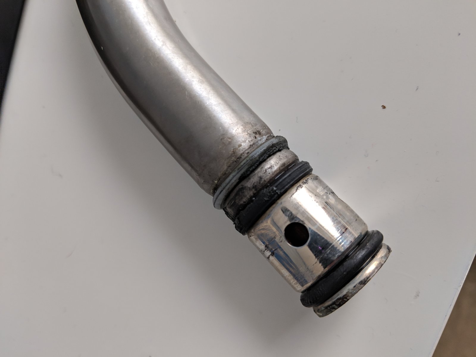

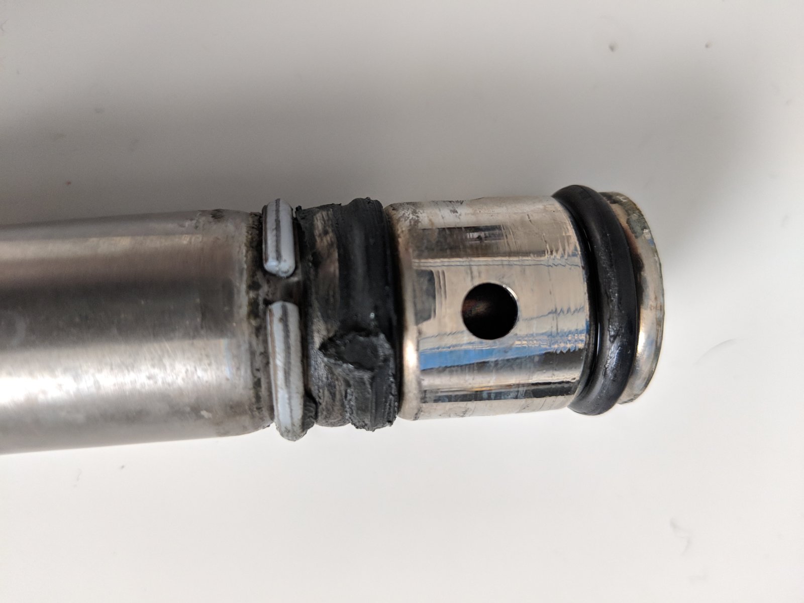

Managed to get the spout off,from what i can see the seals look fine?
From what i can see that looks like my tap
https://www.tap-spares.com/p/Genoa-Cruciform-Monobloc_313.html
1. The upper black rubber O ring seal looks damaged.
2. I don't think its a Genoa, the round part of the handles appear parallel throughout their length, the Genoa are cone shaped.
3. If you have access to a vernier or digital caliper:
3a. Remove the bottom O ring.
3b. Measure the diameter of its seating in the spout.
3c. Measure the thickness of the rubber O ring
3d. See if you can get a pair of O rings to match.
4. Otherwise try getting a set of the spout seals for a Genoa or Akron (they are the same), and see if they fit. No guarantees.

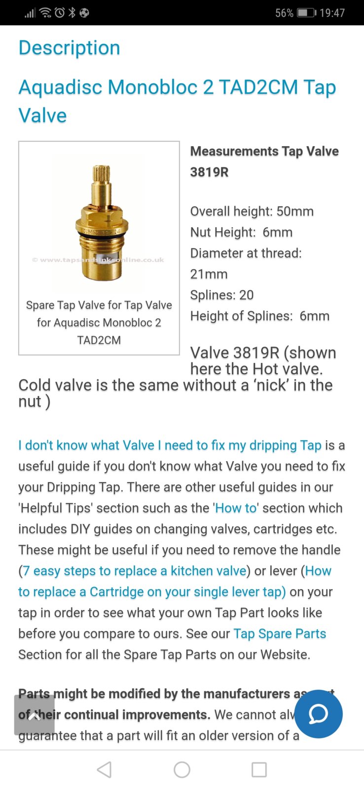

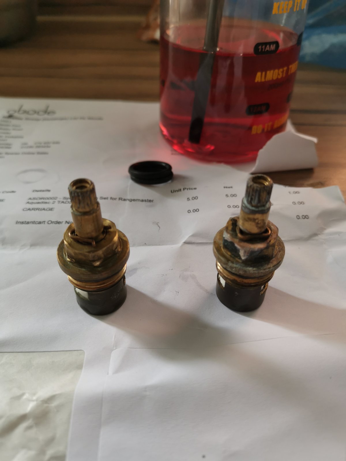

So thought I'd update its started to leak again I changed the o rings last time but it looks like the cartridge has slight cracks in on the cold tap.
You can see in the pics the cold valve is covered in limescale
I'm hoping I can get away with the bristan ones from screw fix although knowing my luck the size will be slightly out
Sorry didn't see the last photo til just :oops:

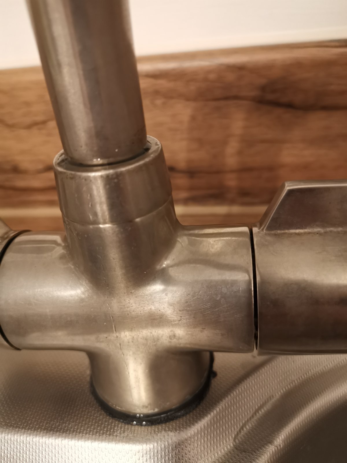

Taps are about 6 years old tbh the Mrs wants new taps and a sink, with it always looking dirty but that's partly down to the tap leaking, cleaned them all up today no more limescale just need to stop the dripping on the cold side, plus its still leaking from the middle spout
