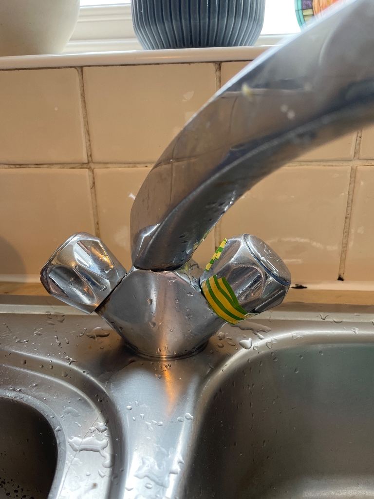

Hi there
I am going to have an attempt at replacing my mixer kitchen tap as I am getting some leakage around the knobs when the taps are turned on. Just a bit of a drip that can build up over time but it stops when the taps are turned off. Anyway I have no real experience of plumbing apart from replacing a few parts in the toilet.
I have purchased what I believe to be all the tools I need to do the job. I had purchased box spanners thinking it would have a nut to remove under the tap but this is not the case. I have already had another surprise realising the cold flexi hose has a check valve on the end and won't attach to my isolation valves I am fitting.
So I would really appreciate advice how to remove the tap. If I can't remove that then I haven't a hope of completing this job.

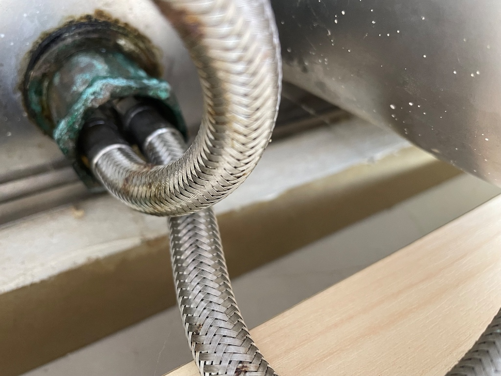

It looks as though you unscrew the large nut shapped object and slide it down over the flexi pipes as you lift the tap out. Once you have done that you should be able to relase the push fit flexis I think

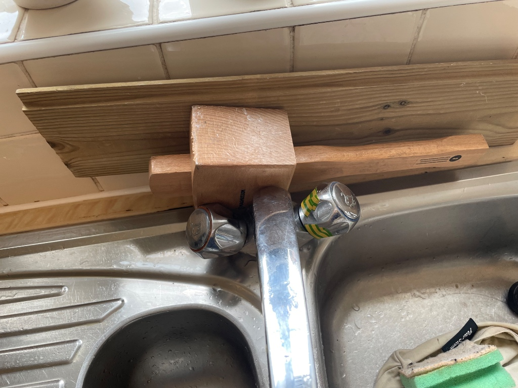

Yeah I am just trying to figure out how to unscrew it. I can see if I twist the tap from above this nut shaped object also twists. I have sprayed WD40 on it and seeing if I can get to it with a basin wrench. It is really tricky to get to. The usual I am sure with plumbing jobs!
I am trying to wedge the top of the tap like this so I can try and make it budge underneath. I am working solo which probably doesn't help
Can you grip the nut underneath and turn the tap at the same time? Or twist the tap from above until it hits the tiles/wood or mallet and then keep turning from above?
I ended up removing some of the white plastic drainage pipes to allow me to have a hope if hell of getting something onto it. The good news is I have managed to get it loose. So plain sailing from here I hope (wishful thinking perhaps as next job is to turn off the water and cut pipes and add isolation valves.

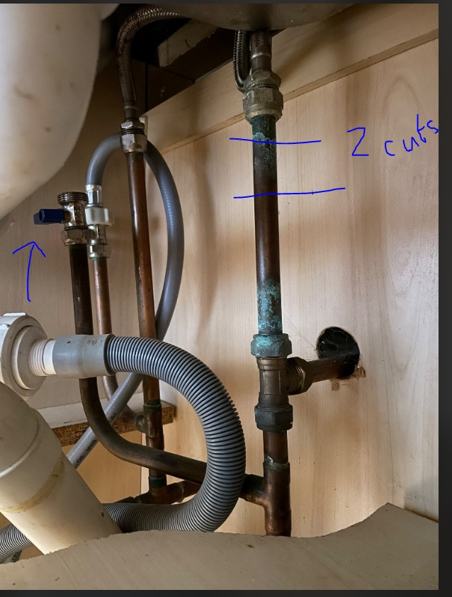

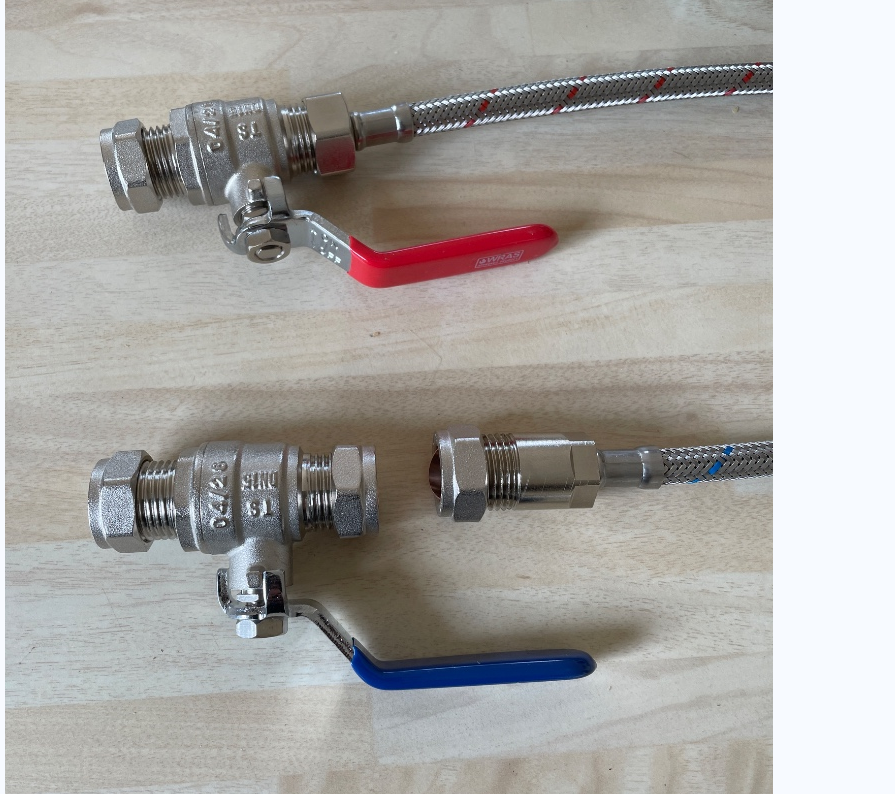

I notice my new flexi hoses are much longer so will it just be case of a bit more spiralling of the flexi hose or should I make my cuts on the copper pipes lower.
I was planning on these two cuts on the cold water pipe with the short piece of pipe to be used to connect from the cold isolation valve to the cold flexi hose (this has a check valve and a male ending so was planning on a compression joint here too)
If any of this sounds totally wrong please shout and rescue me from disaster

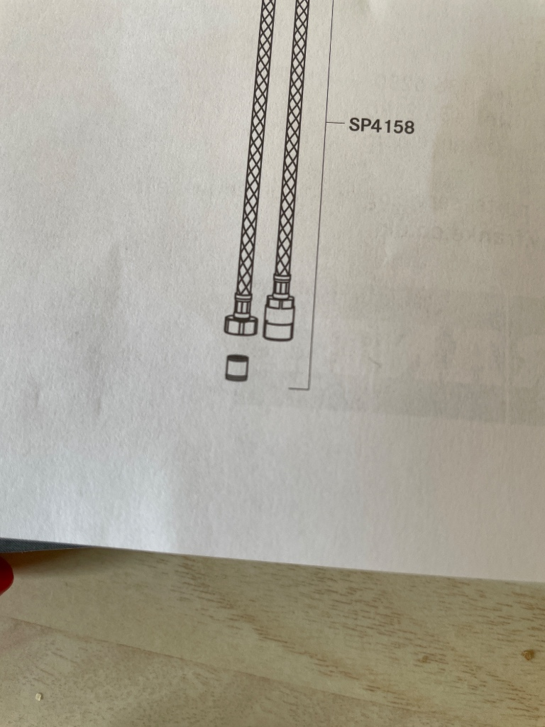

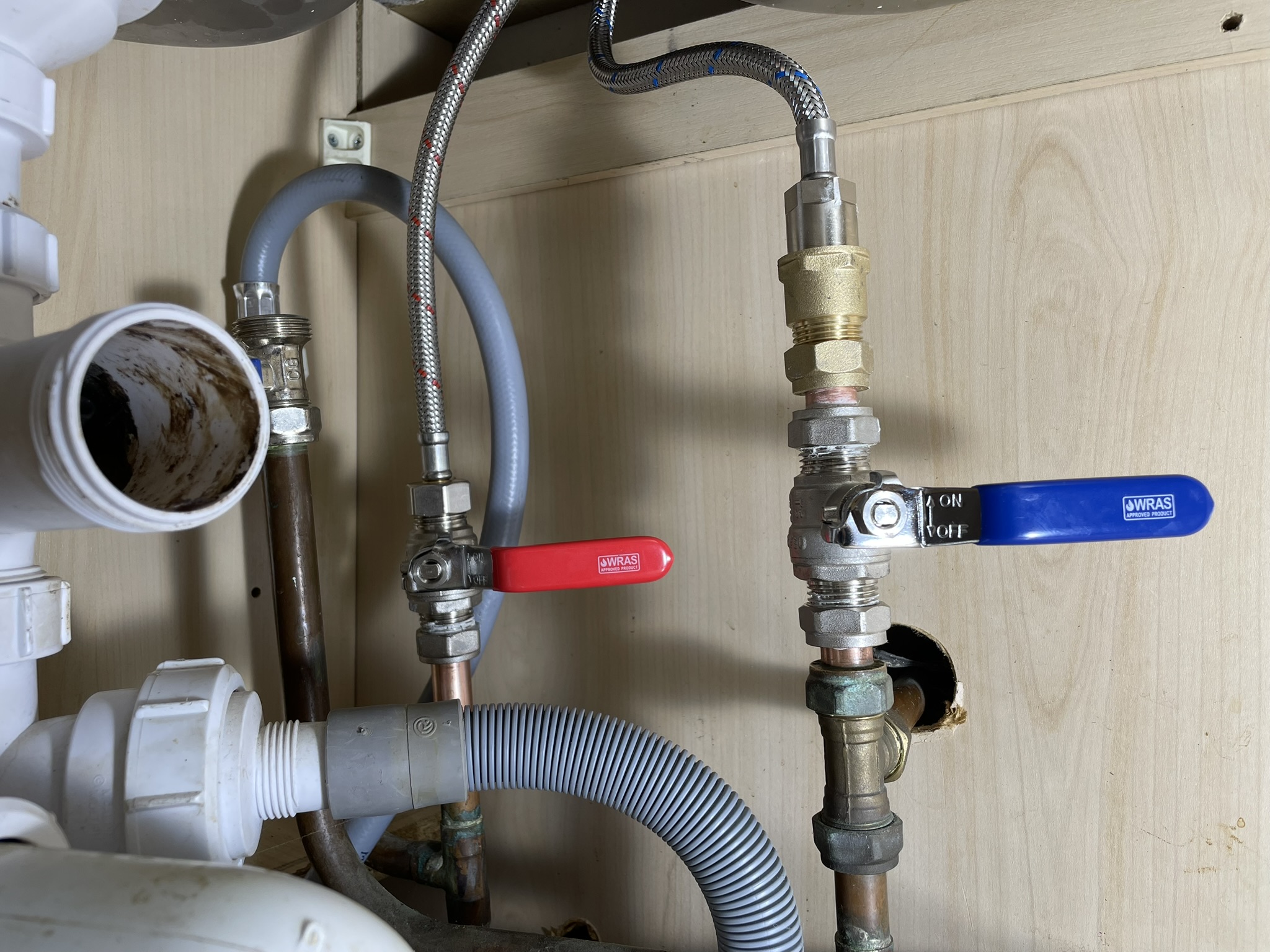

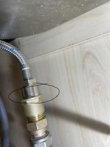

I did all the connections for the new tap. Where the cold flexi hose connects to the brass connector I initially got some weeping so I removed the tap and did this connection again with TPFE tape (approx 5 or 6 wraps) and I tightened it with 2 wrenches very tight. It is no longer weeping but feels a little damp on the back of the connection so much so that your finger feels a bit wet if you wipe your finger over it. I have put brown paper below to check for drops but I have seen no drips in 3 days. Is this likely condensation or could there still be a small leakage from this connection. Frustrating how Franke (tap manufavcturer) supplied tap with a different flexi hose fitting for the hot and cold. The hot flexihose had a rubber washer inside and there is no issue with it. If I was to take off the cold one and try and redo, I don't really know what I could do differently to deal with this. More TPFE tape? Some other thread sealant? Are these connections prone to some leakage? I had originally thought I could use a compression joint at the male end of the cold flexihose but a friend suggested that you cannot just add an olive and nut to any connection and it needed to be designed to take an olive hence why I bought the brass connector.
Your instinct with the finger test is right, and three days with no drips on the brown paper is a good sign. Dry the fitting off properly, then wrap a bit of tissue or kitchen roll tight around just that joint and check it after a few hours. Tissue will show up a tiny weep far faster than paper underneath will. If the tissue stays dry then call it condensation and stop disturbing it, because every time you break and remake a sealed joint you risk making it worse, not better.
Thank you for your reply. I will try as you suggest. It is frustrating that the 3 compression joints that I did are dry as a bone and this screw in connection is the one causing issues. Seems like Franke haven't thought this through very well and must be causing a lot of people headaches. Though I am not a plumber so it could all be down to my lack of experience.

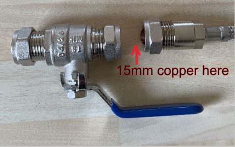

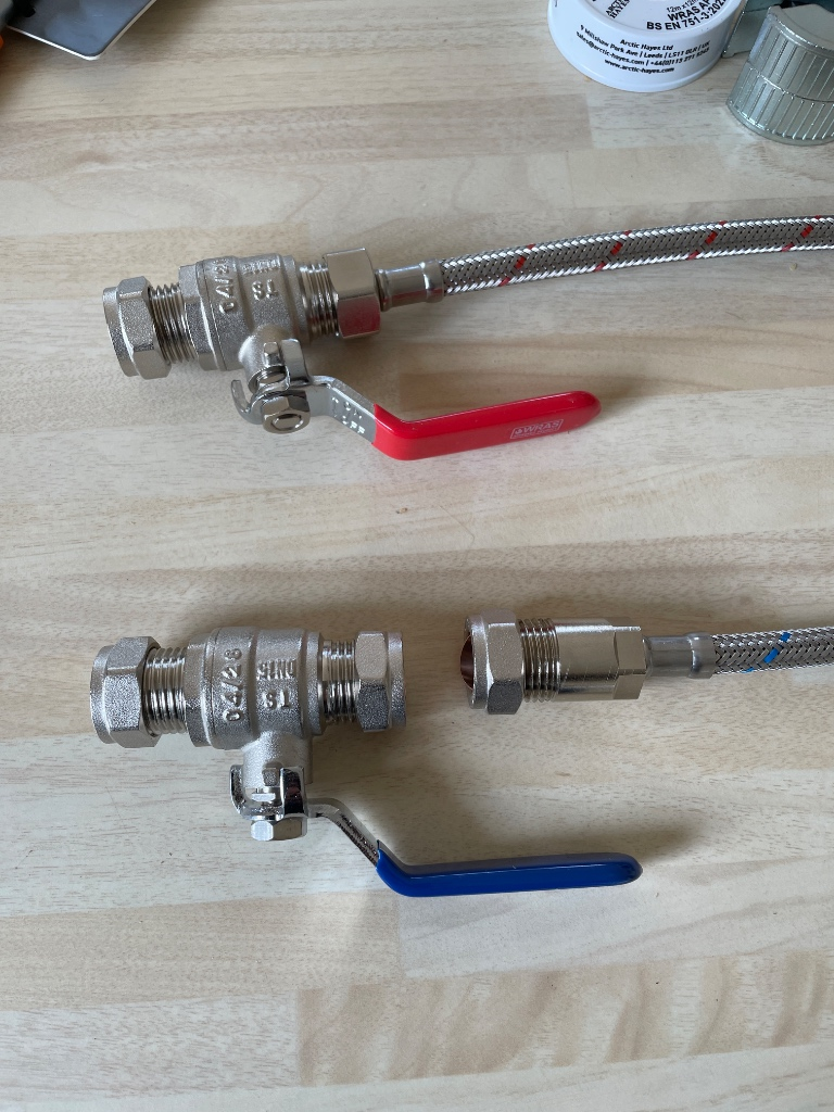

What was the need for the brass female x 15mm fitting ?
why did you not use a piece of copper between the flexi and valve ?
I did use a short piece of copper pipe between the isolation valve and the brass connector. I originally planned to connect the flexihose to this copper pipe using a compression joint but a friend told me (possibly he was wrong!) that I could not just make that male ending of the flexihose into a compression joint and that to do this the male ending should have been designed as a compression joint ending. I am very much a complete beginner so just assumed he was correct on this front. If that is not true, then I bet a compression joint would not have leaked so easily.
Note in this photo, I had taken the nut and olive off the end of the hot isolation valve and screwed it on to the male ending of the cold flexi hose
