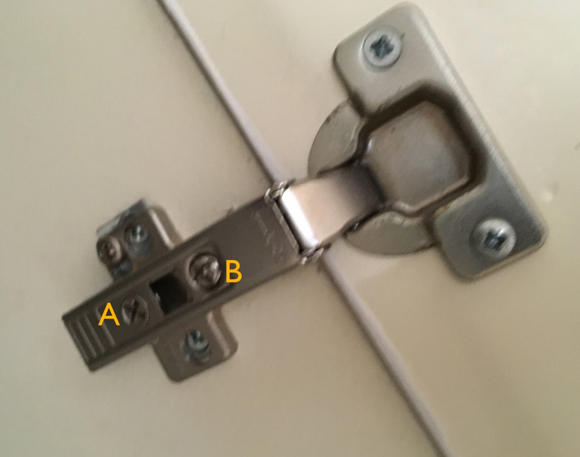

Sorry this is probably a daft question but I'm trying to get the door off the wall without taking the hinges from the door or the wall. I'm pretty certain I've seen the hinges slide apart previously.
Neither of the two main screws [ A and B ] seem to fully loosen and allow me to slide door off the wall?
Is there only way to undo the screws attaching the hinges to the door or the wall?

Does that brand name on the hinge say BLUM?
Try undoing the screw directly above the letter A in your picture, they do look slightly different to 'normal' cabinet hinges, because of that extra individual screw. Looks like it'll leave behind a small mounting plate with the 2 countersunk screws still in place.
Gaz :)
Also, check if they are the clip on type...
Gaz :)
Brilliant. Yes it's a Blum, and seems to flip off once those levers are released.
Thank you. I really appreciate it!
