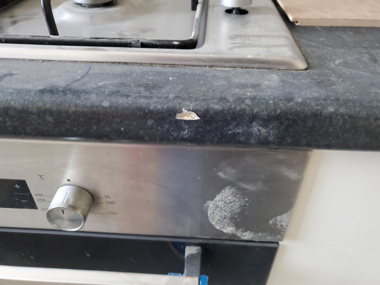

Hi everyone/the experts here
I have a small chip in a kitchen worktop - see photo. I'd be grateful for advice on how to repair - what products you'd recommend to use etc.
Rest of worktop is fine so seems silly to replace rather than repair
I think so long as it's something slightly darker it wont matter about replicating the slightly speckled pattern
thanks in anticipation
David
Needs a damn good clean!!! Yikes!!
yes whole room is being redecorated [new extractor fan done, floor tiles just been done, a new tap and painting to be done]. Any advice on the actual repair to chip please? [I know will need cleaning first]
You can add some black acrylic paint to a tiny bit of 2 pack filler.
Edit- pretty much what @foxhole said, the difference being that the filler will be black and won't need a touch up.
