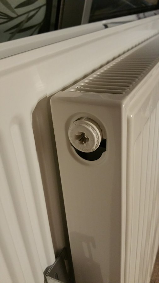

Am I the only one to have problems with these blasted radiators?
This is the second Kudox radiator I've fitted and the second to be returned due to the plastic plugs fitted at the factory. They've been fitted so tightly (and sprayt painted) that when I try to use the biggest screwdriver I have to unscrew them it simply mashes up the plastic and renders the plug useless. Another minor annoyance is the fiddly side guards on the rad. No surprise they are the cheapest rads on the Screwfix site.
The last occasion this happened I returned the radiator to Screwfix and even they couldn't get the plastic plugs off. Seriously Kudox time to redesign these silly plugs. Amazingly on the Screwfix site this rad has only 4/5 star ratings from supposedly happy customers. Barlo next time at least I can get the plugs off.

The plugs are throw away. Big screwdriver tapped with a hammer and they come out easily.

Do you mean tapped from the side/rim of the plug, worried about damaging the rad thread.
Is there a correct tool for removing these?

Punch the flat head driver through the plug and unscrew...or use pump pliers around the edge of plug and unscrew.

Hmm, you sure? Suppose could try this on one of them but isn't this likely to knock of a piece of the plug into the rad?

I've fitted two in the last week. As someone else has said, just stick a big screwdriver in the end, welt it a couple of times with a hammer (the screwdriver, not the rad :ROFLMAO: ) then twist. No problem :D
No it's not a wind up, and yes I know the answer seems obvious.
I'm just peeved that I now have to go out and buy a large bladed screwdriver just for these rads (nobody I know even has one of these). Why an earth couldn't they have used plugs like Barlo rads which are easy as pie to remove (after all who doesn't have an adjustable spanner in their toolkit).
I think with this one when they sprayed the rad paint has seeped into the threads hence it's more of a challenge. The last Kudox rad I had they came out with little effort, can't remember what I used to remove them. As I said in my previous post the guys at screwfix couldn't even remove them when I last had to take a Kudox rad back.
