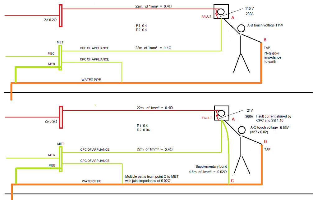

Perhaps this will persuade @equitum that SB makes a difference - and what a difference; it alters just about everything.
I think I have calculated it all correctly but if anyone sees an error please let me know.
I essentially agree with your calculations, other than, trivially, I make the fault current with SB about 362 A (rather than your 360 A), which alters the answer fractiionally.
Of course, the touch voltage without SB would be appreciably lower higher than 115 V if you had chosen any cable other than 1mm² and lower if the Ze had been appreciably above 0.2Ω.
Your diagrams an calculations serves to confirm what I wrote at the very start, in post #5 (of 173 :) ), when I wrote:
As you say, an RCD, if present, will hopefully limit the duration of any electric shock. However, what I've written above reminds me that nothing other than local supplementary bonding can prevent a shock occurring (during the period until a device clears the fault) ....
The question, which we have debated, is whether or not, when an RCD is present (and working correctly),one needs to be concerned about a high touch voltage which persist for only a couple of dozen milliseconds (and/or whether one trusts an RCD to clear the fault that quickly, if at all).

Of course, the touch voltage without SB would be appreciably lower than 115 V if you had chosen any cable other than 1mm²
Don't you mean higher?
and/or if the Ze had been appreciably above 0.2Ω.
I did, or should have! I will correct. Thanks for noticing!

Indeed. Without SB, in a TN-S installation, the touch voltage could be a lot lower than 115V and, of course,would probably be very low in a TT installation.
Yes, I was going to write something along the lines of: given the choice of either SB or RCD I might (now) choose the SB.
That's certainly a valid viewpoint. As I've been repeatedly saying, SB is the only way of avoiding significant shocks (even very brief ones, when RCDs are present)). SB is therefore the 'surest' approach and doesn't rely on an RCD working as it should - but, as I said, it all depends upon how concerned one is about very brief shocks and/or the fallibility of RCDs.
An alternative, of course, would be to change to TT. With a Ze of, say, 50Ω, touch voltages would probably struggle to 'get into double figures', even without SB :-)
