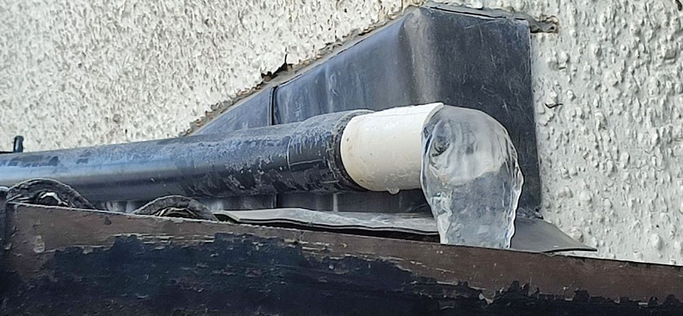

Lagging for an external condensate pipe
As suggested, exterior grade Armaflex will last a long time and would be a proper job, albeit isn't cheap.
I've been looking at Armaflex, and both Class 0 & 1 specs say they need to be painted or covered for UV protection.
I might just try getting the normal stuff again and painting it.
My boiler just dumped the water this morning at 6am. Twice its done it now and both times during a cold snap. I'm hoping its just the condensate pipe.
Our condense pipe is from a pump, going through the wall to a gutter that leads to foul waste.
I wrapped several layers of thermal wrap around it with aluminium tape, as its too awkward to fit standard pipe lagging. Took care to make sure the insulation meets the wall, and the tape blocks any ingress.
Looks funny, but has done the job at -3C with windchill. Cost £10 materials, with plenty leftover.
