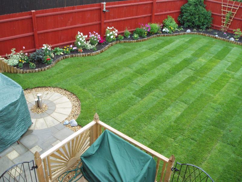

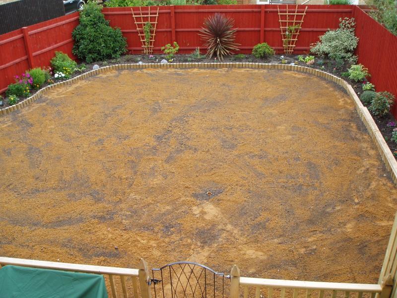

we did this garden which was on heavy blue clay. We put 3 pipe runs in across the garden, one at the bottom of the top slope, one in the middle and one at the bottom of the lawn, all connecting into a pipe at the edge of the lawn. Its as dry as a bone and works very well in the wet weather.
pipes going in before covering with shingle
pipes covered with shingle to existing ground level and then covered with sandy loam topsoil
the whole area at the end

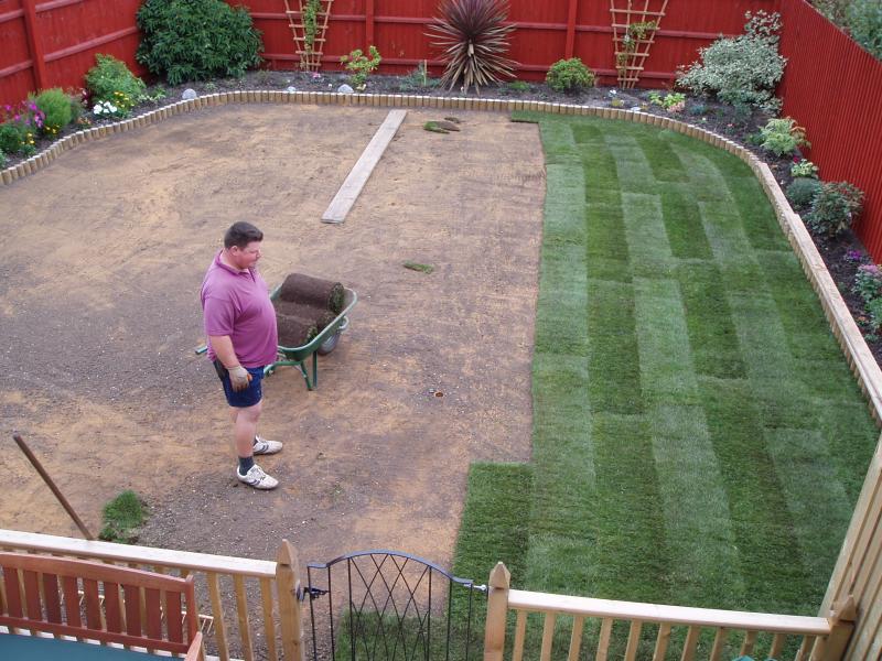

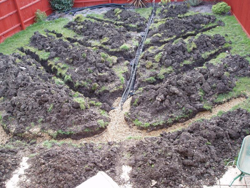

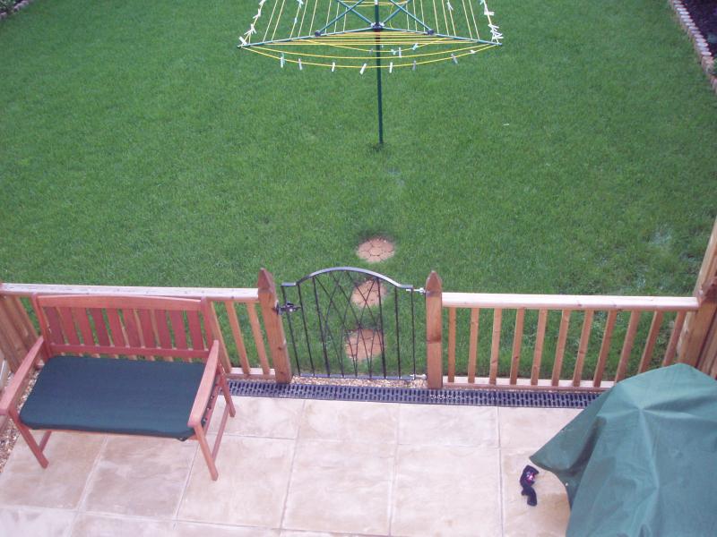

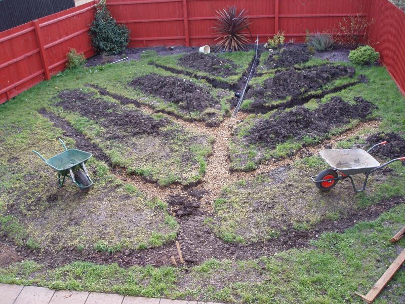

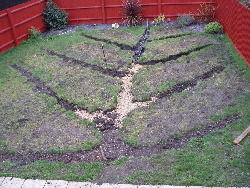

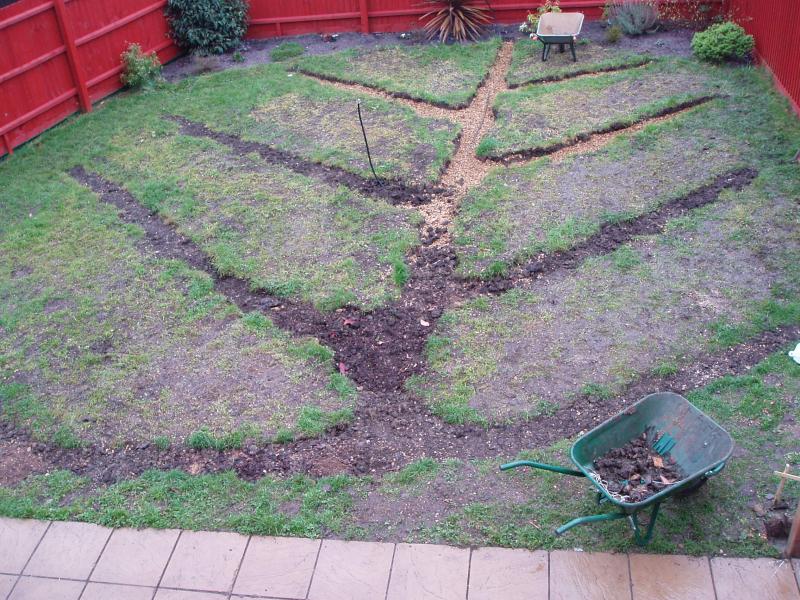

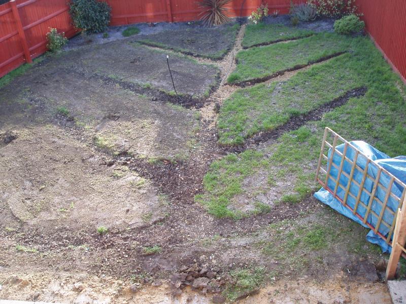

We had a nightmare when we first moved in with the lawn not draining, hired a mini digger (£110 for the w/e) and went for it, used land drain with geotextile wrapped round it.
Set the fall for the nearest surface water manhole, works a treat, only problem is that in summer the area of pipes dries faster than everywhere else so you have a nice feight outline on the lawn of the location of the pipes.
I quite like that really as it shows where all the hard graft went!!
Good luck

you wont get much, as the gravel will act as a filter medium. I prefer not to use the geotextile as it can clog over time.
The soil was heavy clay, every mini bucket load had to be crowbared out from the scoop, nightmare.
In hind sight bearing in mind what Thermo has said, I would not use the geotextile, I've never done anything like this before so thoght I was being clever :oops:

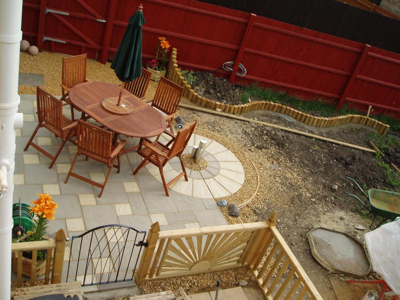

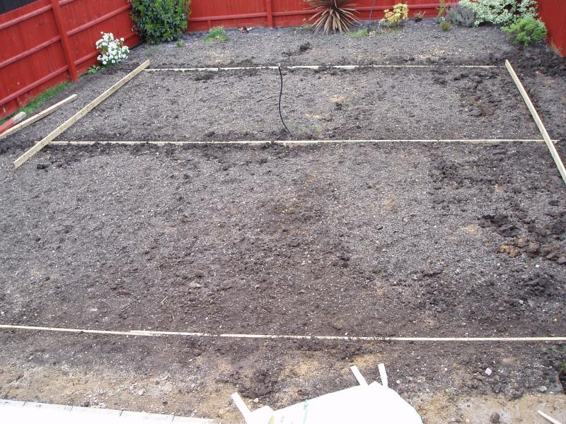

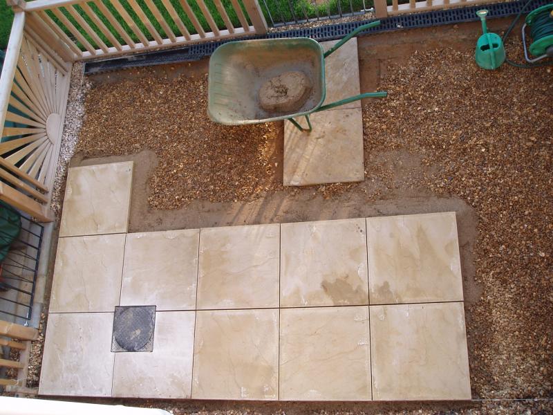

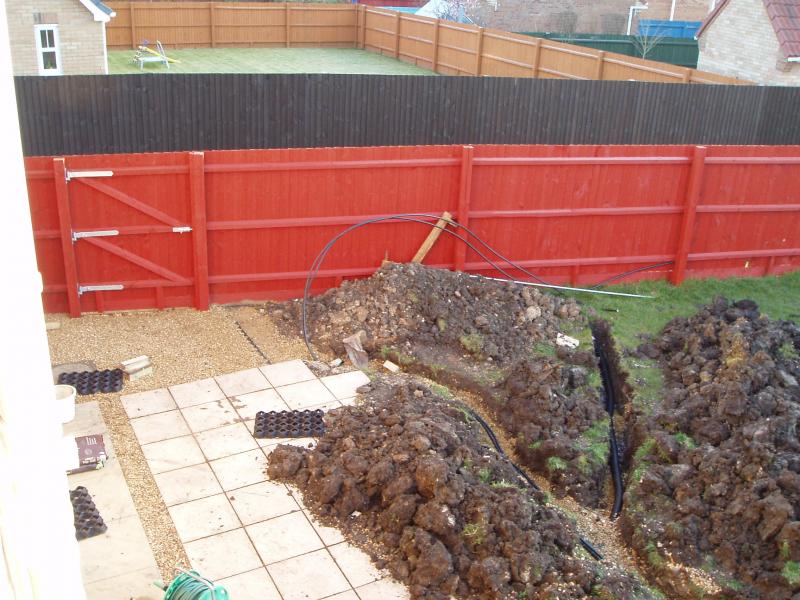

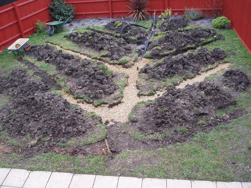

The inspection pit had a spare blanked inlet, dug down to expose the outside of it, used a peice of pipe into the chamber and threaded the perforated pipe through it to make a seal with the chamber.
I do have a couple more pics somewhere if you wanted to see.

Well you did ask for it/
Cheers for them mate, its like a step by step guide :D cant wait to get in the digger now!!!!!
