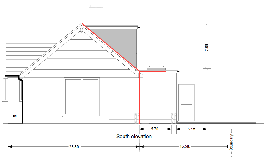

Attached is a drawing of what I am proposing. The second and third elevations detail the proposed rear dormer in grey.
The dormer will be clad with clay tiles to match as closely as possible the colour of the main roof grey double roman tiles.
The fourth elevation shows in concept the rear dormer with a rear ground floor extension that has a pitched roof. I believe that if the rear ground floor extension roof abuts the dormer then its volume counts toward the total permitted roof enlargement of the main roof under PD. The rear extension roof is pitched so that its volume along with that of the dormer works out to be about 49.5m3. The side walls of the rear extension are to be flush with the existing side walls of the bungalow. The flat roof is drawn without a fall as I'm not sure what fall I should put on it but what ever it is it will reduce the overall dormer volume albeit only slightly. Any suggestions as to the fall for the dormer roof?
The roof overhang of dormer does not quite extend beyond the existing rear wall of the bungalow but it is very close. The intention is to remove the existing rear wall of the bungalow once the rear extension is built, which is partly why the rear wall for the dormer is where it is i.e. so that it can sit on the steel fitted in place of the removed rear wall.

I've redone part of my drawing (bottom elevation only) to show a flat roof extension with the dormer set back over the inner leaf of the existing bungalow rear wall. The extension roof is drawn at 200mm depth which decouples the extension roof and dormer wall by about 50mm.
However, the flat roof will still abut the main roof by 200mm. Would this mean that the volume of the extension flat roof would still be part of the permitted enlargement of the main roof (part of the 50m3)? If so, the volume of the dormer is now a little under 40m3 with the extension flat roof volume being a little under 5m3.

It still won't comply.
Broadly a roof extension has to be above the original roof, and a rear extension has to be below the roof, and they cannot touch. You cannot have a hybrid as you cannot extend a roof extension backwards beyond the wall below.
The top surface of the flat roof to the rear extension has to be below the "eaves". (For a pitched roof the "eaves" is considered to be the lowest point on the roof where the wall would meet the roof pitch if no overhang existed). At the moment it is still shown higher. I've sketched the limit of what would be allowed. (refer Class A,A.1,d - pages 11-12 PD technical guidance)
Of course lowering the extension would then mean the dormer wouldn't meet even if it then sat above the wall below. However, there is another rule requiring 20cm of eaves to exist below the dormer. (refer Class B,B.2,b,i,bb - pages 36-37 PD technical guidance). There is some case law on this point which the technical guidance explains as: "This 0.2m set back will be required unless it can be demonstrated that this is not possible due to practical or structural considerations." I however have not seen any examples where someone has done this with an LDC for a dormer and rear extension (although people have built them but whether they comply or not is a different matter). The main case law example that permits breaking this rule is when extending over an original house and outrigger which different roof heights (and thus wrapping over the eaves where the eaves on the taller part continue over the lower part of the original house). So whether you maintain 20cm or not will be a judgement call and perhaps discussion with your Local Authority.

For the purpose of understanding the PD criteria for roof height, existing eaves, overall height, volume, connecting roofs etc correctly, I've also redrawn the side elevation showing the rear extension. Is this proposal likely to meet the PD criteria?
The eaves gap between the face of the dormer and the top of the extension roof is about 230mm, which I realise doesn't leave much for measurement and drawing error and in practice may end up being less. If I maintain floor and ceiling heights throughout there is about 120mm for the ceiling and roof depth. Are there insulation materials available that would suit such a shallow roof depth?
