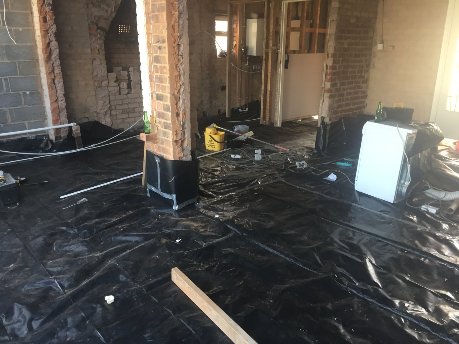

Maybe you could screw 50 x 50 level all round 150 up , then get some strips of 12mm ply screw on so bottom edge is say 10mm above finish. Raking the concrete around, it will be possible to get level all around perimeter. Doing that, gives you a datum around perimeter that would otherwise be hidden by dpm
The middle wont be far out. If you are concerned make a tamp board 150 × 50 with a bit timber screwed on top and over hanging end -forms notch to sit over wall batten -but you can only use diaginally since its fixed length. Or check level with laser and mark on wood.

When screwing 50 x 50 om, make sure there is some fullness in dpm, so it doesnt get stretched down when concrete goes on.
Your right notch this is oversite with insulation to go on top and then a self level screed later on. It’s an awkward space to screw on battons around perimeter due to odd features (see pic) although not impossible.
Don’t worry, the washing machine and dryer will be moved out before I start.
Around the corner from the pic I’ve got the stairs terminating which are currently floating in mid air, another awkward feature to work round. Had this been a simple rectangle or just a slab inside the new extension it would have been much more straight forward

youdid well to stop mate - your photo shows a few things that would have caused you problems.
heres how we do interior slabs -
harcore/firm soil
blindin sand on hardcore
membrane
insulation - taped sheets
edge insulation
some put a membrane on top of insulation as well - i dont
concrete slab.
lot of other stuff to take into account but thats the bones for how we do it.

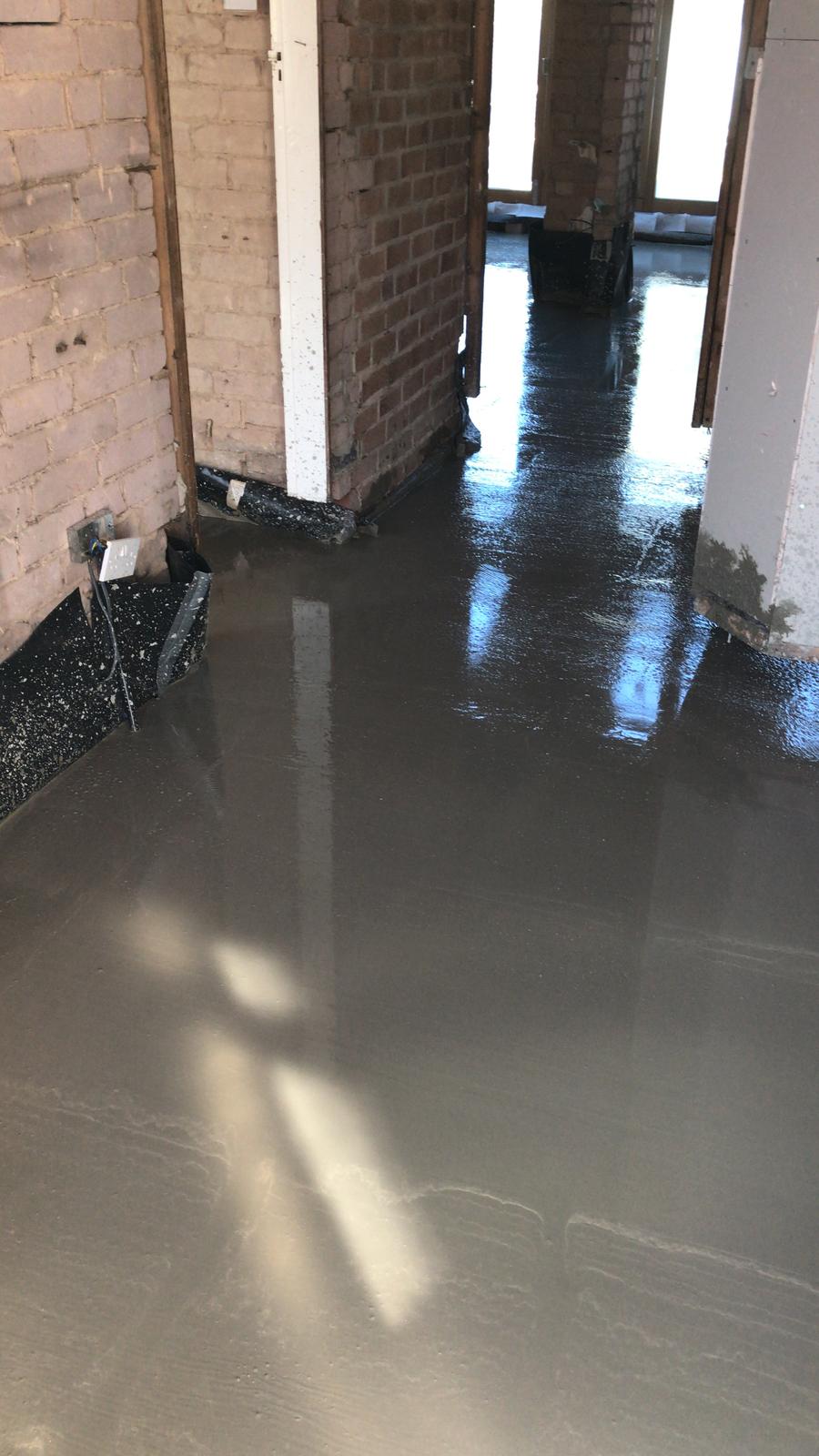

Well I never used the barrow guys in the end. Had a call back from another company who pump it in and they said they offer a laying service too. No messing around with battons. Cost me extra but they’ve done a decent job in my opinion

Haha yes. What was even better is I wasn’t at home when it was done. Nice to come home and see progress - if I had the money I’d have trades do the lot - mind you, where’s the fun in that
