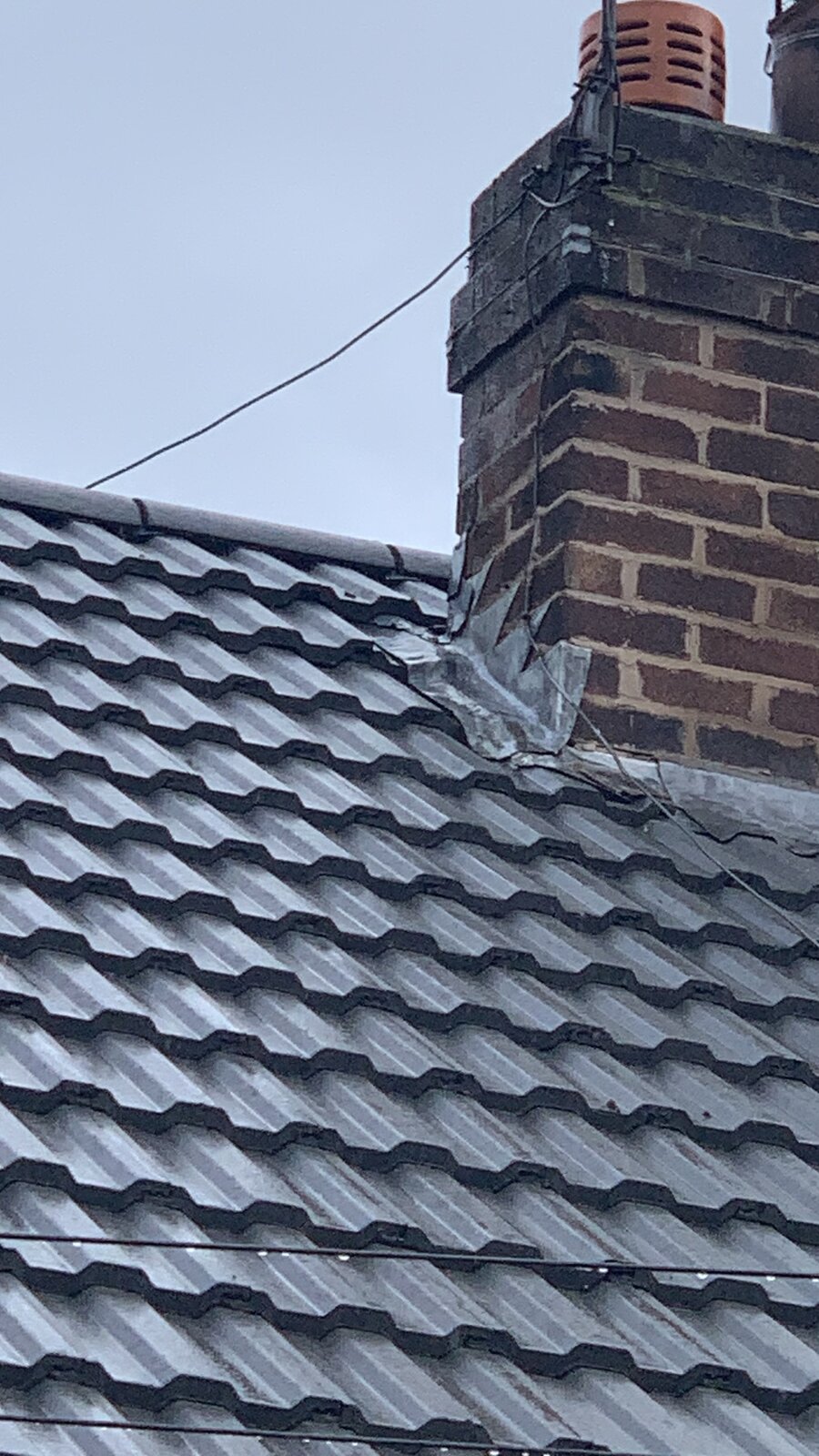

I just spent £6500 on a new roof. I had quotes for £4500 but I decided to go with this more expensive roofer and he added the vat as he did some great work on some gutter work and fascia.
Now he said that he was going to do the flashings in the chimney but now after finishing he said is not worthy coming back to do this unless I give him another job to make it worth while. Shouldn’t the flashings being part of the reroof?
Am I asking too much but paying an extra £1000 would you not expect that he will do the lead flashings also rather than banging the old flashings back ?
What do you think?
The invoice actually does not say anything about the flashings on the chimney but i thought that is pretty standard.
It is a very small chimney on a bungalow.
This is the invoice,

Flashing is not standard.
Not only is it optional, but there are options for lead or lead replacement along with flashing and gutters and aprons, so unless it's itemised or specified, it's not included.

Oh well he just sent me a new quote now for flashing:
£480 with patination seal and lead seal he wrote...

You could ask , does that include , front apron , back gutter, and the step flashings .

Haha, funnily enough I bargained it down to £300 for the flashing! He is coming back next week!!
£300 for lead flashing on a chimney is very cheap.
Clarify that he will use new lead, not the one already there or some that he removed from another job.
To do it properly it takes at least half a day; access, removal of old one, slots in mortar, cutting, bending, dressing, repoint cleaning up and patination oil.
£300 sounds cheap considering he will need £150 for lead.
