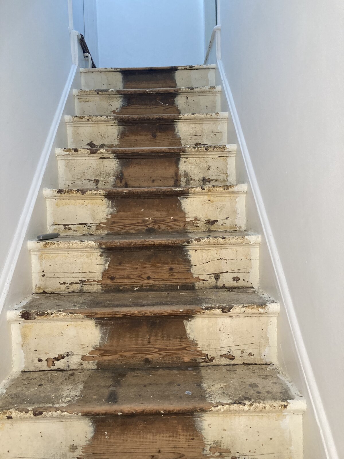

Hello,
We want to sand and varnish our stairs but are worried about lead paint (1900 terraced house in London).
We have done around 8 of the swab tests and one has come back positive.
What is the easiest and safest DIY option? All roads seem to be pointing to Peelaway 1.
Wife is pregnant so don’t want to be taking any chances.
Nathan

3 options are
Cover wood.
Replace wood.
Chemical strip wood.
Peelaway is best bet. Get some and try it
I don’t know if my paint was lead based but I did my stairs (mid 50’s)
I used paint stripper as well.
just allow it to work. Far too many people whack it on and expect instant reaction.
Peel Away is a great product but I think you are over estimating how well it will work on the stairs. With respect, I think you are massively under estimating the work required to get them up to a decent standard. The risers are a bit of mess.
If I had to quote for that, I would be looking at in excess of 6 days of labour, seriously. And that is me having access to thousands of pounds worth of sanders.
On the upside, it looks like they haven't been painted very many times.
Options, other than @Wayners recommendations, would be tidy up the sides and fit a new runner carpet. The runner will also be more quiet when walking up and down, and when your little person first starts using the stairs, it they slip, the runner be be much less painful.
I'd not want to strip that as a job but home owners seem to have the time.
Think I'd replace it all with hardwood given the options. Might not be what you want though

Thank you.
It is an option we are starting to consider based on the condition, the lead paint etc.
Can the sides be tidied up without sanding?
Maybe look at covering
Something like...
Oak string covers designed to cover over existing stair strings and can be easily over-laid.
Thank you.
Nah, sorry, the sides of the treads and risers would need sanding and filling before repainting.
I think you might be worrying more than you need to, but I completely understand your concerns.
BTW, the H&SE say that heat guns on lead paint are safe so long as the temperature doesn't exceed 550 degrees C, but I guess that you don't have a heatgun with adjustable output.
