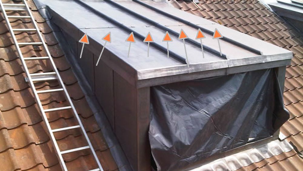

We have a dormer roof with horizontal seam that has the hangers (folded over bits of lead) that hold the top section in place.
The roof look like it shouldn't leak nevertheless we have got water coming through the horizontal seam.
We masticed the seam together but still had some water coming through, at odd intervals like it was pooling then leaking.
Then we went back up and also masticed the small 1" hangers - then the roof was water tight.
Now I am thinking the hangers were causing the leak the whole time.
Anyone with similar experience ?
The hangers face the direction of flow of the water ?
Is it possible to weld on a hood over the hangers so they are out of the path of water ?
(Attached photo just indicates what I mean by hangers if it's not clear.)
Lead clips;) Nicely done rolls there. The top and bottom sheet are just lapped ( though in the picture there may be an ant-capillary groove in the bottom sheet-hidden ) Does your roof have the rolls too.

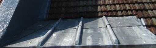

The one in the picture is half decent apart from the laps. If anything the clips should help prevent capillary. Any pictures of yours?
It's not a great photo but here is one. Has a lot of mastic on it now though, this was before.

you do not need to throw it away.burning hoods over the clips is easy enough but I honestly doubt it will be the problem/solver.
pitch, and lap joint is the problem. Any idea how much lap each bay has?
Dimensions are Length = 192 cm, drop 43cm, I make that about 14 degrees
Lap is 8"
Width of clips/hangers is 2"
I wonder if it's possible to insert a 60cm strip of lead creating 2 new 12" laps, possibly welding it to one side.
Or insderting a step, by removing top sheet, screwing new board to top half, then replacing top sheet, and possibly welding on middle bit to form the step.
Otherwise throwing away a new roof and starting again is £1800.
The angle looks less than 14.. I make it around 12.. looks less.
I would be inclined to insert a step.
