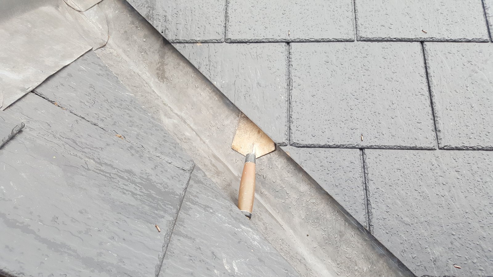

Hello,
The pic shows valley installation to a recent re-roof. From all YouTube vids lead valleys are installed with lead welts.
I am confused why it has not been done here.
Is it still the norm to do lead welts or not ?
Any other thoughts on this lead valley install ?

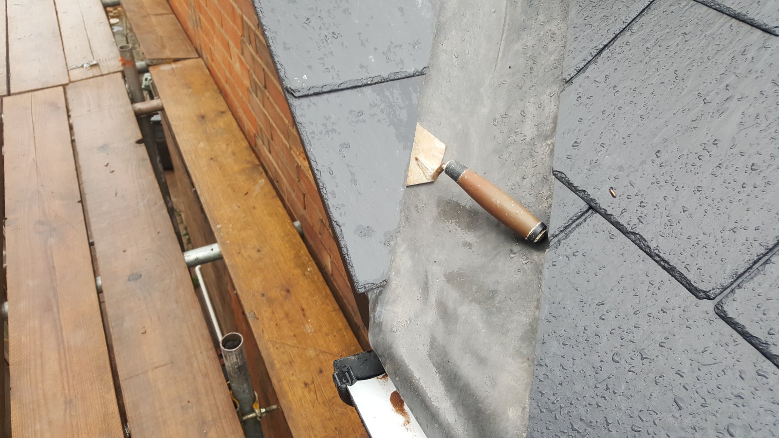

Hi catlad,
When I was up there I just wanted to check. Using a bucket trowel it did not hit any welts.
Plus, a few days later I asked one of the guys and he told me no lead welts.

From what I can see in your instance, I wouldn't worry about your valley being welted.

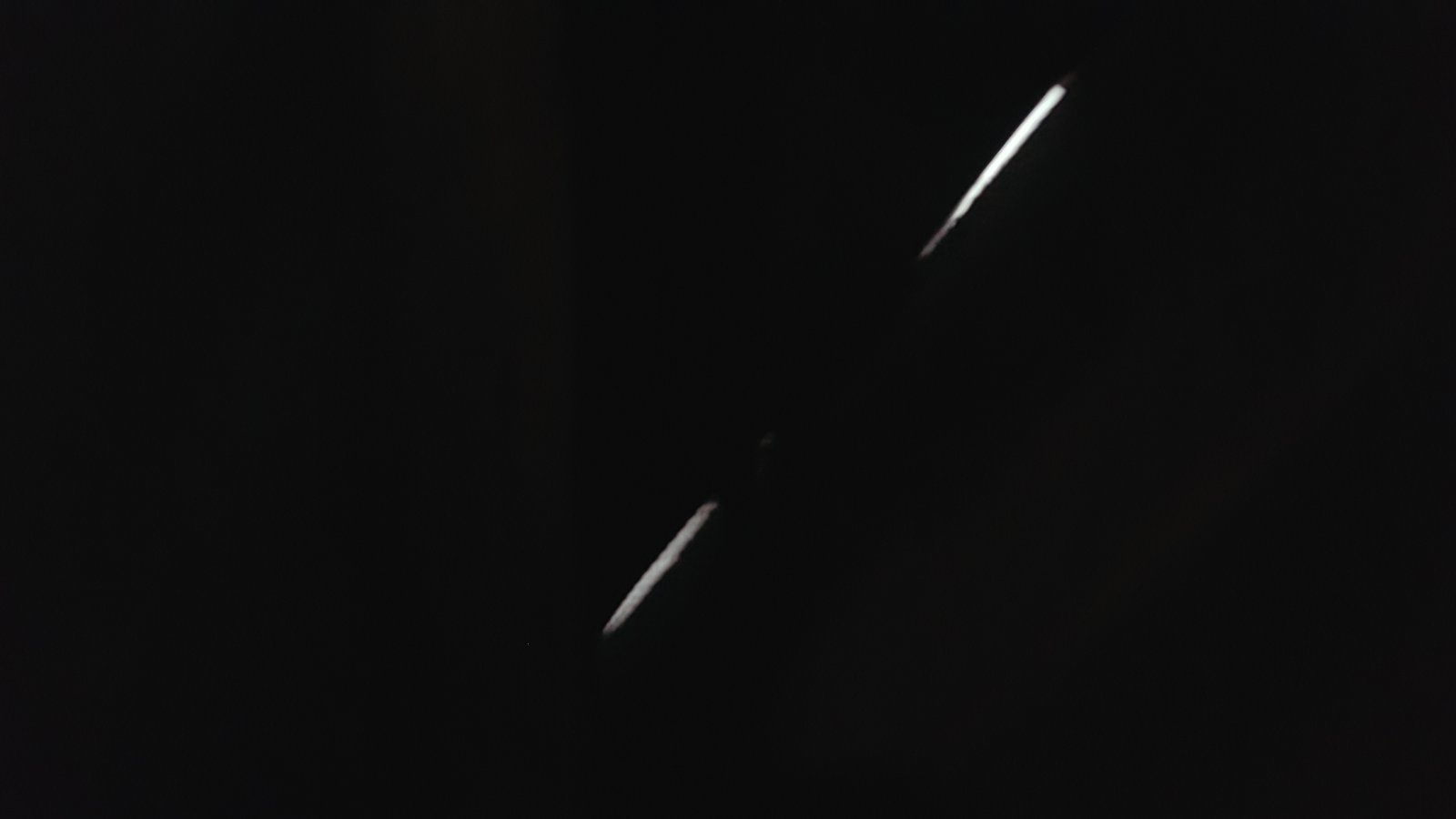

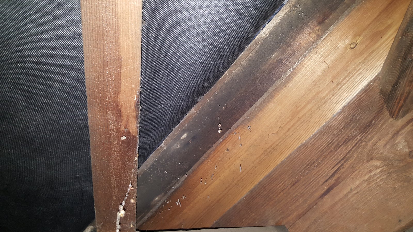

Ok thanks. One more thing; pre re-roof with no membrane, I could not see daylight by the valley. I now can see daylight running all way down following the length of the valley board.
Is this normal or not?

Not necessarily, what was on before?
Natural slate roof, lead valleys NO membrane of any kind.
No leaks so far.
Just wondering what will happen when snow settles/freezes on the roof and then later thaws out, will it then leak into the roof where the daylight can been seen now.
You are not seeing directly out,
No.
When loft lights are switched off, I can see daylight which follows the edge of the valley board.
So with new lead and fresh non-permeable membrane I expected the roof pitches to be blacked out.

... pre re-roof with no membrane, I could NOT see daylight by the valley.
So I was trying to find out. if you consider that the roofers have done membrane/lead valley correctly.
I would have thought that having a membrane below the tiles/lead valley would provide an additional safety factor, just in case any water leaks in.
